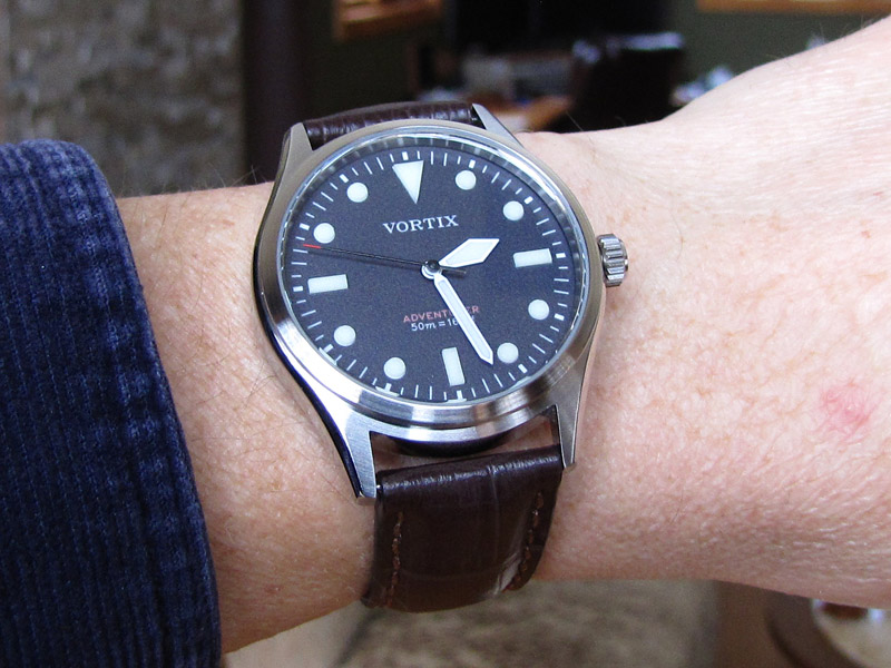

In addition to repairing a few watches (Sekonda alarm and Poljot chrono), I've taken an interested in modding watches too. So far I've made an Omega X-33 homage (out of a Pulsar), a Tudor Black Bay homage (out of an Invicta), and now my latest, an homage to both the Rolex Milsub and Rolex Explorer built from an Orient Chicane. I call it the Adventurer, and have been wearing it since I completed it on Sunday.
I first put it on a brown RIOS alligator pattern strap I had on hand. This looked good on the original Chicane with its burgundy dial, but not so good on the Adventurer. I'm considering sourcing a black strap for it, either alligator patterned or smooth.
Next I transferred it to the stock folded-link Orient bracelet, which I had brushed to get rid of the shiny narrow parts of the links. Looks okay, but a bit busy, and the bracelet is terrible.
Here's a close-up of the dial. Unlike my Black Bay homage, which used a pre-made dial, this dial is completely home-made.
One of my goals with this watch was to make it easily legible both day and night, even to my 50 year old eyes without my reading glasses on. As such, it has very high contrast, and killer lume (on the indices - I wanted to get better hands for it).
The dial is patterned directly after that of a Rolex Submariner, but because this 39mm Explorer-style watch case has such a thin bezel, the dial is much bigger (and thus easier to see) than the one on a 40mm Sub.

Hey that looks great. I don't think the folded link bracelet looks busy...no. It looks good because the curved end links give it a clean integrated look--and I am always biased towards leather straps on watches. Have you tried a leather NATO style strap with the stainless steel keepers? I bet a grey one or standard black leather would look very good. Also, I must know how you did that dial--don't keep us in suspense, give up the info bro! I love those sugar-cube style markers. They are made entirely of lume, yes? There is only one thing I don't like and that is the sweep second hand. It would have looked devastating with an arrow tip sweeper with either a red tip (as you have now) or a lumed outline for the center. Gorgeous job!

I plan to write up an article about the dial making process, probably next week while I'm traveling. In the mean time, here's a quick summary of the process:
- remove dial from watch
- remove indices, date frame, and other applied bits
- fill date hole with steel-filled epoxy
- make a block with holes for the dial feet and a tube to fit the centre hole
- sand off the existing lacquer
- design new dial
- write a program to accurately generate the dial artwork at 1200dpi
- print many copies on a 1200dpi inkjet printer on the very best photo paper
- spray with gloss acrylic lacquer
- choose one that turned out okay
- cut it out with a circle cutter (compass with a knife blade)
- laminate it to the now blank dial with a very thin coat of epoxy
- sand and polish out the imperfections
- apply more lacquer to seal the edges
- sand and polish some more
- apply 14 coats of lume paint to a white adhesive backed label
- sand to a uniform height
- punch out round indices and cut out the other indices
- apply to dial
- apply a somewhat wet coat of lacquer to seal the indices to the dial
- apply many mist coats of matte acrylic lacquer to achieve desired finish
- modify movement spacer ring to bring movement closer to back of dial by the same amount that the photo paper increased the thickness
- reassemble watch
