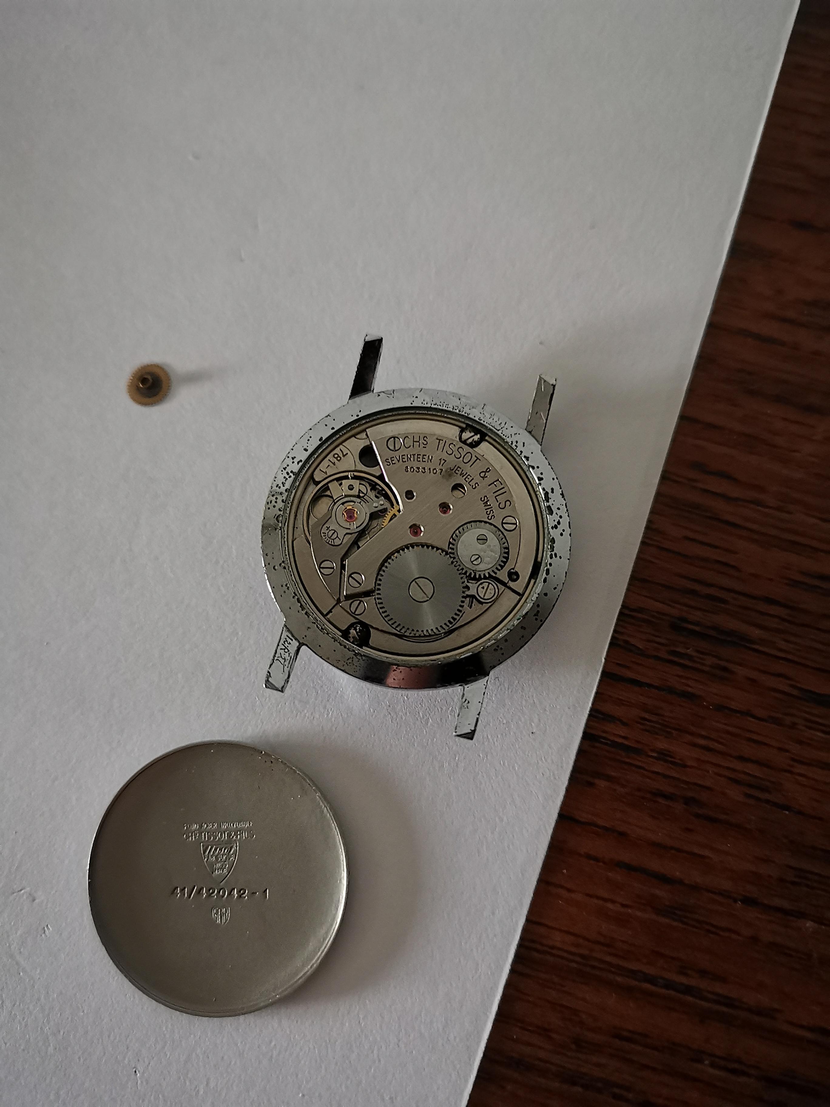

Hi guys am new on here so please be gentle

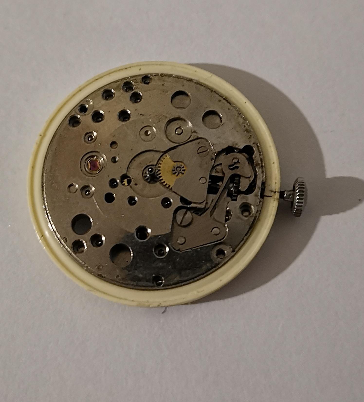

I got this Tissot and the stem was loose so I managed to figure out how to open it from the front and disassemble it but can't figure out how to click the stem in.
It goes in and winds the watch but I can figure out how to make it stay

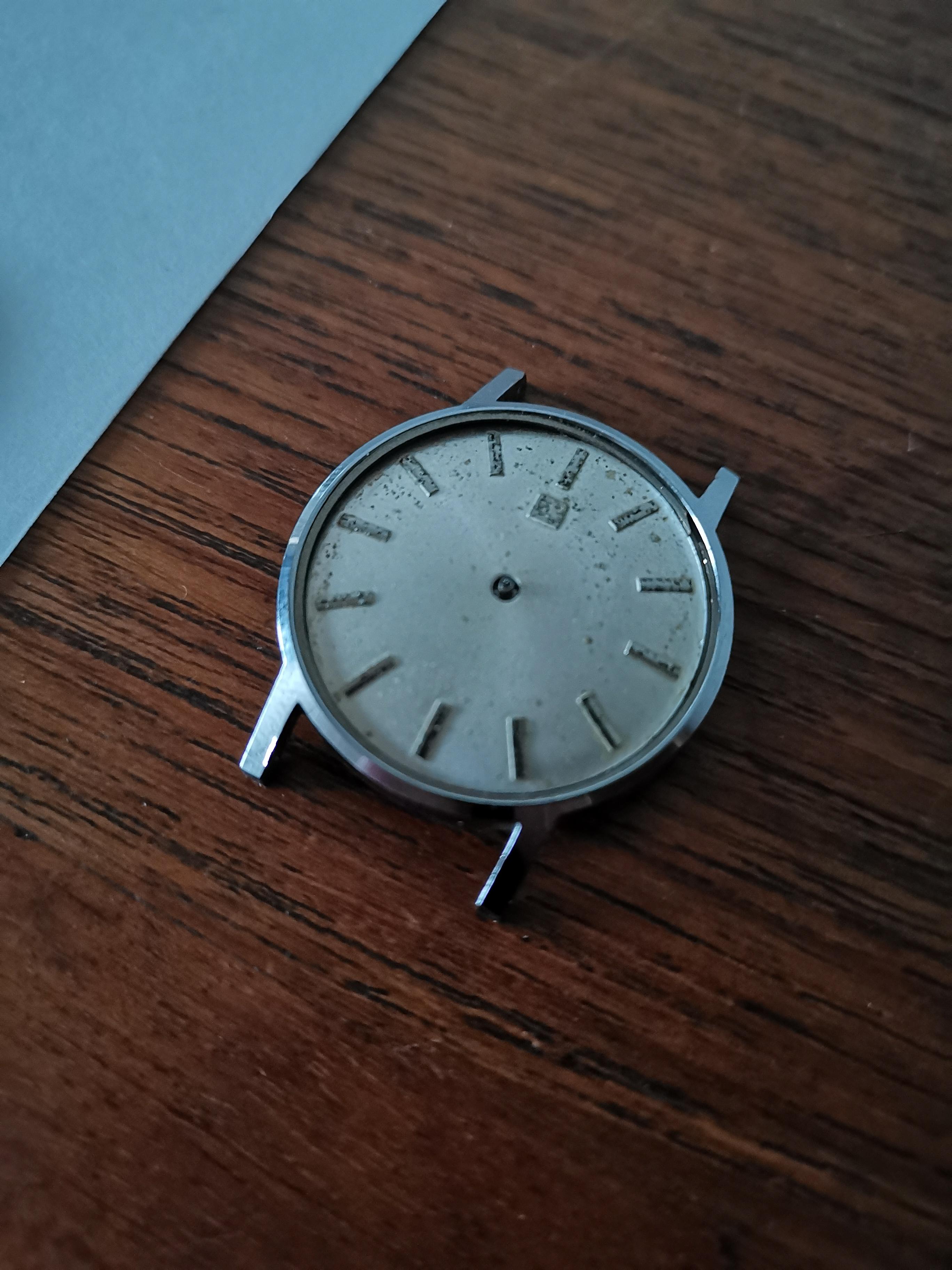

Also the dial was quite green so I washed it and it turned out OK it only had the tis out of the Tissot so not botherd about that rubbing off

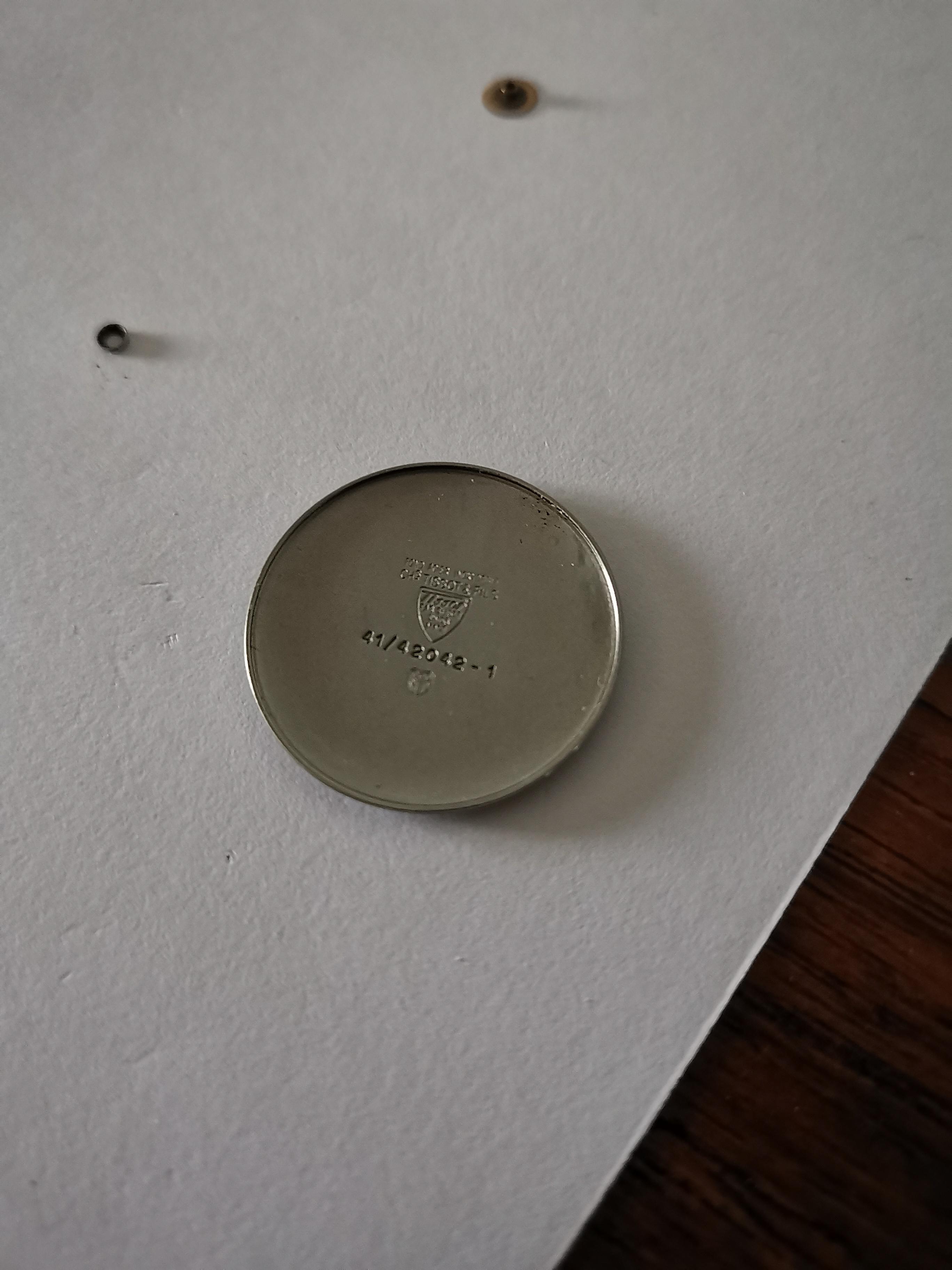

Also it would be nice to know what model it is, when it was made, and what strap if possible
Cheers for any help
Hi J and welcome. Have you done a search on the numbers? They usually turn something up. The short number is often a movement, though could be a date. I’m also new to all this so somebody will be along with exactly what they mean.
Hi J   tye in tissot 78-1- into google  and look at the sit Dr ranfft or call up the site ( dr Ranfft tissot 781-1) and have a look It gives all the spec on there.  I will have a look on my data bases for more info
Just looking at the dial, case and movement he should google for a Tissot Seastar with 781-1 movement.

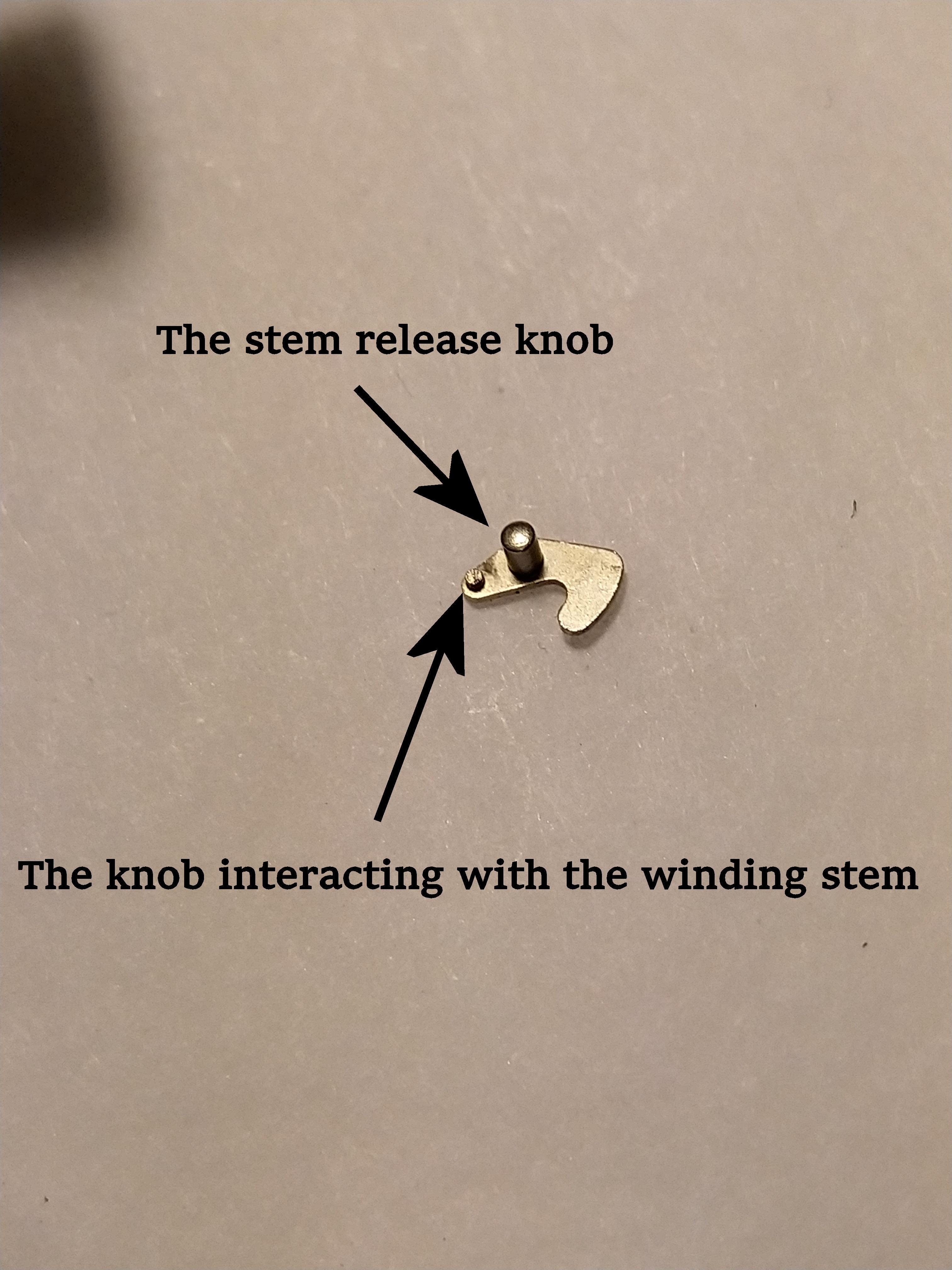

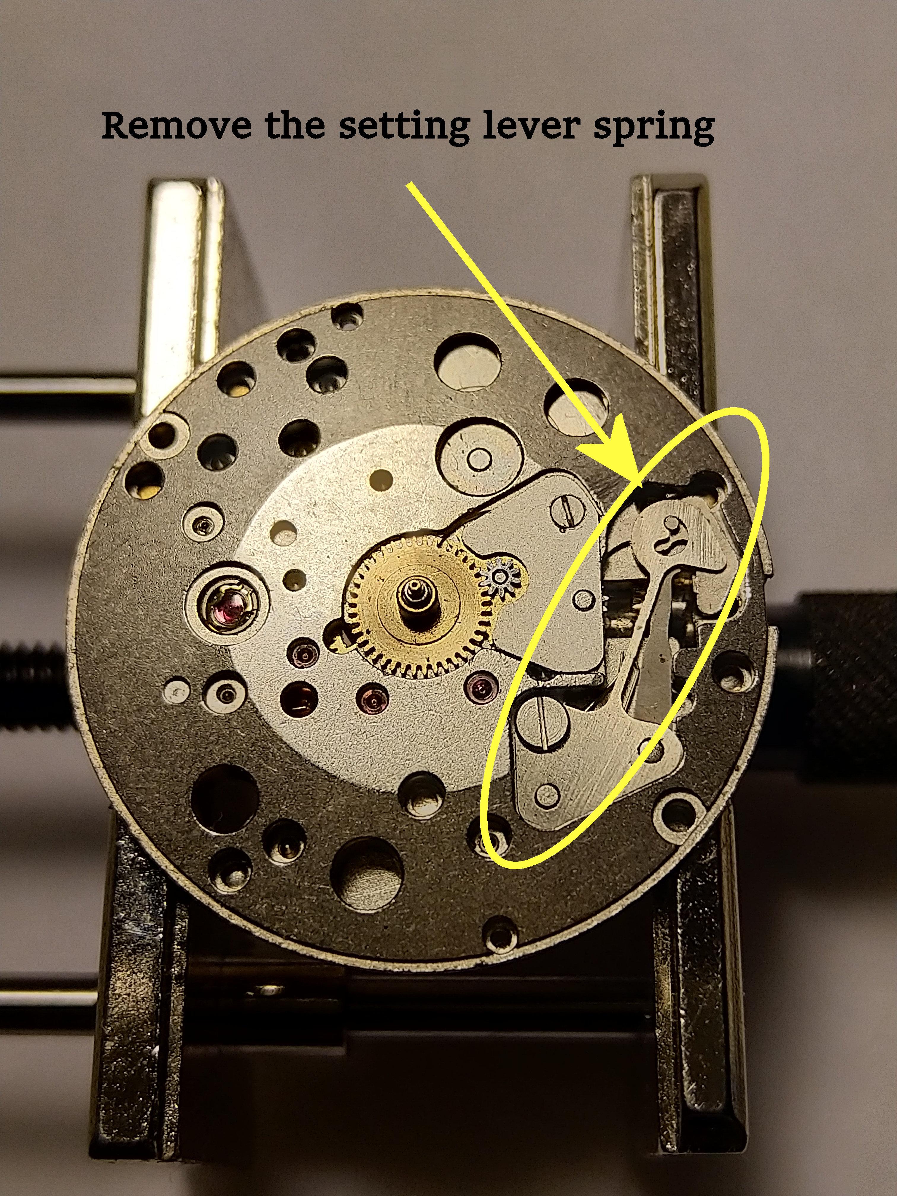

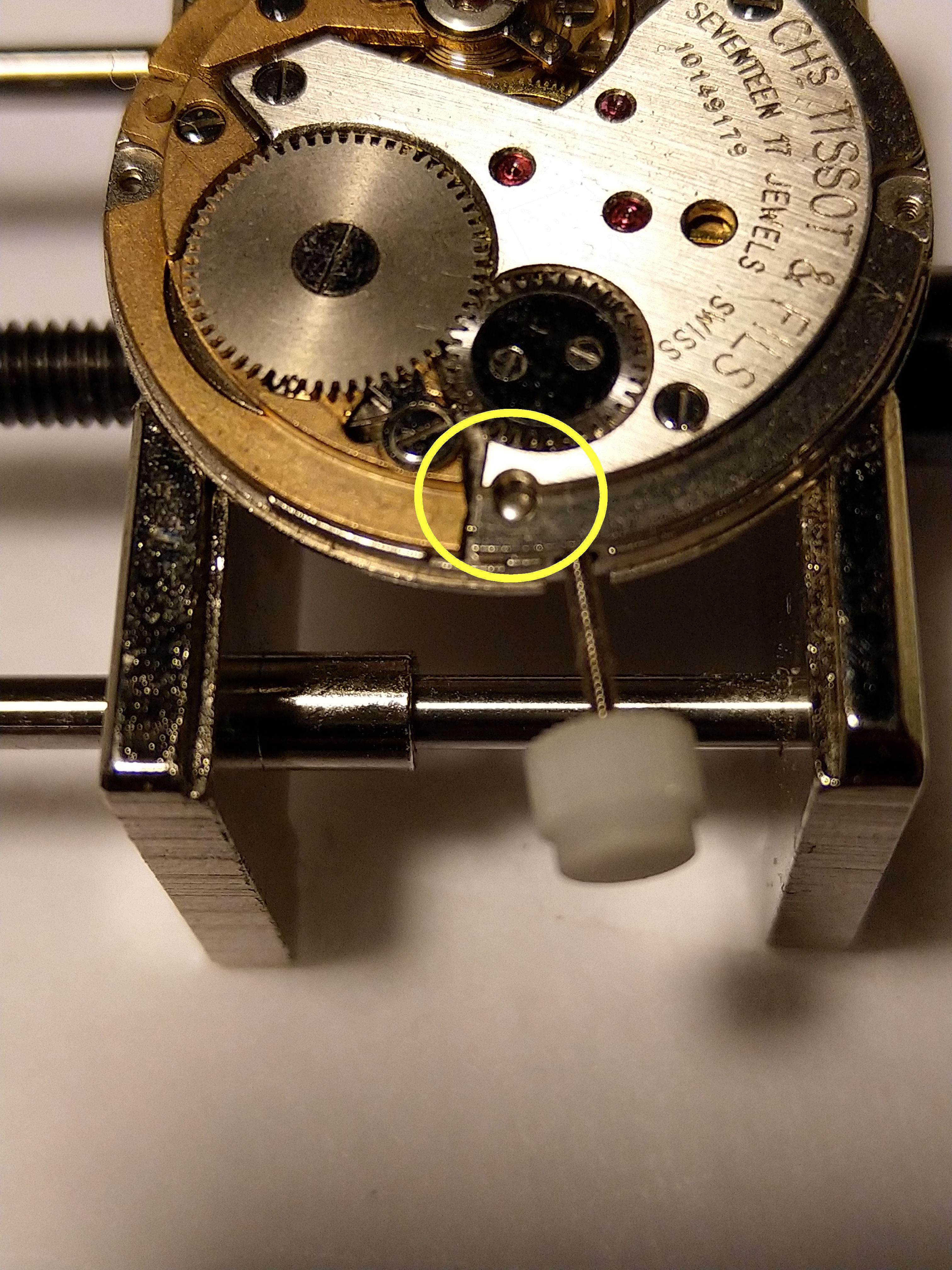

.. almost forgott.. To correctly put the stem in one gently has to push the button in the marked place in the picture, whilst gently pushing it you rotate the stem. It would snap in without an effort.
If you push to hard the lever gets out of alignment and you have to make some service on the key less work....
The more I think about it you might as well check the key less work. On a 781-1 it's quite basic.

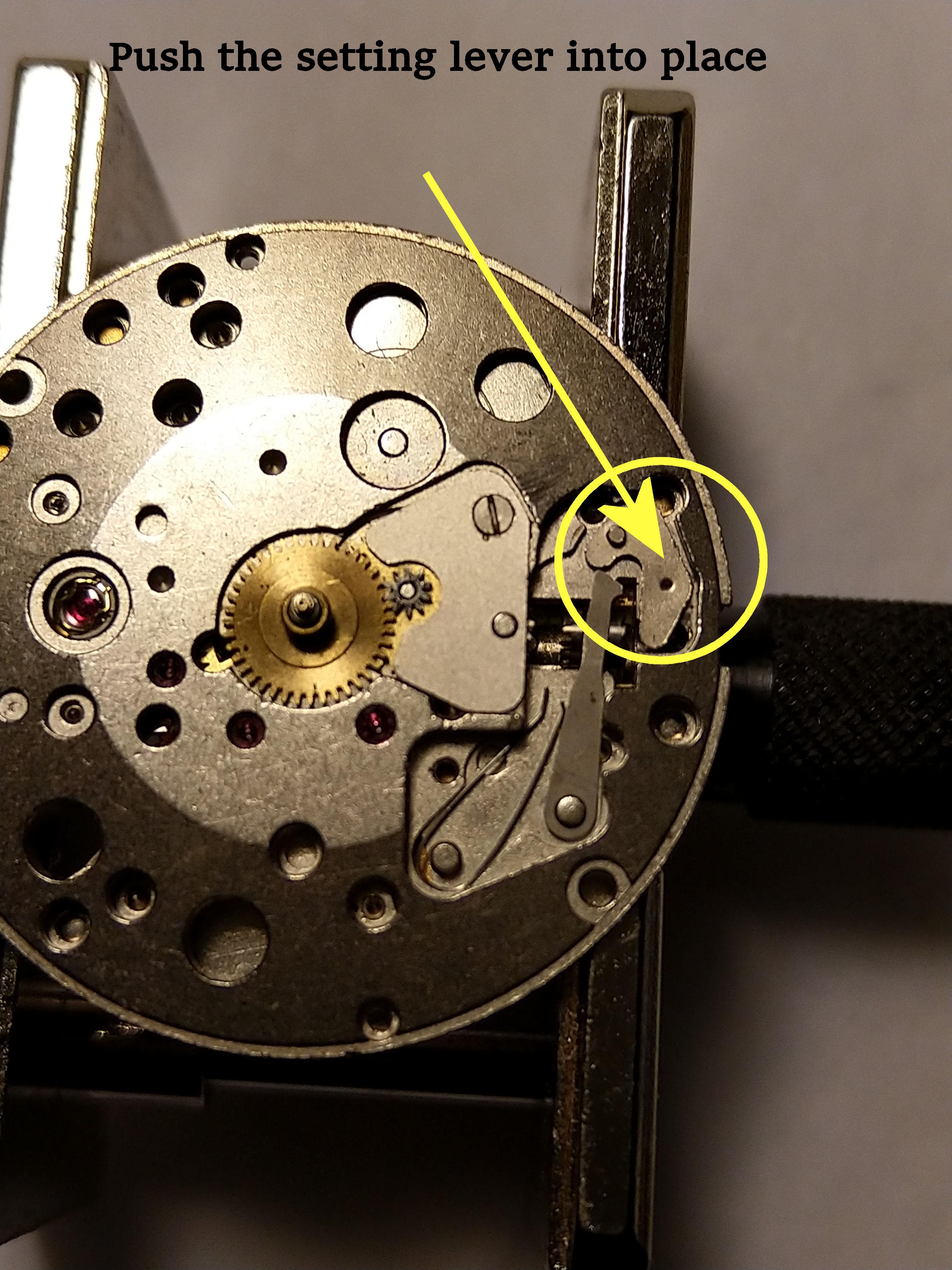

To start with you have to release the movement by removing the two case screws.
On these the dial is often friction fit so use a single edged razor and gently work your way around.

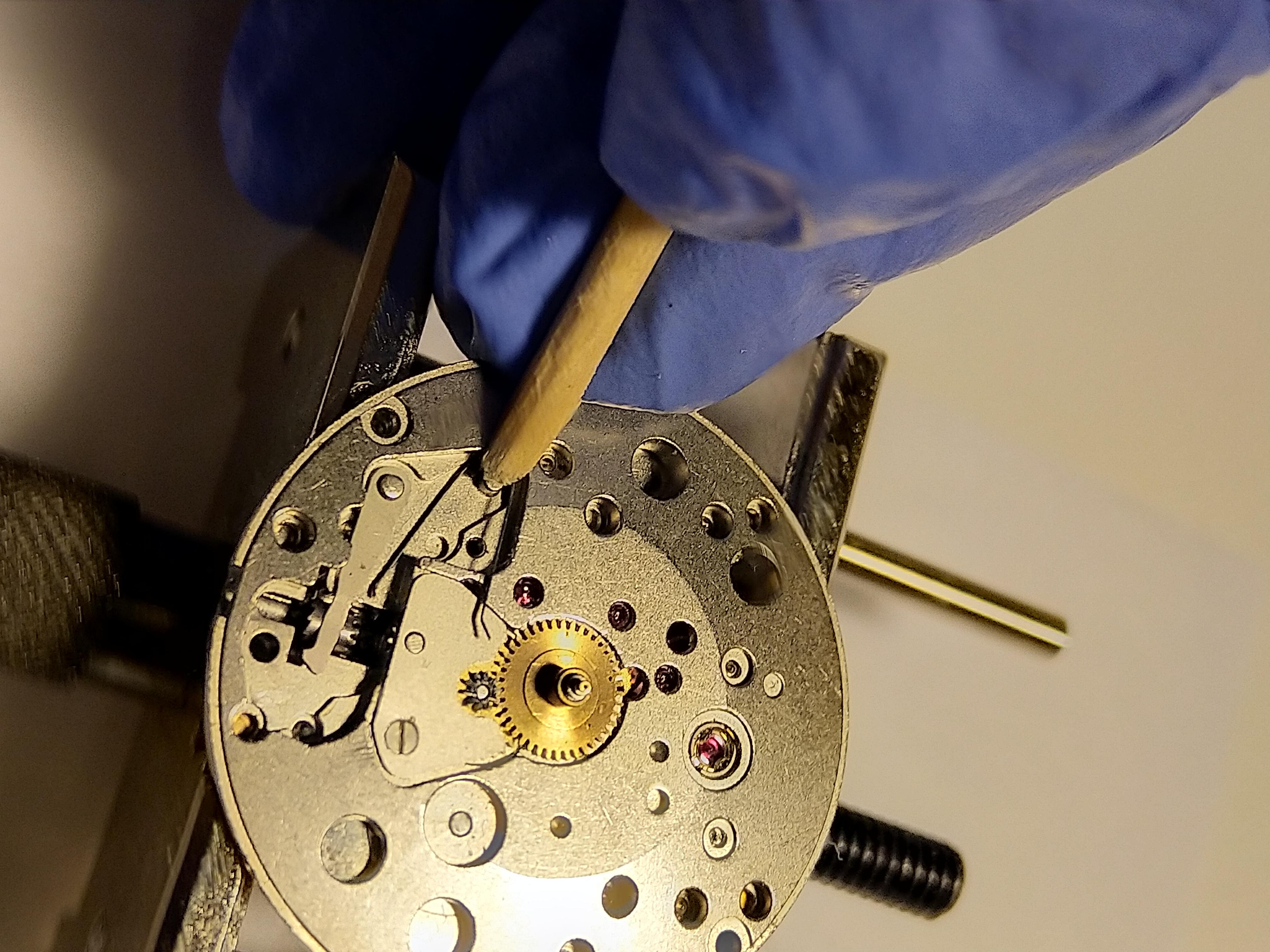

Once you removed the dial you can see the key less work and  with a high percentage you will see a dislocated lever spring.
I have included a picture of how it should look like. Remove the lever spring.
You don't have to take away the lever just push it back into place with the tweezers.
That should be it, put the lever spring back and make sure the lever guide pin ends up inside the pattern stamped out on it.
Added a picture so you can see the lever and how it works .. unfortunately the guide pin is on the other side.
But it is the lever that holds the winding stem firmly in place by the force of the lever spring..

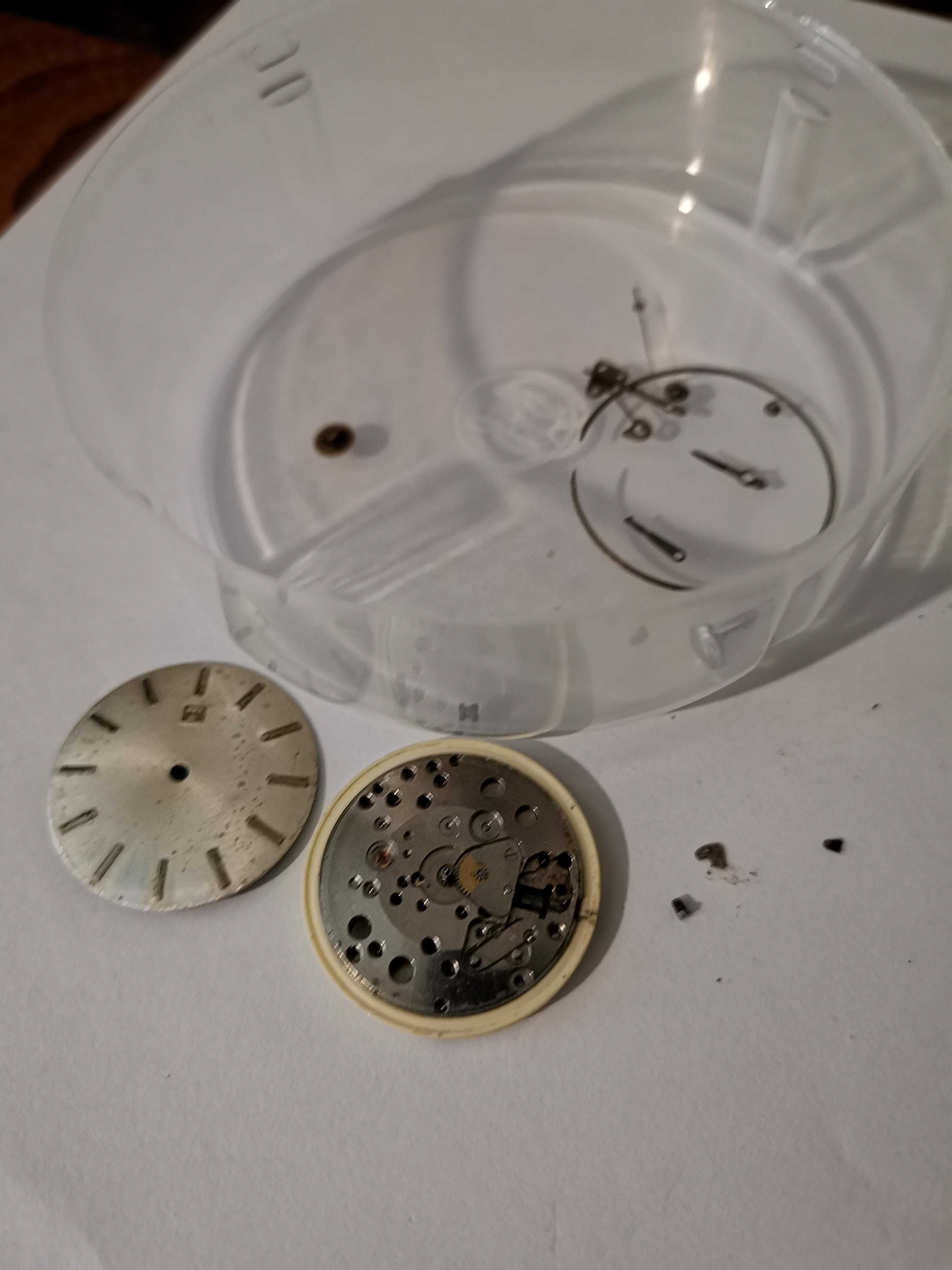

I think a parts missing when I move that arm out the way
I think it's a lost cause as now
Before it would wind and not change the hands
Now it changes the hands but don't wind...
No nothings missing ...but.. the yoke spring isn't in place.

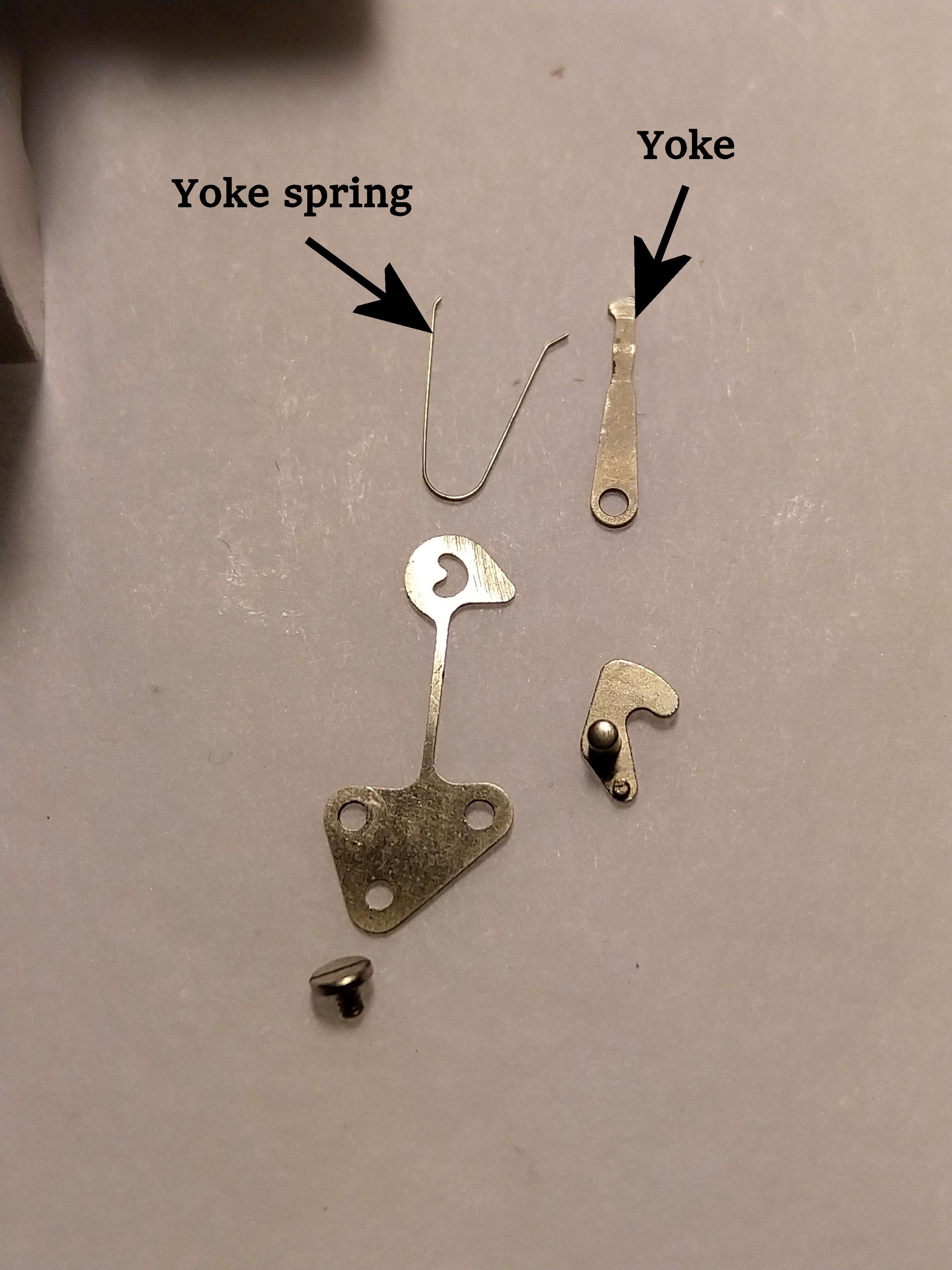

You should only make this as a practice run since the looks of the movement screams ..clean me!
On the bright side you choose a good movement to practice on.
The key less work here just consist of six pieces;
1 - The sliding pinion the part which slides back and forth on the stem when changing mode.
2 - The winding pinion, the gear behind the sliding gear, makes it possible to wind the mainspring.
3.- The yoke transfers the power from the yoke spring to the sliding pinion.
4 - The yoke spring gives the power to the snappy action when changing mode.
5 - The setting lever, assists to keep the mode correct and by that holds the winding stem into place.

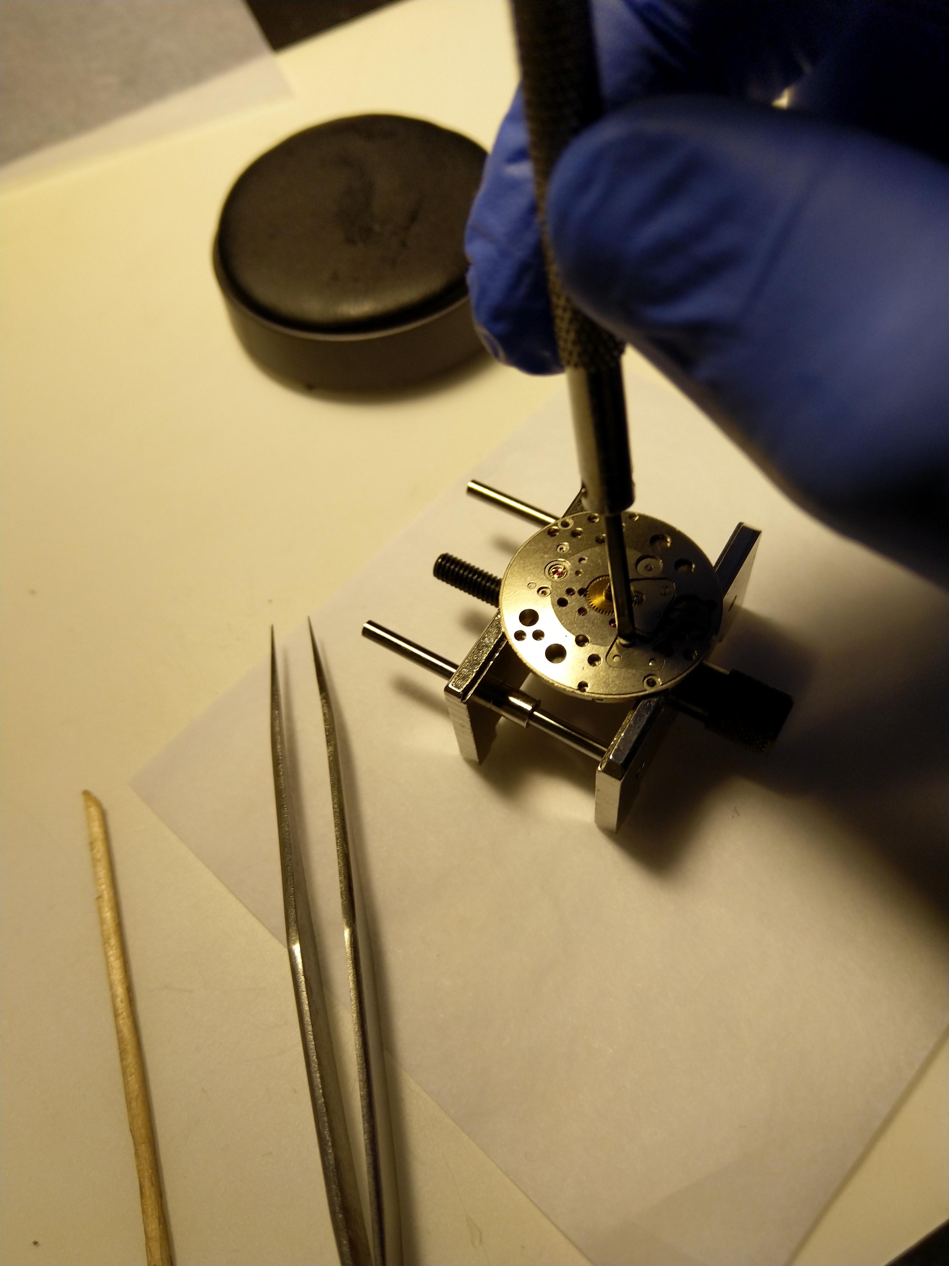

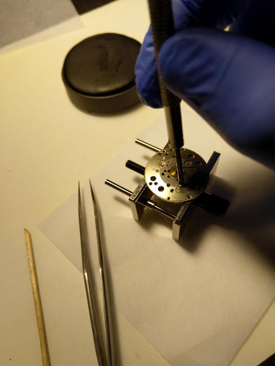

Here is a picture of the parts except the sliding and winding pinion (forgot to remove them)
The yoke should be fitted to the groove in the sliding pinion.
Next in line is to fit the yoke spring, to avoid springing it away hold it into place with a peg wood as in the picture.
Gently push the spring into place with brass tweezers, the spring should push against the yoke.
(See my previous pictures)

Next inspect the lever so it still has that little nob which holds the winding pinion..
Put it into place.
Now you can practice your skills with the screwdriver and put the lever spring back.
That should be it..
Hope this helps.

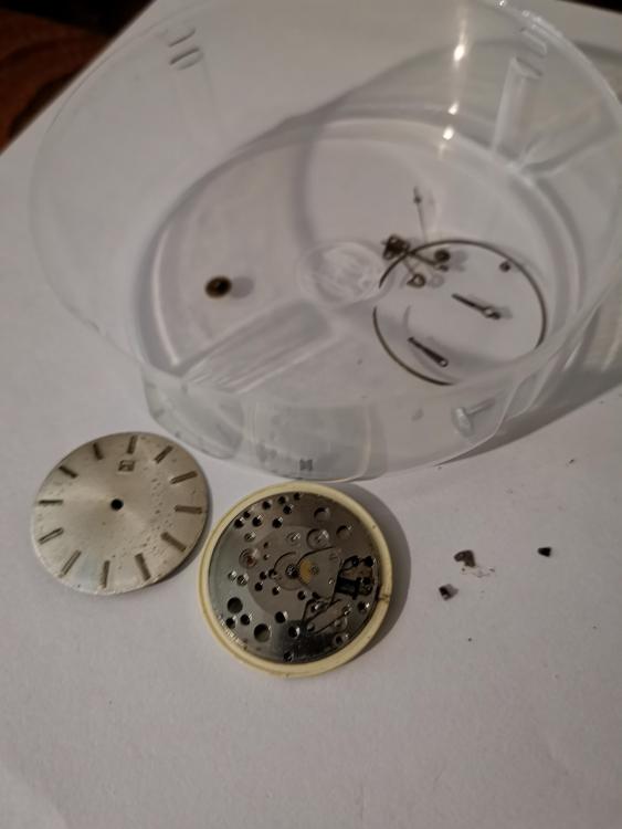

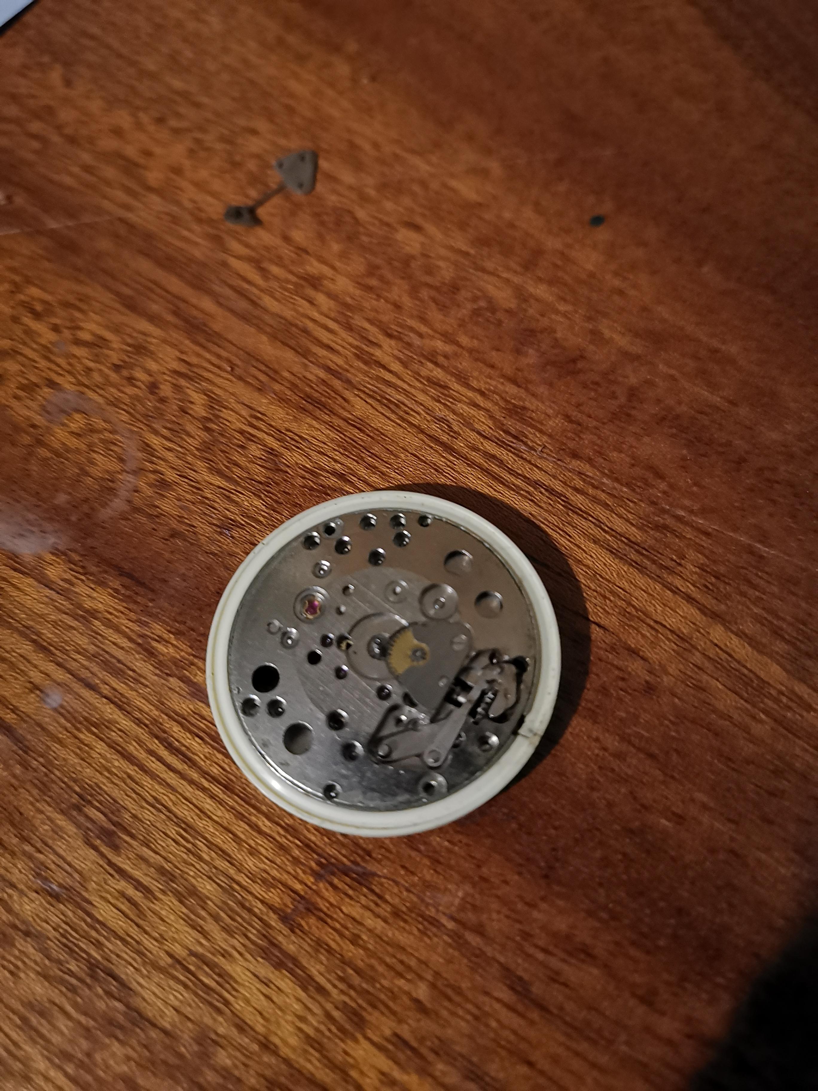

Well I got down to the nitty gritty and as you can see the release knob broke into 3 peices and the button part was stuck in
I manged to get it out but I would need to replace it
Is it worth doing?
I am trying to learn but a very new beginner
I have a few basic watch tools as I am just starting off
What would be the best way to clean that area as it looks like it's a bit rusty
I don't really want to strip the whole watch, I know that's most likely the right way but I don't want to make a mountain out of a molehill

Hi J, like you I'm just starting but concentrating more on the clocks. As it stands the watch doesn't work? You are just getting started and want to do more? You have got to start somewhere and what better than a good movement that would be of little value in its current state. Bite the bullet, give it a go and ask questions when you get stuck. Once you have sorted it out it will be a well running serviced time piece giving you satisfaction for years to come.
It's important not to get discouraged. Parts will break in the future too and springs will sprung their way to a parallell universe.
You have a good easy movement to work with and it has a chance to become a nice Watch.
Some times the parts you need is obselete but in this case you are in luck because if you don't find the lever at the bay you could pop me
your adress and it will be solved.
As for Tools to fix this you only need a pair of tweezers and one screwdriver.
Well another part gone to the universe of springs lost lol
I cleaned the bit out that was rusty and forgot to take that tiny spring out and now it's gone forever...
Sad face lol
