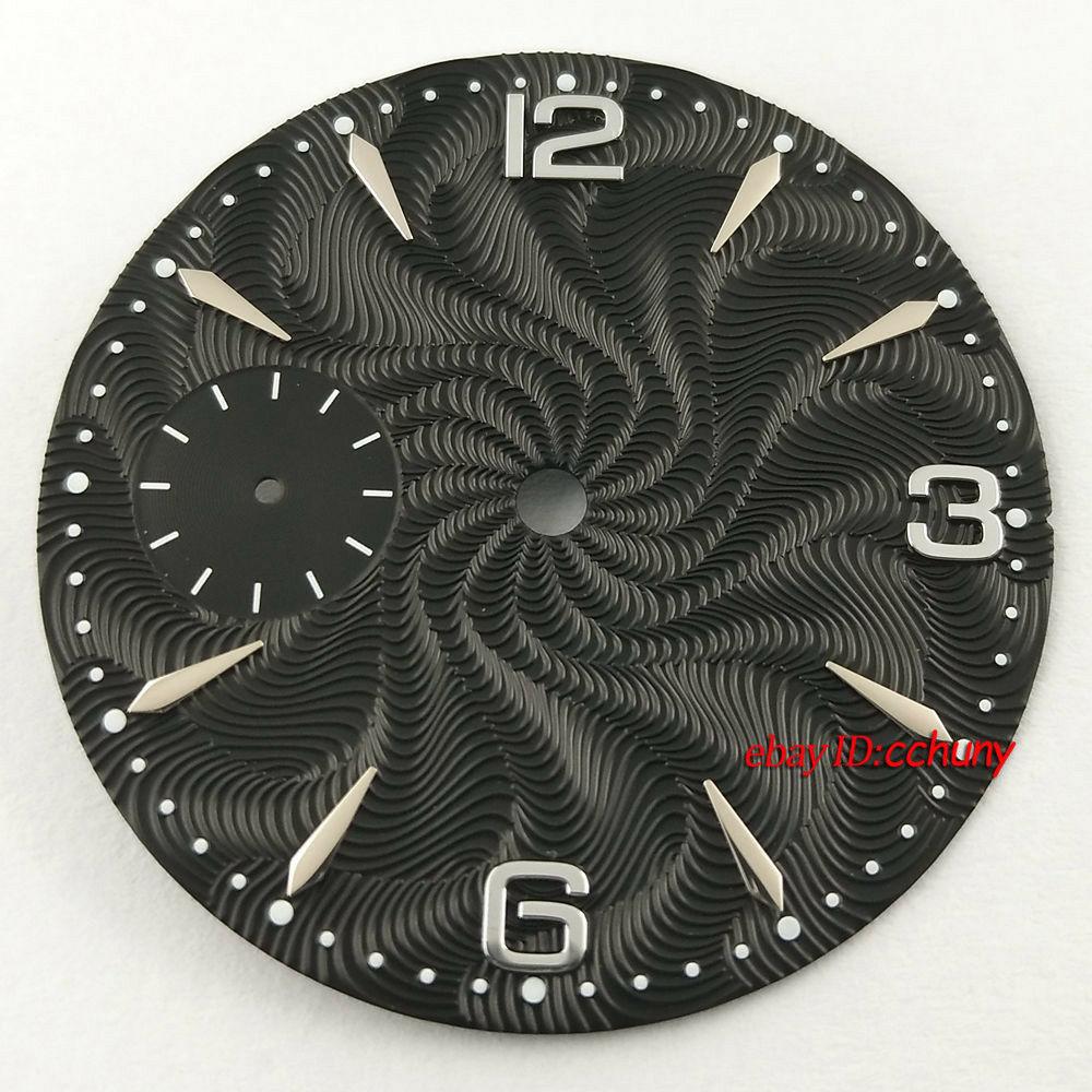

Speaking of Guilloche dials, I've had my eye on this one for awhile now. I will likely build a watch around this dial in the future
Image courtesy of eBay
I like that. Now if it was blue.... :P
I presume it fits something with the crown at 12 and the seconds at six, but rotated through 90 degrees clockwise.
Have you got something suitable in mind?
Ask, and ye shall receive!
Image courtesy of Ebay.
It's for the ETA 6497 or the Seagull ST 3600 movements. Makes for a large wrist watch, but totally worth it, IMO!

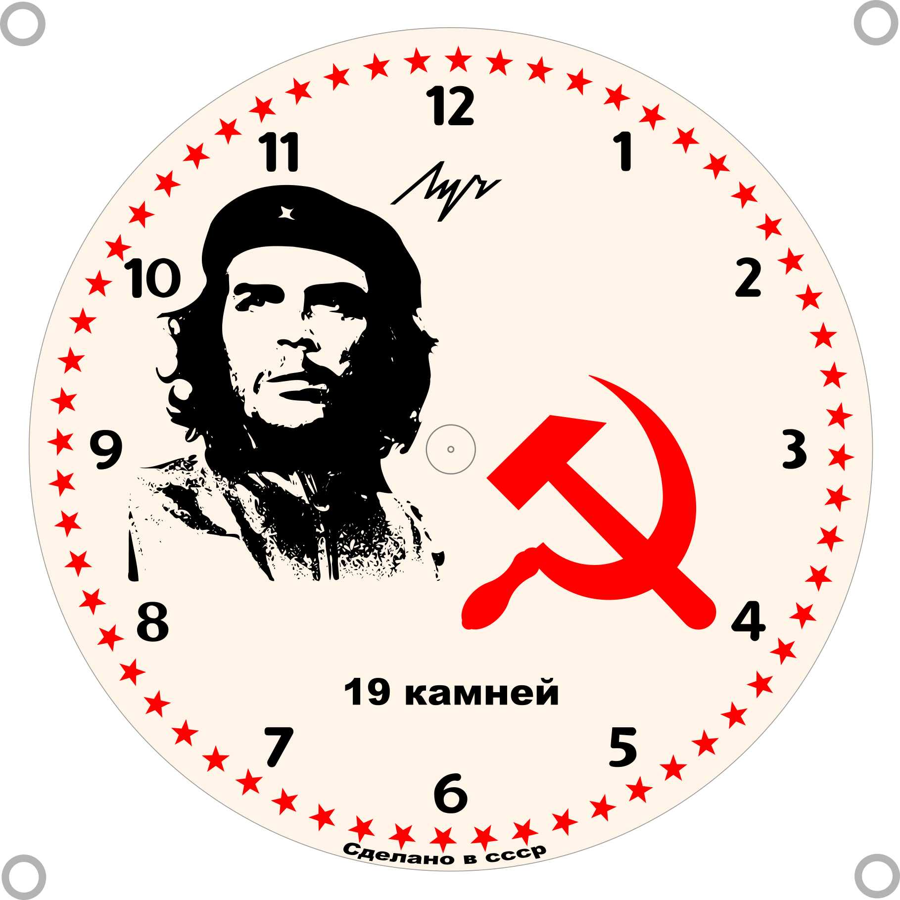

CheVer1.0-30.100Centre1.79RoundWhite_svg.thumb.png.464127623ea41239e8cd73101bebd6c9.pngMore fun with Soviet era kitch, and public domain .SVG images.
CheVer1.0-30.100Centre1.79RoundWhite.svg
Before you ask, no, Luch, so far as I am aware, never produced a "Che" manual wind watch in his style, but Poljot produced something similar, and  POBEDA (ZIM/ZYM) seemed to have done a couple of different styled Che Guevara models.
As with the my other creations, you are free to use them as you please. I've stuck with a single colour this time, and the above .PNG is scaled to allow printing at around 30mm at 1440 dpi.but looks fine at 600 dpi.  so this should suit inkjet, laserjet or pad printing.
You may need to remove the Luch logo if you are planning on selling anything related to the two "Luch" style designs, unless of course they are being fitted to a genuine Luch watch, in which case, you would probably be fine, so long as the buyer knows it is not an original dial.  Changing the logo is as simple as opening the SVG, un-grouping everything and removing or replacing that one object. Changing the "Сделано в ссср" and "19 камней" is just as simple. If there are any Russian speakers, they may be able to correct any typos in these. Also "кварц" according to Google Translate should say quartz... maybe.

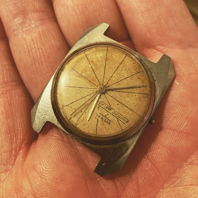

Since I had a few spare minutes, I printed off a couple of test prints on ordinary A4 cheap printer paper on my ancient HP 4650 colour laser printer.
The laser printer is limited to 600dpi, however despite that, the results look not too bad. Ignore the red streak, that is due to a small mark on the red cartridge drum.
The victim is a 19 jewel Sekona with a trashed dial. I'll need to modify the artwork to match the jewel count.
