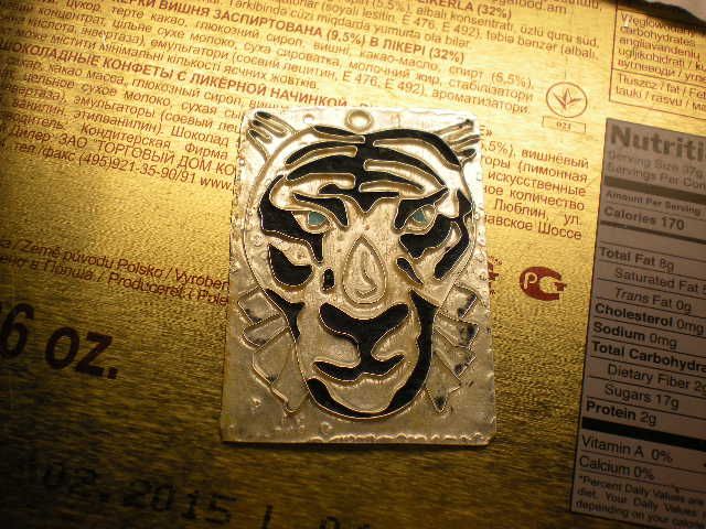

Wow that is one cool memento mori design.
I presume that is etched copper.
What process are you using to etch? It is nice and sharp.
What enamels are you planning to use?
What kind of setup are you going to fire it in?
Are you enameling both sides to keep the enamels from cracking?
Does it have dial feet? If so how are they attached
7 hours ago, EnamelDial said:
Have you drawn the California dial ?
I'm not sure I understand the question. Panerai California?
Iron chloride does not digest steel poorly - I add HNO3
I use an iron and laser print on blue foil (ebay)
This is how I can selectively apply hot enamel - I can do whatever I want in the enamel.
I used your design - etched on brass
Wow! BEAUTIFUL WORK!
WOW !!! wonferfull job buddy ... you're definitely more an artist or a craftsman than a hobbyist
Just one question about the "blue foil" you use ... is it Press-n-Peel blue transfer paper used to etch PCBs ?

No - it's a foil like the projector, only blue.
Or you can print on the cover of a color women's magazine - or tracing paper.
My job is to assemble road safety barriers.
I guilloche and enamel for fun.

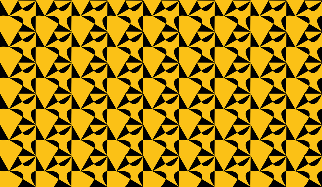

This arrived in one of my many feeds. It describes how to use Inkscake for tessellations (repeated tilling of the 2D plane with less than obvious shapes).
https://www.instructables.com/Quickly-Sketch-Escher-type-Repeats-Using-Inkscape/
There is scope for combining this with rotations to produce some very interesting circular designs.
I'll need to look in to it in more depth when I get a spare moment, but I thought I'd share it here in the hope that it might provide some inspiration.
