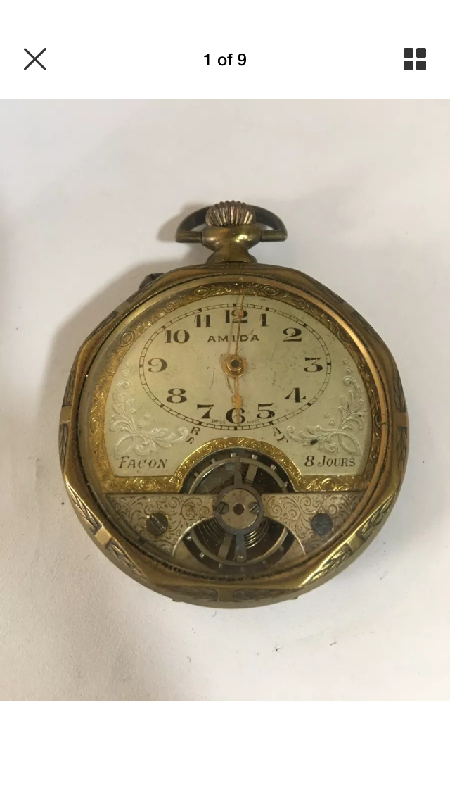

well I took a chance and splashed out £29 for this piece, bit of a gamble as the seller was quite limited in their description. From what I can see I’m going to need to straighten the hairspring, it looks like someone has true to move the regulator and bent the spring by the stud so hopefully I might be able to get it almost true whilst it’s still attached!!!’
I can see a new crystal is required and of course a major clean and inspection and service.
so the million dollar question is Does anyone know anything about it, I’ve done a limited internet search but not really coming up with much, as I haven’t got it yet I don’t even know the caliper of the movement!!’
Back again, well I have tweeked the hairspring back into true again, brushed some essence of Renata in the visible “jewel” holes and dropped in a little oil and it runs.
only dial up though, as soon as I go Pendant up it ticks normally for about five seconds then the balance wheel goes really fast for about 5 seconds then it stops. Any idea as to why this might be happening?
Also and just as importantly does anyone have any idea as to the movement cal. I know amida used their own movements but also AS but I have had no luck finding a number as of yet. I will do a deep search in ranft but I don’t think they do a visible escapement in their search.
As of yet I haven’t stripped cleaned  etc etc all I’ve done is a five minute job just to see if it would tick. I’m curious to get ideas as to why the balance is doing what it’s doing before I strip it down so I can have an idea what to look for as I strip it down and locate the fault, which will help me on future jobs fingers crossed.
Many thanks for any info, full pictures of strip and service hopefully in a weeks time all being well.

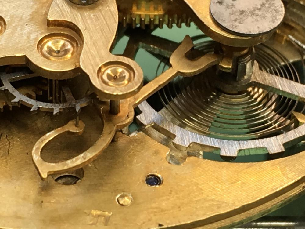

Here’s a good picture, I’ve just been starting the investigations, when manually moving the escape wheel there is no movement towards the roller on the balance when the pins are on lock.
The first picture is how it sits right now frozen.
The second picture is after I’ve just nudged the balance and it’s gone straight into being over-banked
The third photo is showing the position of the pins on the escape wheel whilst overbank
Ok I’ve just put the balance back in without the bridge screws in place and it ticked away nicely until it froze again in this position.
Mum starting to think this is balance related, with some unwanted friction on the balance staff pivots maybe.
The second photo is the best, it shows the fork stuck on the roller and the position of the pins on the escape wheel. Thoughts?
The third and fourth photos shows how it has stopped again, this time as I thought the safety piece has no clearance from the staff and has jammed up against it.
Edited by transporter
In the second photo from post #19 you have an impulse face on a pin, this is pushing the guard pin against the safety roller. When you manually move the balance the wedging effect there is kicking the fork over to overbanked, before the impulse pin has a chance to enter the horns.
Double check your drop and total lock and freedom of the guard pin. I think it's not locking correctly and either the pallet pin dephthing to escape wheel is a bit shallow, guard pin too short, both, or both and excessive side shake on balance in particular.
Ok I think I might of sorted this, the pallet and the pins, obviously when the balance was skipping there was insufficient lock, now I’ve adjusted the lock ( trial and error ) it’s running great in all positions at the moment. Amazing how one small problem gets you looking at a thousand possibilities around the movement.
Try shifting the tail on the fork which carries the pins toward the escape wheel a little bit. The pins also look pretty rusty, they (and the escape teeth) need to be really smooth, polished.
Yes you were correct mate, it was the pins out of position, so grateful for your input on this, kinda get lost sometimes not being able to see the wood for the trees. I will put on the timer out of interest to see If it gives a trace ( i doubt it ) I’ll turn recase it and test over the next few days in different positions to see how it fares.
