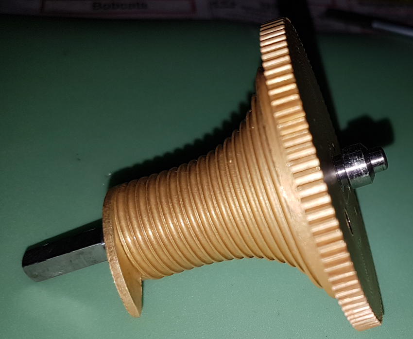

When I went to dismantle the fusee for cleaning I found another issue, the keyway piece had not been aligned correctly and the screw holding it in place had been put in at an angle damaging the thread on the screw and fusee, so I will need to fit a new screw and either retap the thread in the great wheel or plug the existing hole and drill and tap a new thread.
For those that haven't seen inside a fusee I've prepared a few photos, please note this clock does not have maintaining power for for winding, if it did it would have 2 wheels, a maintaining power wheel and a great wheel, this clock just has a great wheel.
First picture shows the fusee in 3 parts.
From the left we have the fusee cone with the ratchet wheel on the right and the stop piece on the left.
Then we have the great wheel showing the fusee click and spring, unlike a regular clock the has the ratchet outside the plates fusee clocks have them inside the ratchet (They may also have another ratchet on the main spring barrel, but this clock does not).
On the far right we have the keyway piece.
This photo shows the great wheel fitted, the hole drilled in the great wheel by the click in the photo above lets you insert a small screwdriver to hold the click out of the way of the ratchet whilst you fit it on the fusee. At this point there is nothing stopping the great wheel from falling off, notice the slot cut into the arbor, this is for the keyway piece.fusee2.png.e2f55cc673e2f0dcc9de278d65c51704.png
This photo shows the keyway piece in the process of being fitted. You can see a screw hole in the great wheel at about 10:30pm, the keyway piece needs to be rotated around and then pushed home so the screw hole in this aligns with the one in the great wheel as per the second  photo below.
I should add that the keyway piece is slightly domed so that the great wheel fits snugly against the fuse, with no sideways movement, but not so tight that it binds on the fusee. As the thread is damaged on my screw I haven't shown it fitted in the photo, but you would normally fit it now which would stop the keyway piece from being able to slide back out.

The fusee is now fixed, I redrilled the screw hole to take an 8BA thread, tapped it and reamed out the keyway piece hole for the screw head to fit the slightly larger size screw head.

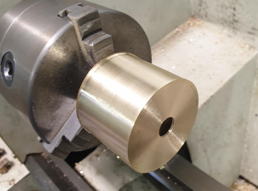

During the week I cut a section of the tube off, machined the ends square but left it about 6mm over length to finish to size when I do the top cap, then cut a recess for the bottom end cap to sit in and today I made the bottom end cap.
I am using 1.5mm brass sheet to make the end caps and decided to try something I haven't done before, that is use a superglue chuck.
I got the idea from watching Clickspring's videos when he made the barrel for his clock.
Here is the superglue chuck prepared, the rings on it are to allow air in to help the glue dry.glue_chuck.jpg.159a002a61f111a18bd198f44ea8d025.jpg
The brass sheet was marked out, center punched and cut out roughly. The chuck was then covered in superglue and with the help of the live center in the center punch mark the brass sheet was glued to the chuck. Here it is partially turned to size.
To turn it to the correct size once I got it close I did several size checks, taking off 0.1mm between each check until it was a good fit.
Here it is turned to the correct diameter.
I then drilled it out to 12mm ready for when I fit it with it's bush.bottom_cap3.jpg.01036c93abab607fa225ea5905efc58a.jpg
To remove it off the superglue chuck I just heated it with my MAPP gas blow torch for 10 or 15 seconds and it fell off.
Test fit of the bottom cap.
Notice how the barrel walls are sitting slightly higher then the end cap, 0.2mm to be exact. This is because I decided to go old school and rivet the end cap on.
Following Donald de Carle's advice I filed the end of the cap unevenly for riveting so the brass from the barrel tube will lock in against it during riveting to stop it being able to turn.
Here it is half way through the rivetting.
Now finished, its not perfect, but it won't come apart and it was a good learning experience.
