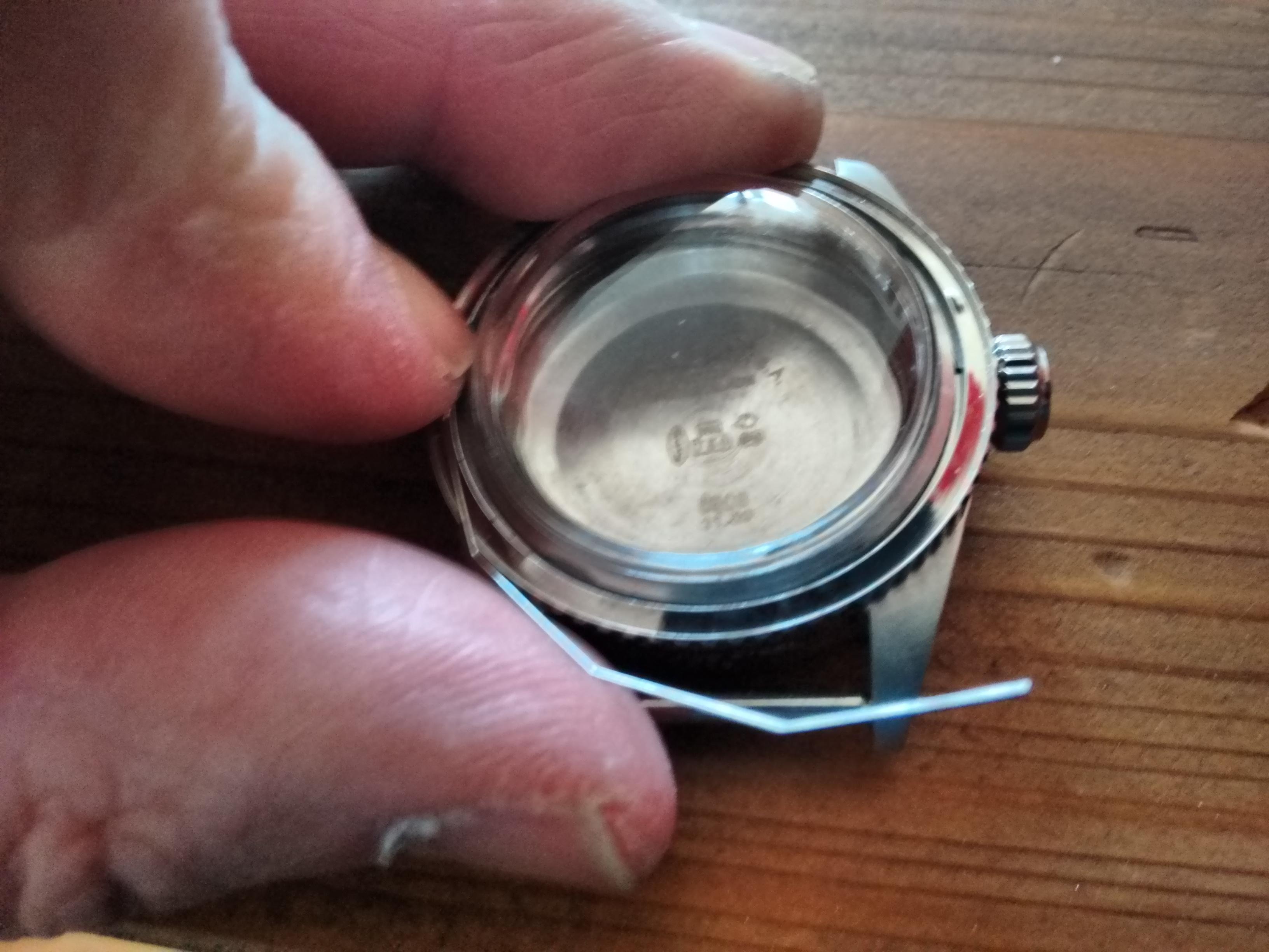

Here are some pics of a paperclip-spring bezel and how it's fitted on the case.
BEZEL (downside) and "PAPERCLIP SPRING"
BEZEL (upside) with the PAPERCLIP SRPING installed in its inner groove
look at the watch case behind ... you can see there is a groove too on the rehaut
Installing the BEZEL on the watch case
the paperclip spring must be fitted both inside the bezel's groove and the rehaut's groove
Check your watch case and if there is a groove deep enough on the rehaut to take a paperclip-spring (if not ... you still  can rework the case on a lathe the make groove deep enough) you should measure :
