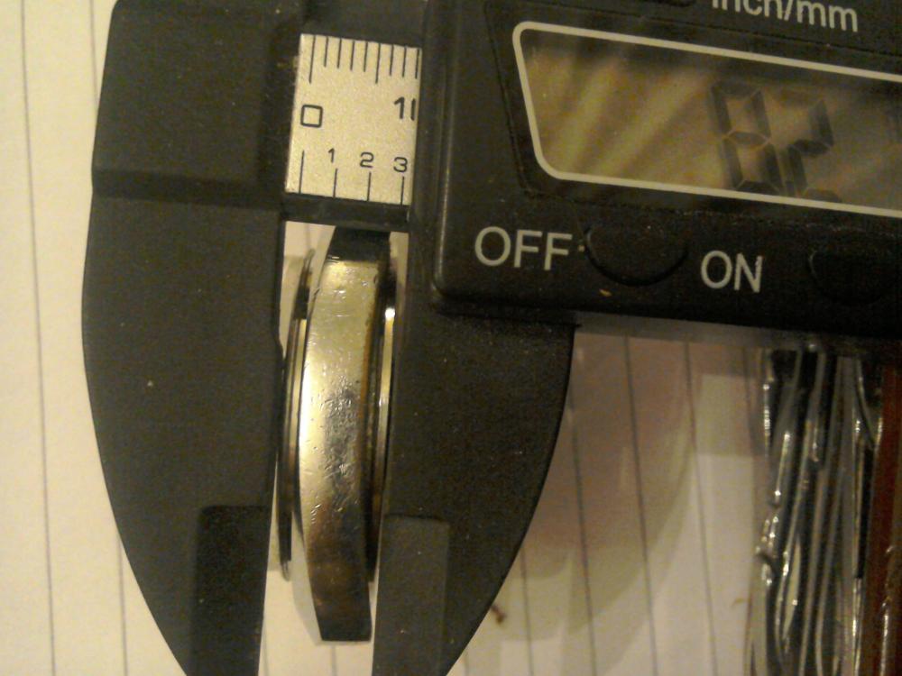

On 12/22/2018 at 9:16 PM, Johnnie said:
The gauge I have can't get into groove! Will need to buy something else.
Method.. Take two pieces of material that do fit in the groove and are deeper than the groove (two pieces of wire or plastic, or brass bar for example), place them in the groove ensuring they touch the bottom. Measure across the groove, including the two pieces of material, call that "A". Measure the width of the two pieces of material, call that "B". Subtract "B" from "A", and you have the width (diameter) of the bottom of the groove.

I have re-read all the topic and the only dimensions we need are A, B, C and  D on my sketch.
The depth on the groove is not really important as only the spring will go inside.
At the moment I have a friend building a custom S-Steel rotating bezel for one of my builds, almost the same you need apart the specific dimensions and the fact that on mine the spring goes in from the underside (no insert on my bezel) and on yours it should go from the upperside (it will be hidden under the bezel insert).
