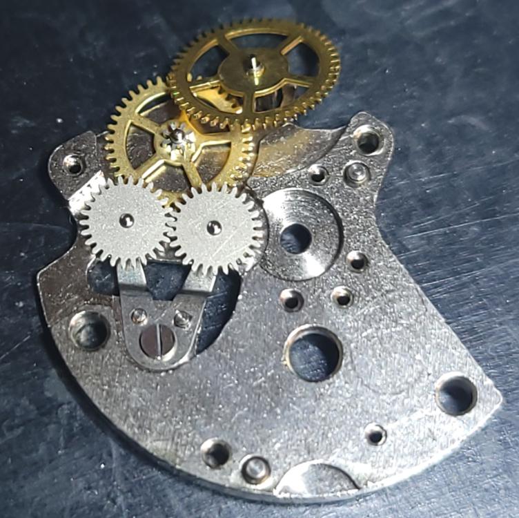

  23. Hello, I do it by hand and you can see in the picture, Thank you again
    1 point
  24. Well done. What does the first word say around the micro adjustment assembly please ? Might still be worth a disassembly clean and lubrication of the bearings of the two gears at some point when you feel confident.
