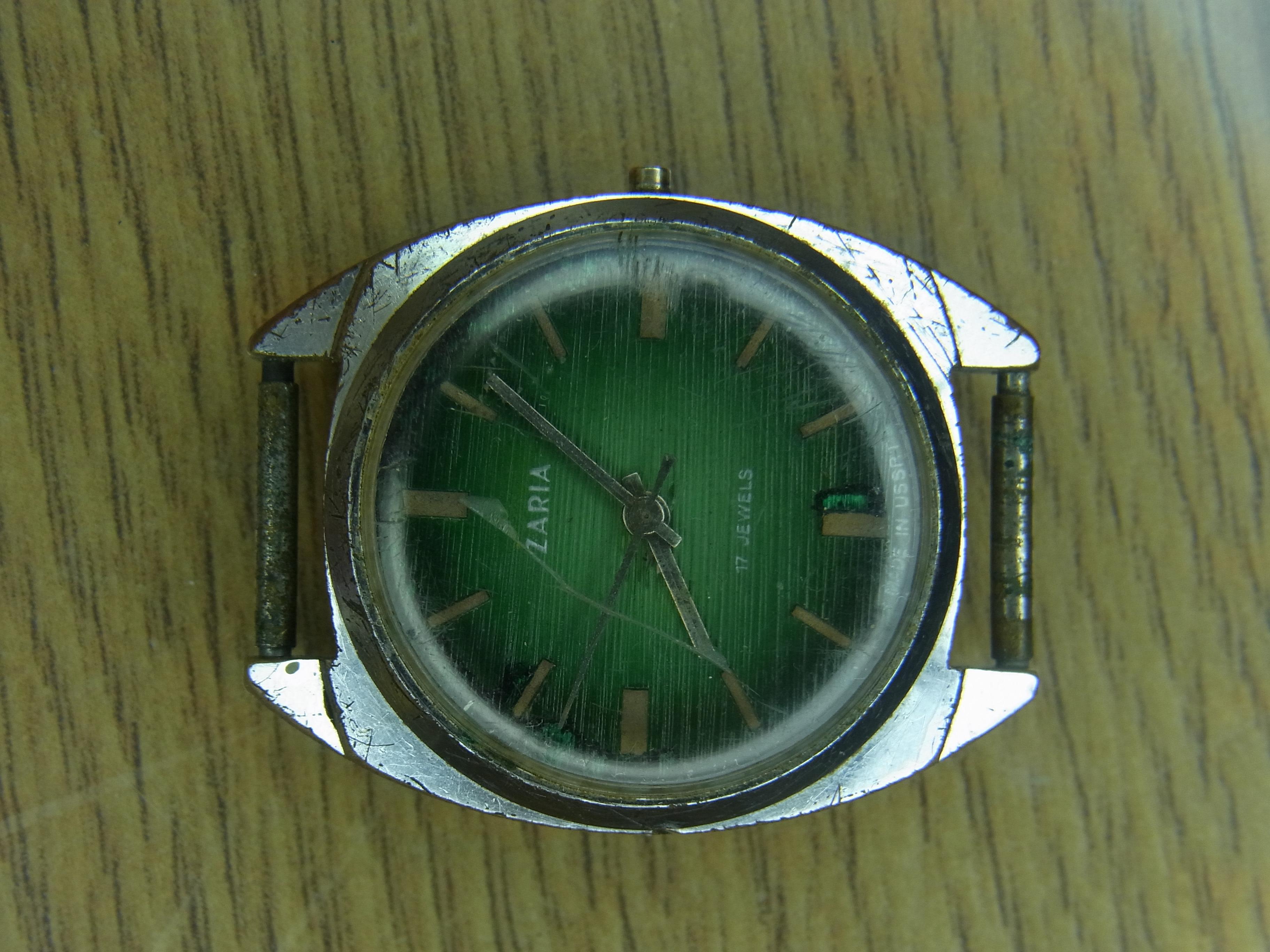

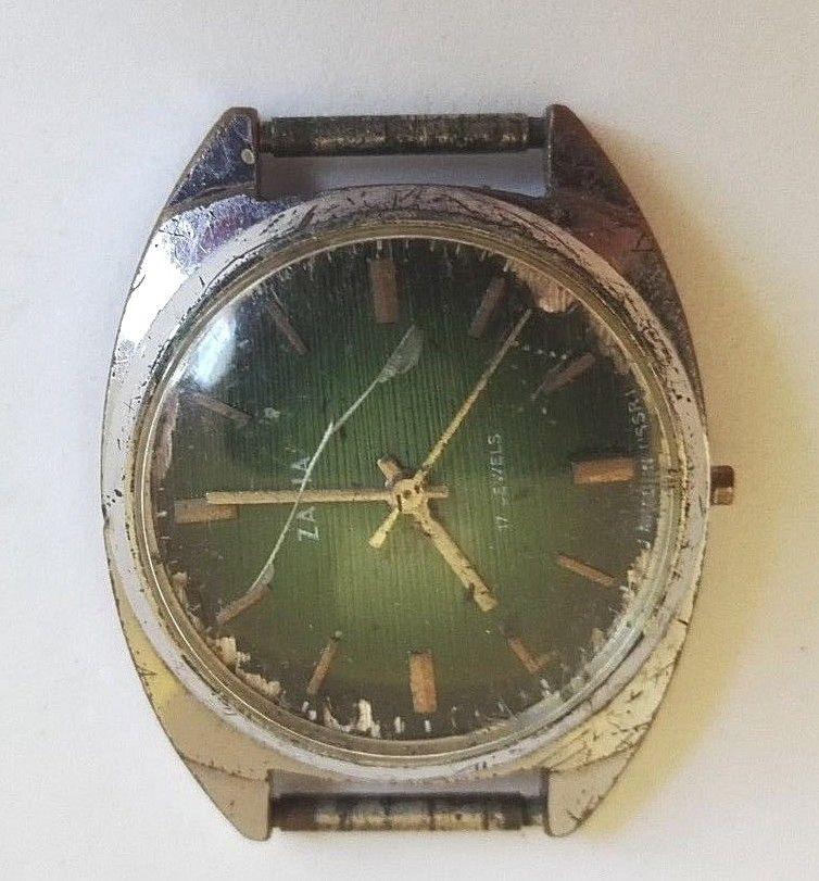

Dragged from the pile of random, I give you.. a Zaria 2009 based errr... Zaria.
The missing winder stem might be a bit of an issue. I'll look through my stash and see if any of them fit. If not I have a dilemma since I can pick up an entire similar watch, shipped from the Ukraine for less than the price of the stem.
There was also a bit of dial dandruff going on, which I have stabilized with a green sharpie. Not very professional perhaps, but since the watch cost less than the sharpie, who's complaining.
It is actually very well put together, and runs reasonably well. You could grow potatoes in the "patina", and it obviously needs a crystal and a suitable strap. I think its probably circa early to mid 1960s, and has "Made in USSR" still visible at the base of the dial.
Another bit of horological history for the collection. As well as being a Soviet era watch brand, Zaria is I understand, a goddess from Slavic Mythology.

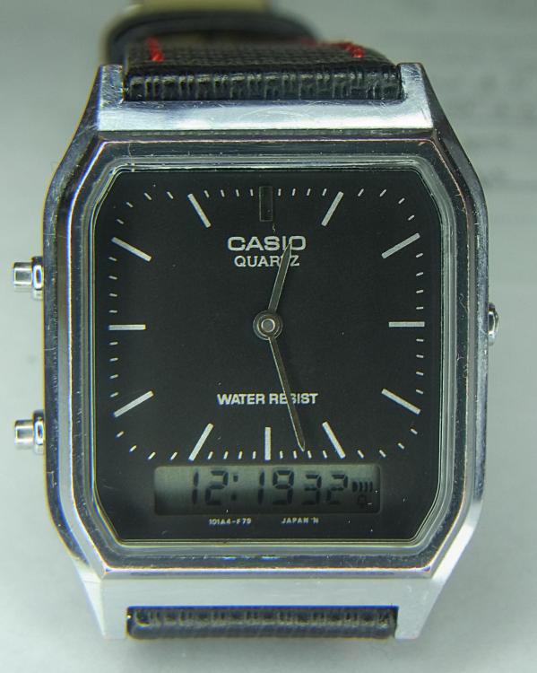

The "new" Casio AQ-230 with the black dial, I posted about earlier in "Watch of Today" got a much needed spruce up and polish.
This one has a metal body, unlike its white dialled cousin I picked up a few months back, which has the newer "matalized resin" body (i.e. plastic).
I also took it off the stainless steel hair puller (which is now sitting in a small glass jar, soaking in a mix of detergent and antiseptic).
I tried a couple of black leather bands before I settled on this 1990s styled faux carbon fiber fabric band with red stitching and a leather backing.
All of the major battle scars are gone. What I will say is, while it may not be a chick magnet, it is most certainly a smudge magnet.
The rejuvenated crystal is now so new and shiny looking that every spec of dust or hint of a fingerprint has me reaching for the lens cloth.
