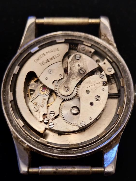

This rather beat up looking old fellow, a 17 jewel Ancre, had been assigned to the "unlikely" pile. No crystal, absolutely filthy, half of the dial accents missing, a limbless minute hand, no more than a disk of metal, and a mangled hour hand.
However to my surprise, with little more than a clean and inspection off it went. Initially somewhat reluctantly, but after a few seconds, and following a quick blow with the magic air bellows, it set of at a more normal pace.
It isn't terribly accurate, at +50 dial up, -60 or so dial down, but neither is it terrible. Now i need to figure out what I did with the "bag of ancient hands, which might come in useful some day", which I'm sure are somewhere, but where exactly is another matter.
I'll report back if I get it looking moderately presentable.
