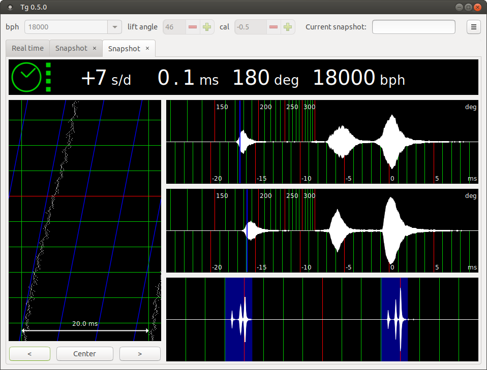

It is rock solid at about -2 to +4s/day face up and face down. I decided that in light of its performance I wouldn't touch, since there is a slight chance I might fix it till its broken. :DI didn't even open the back, it seemed somewhat unnecessary, though I suspect it might benefit from a clean and oil at some future date. HMT-Rajat-650191.thumb.png.a221205ba9004ef1e14a00bb3ebc2e03.png

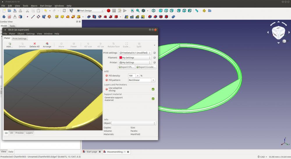

I'll also need to design a movement ring in Freecad and 3D print that. Watch this space for the finished results.

A quick "sketch and pad operation" in FreeCAD later and I have a first draft of the Silvana movement ring.
It seems to slice jist fine in slic3r, so I'll print that off this evening if I get a chance and see if it does the trick.

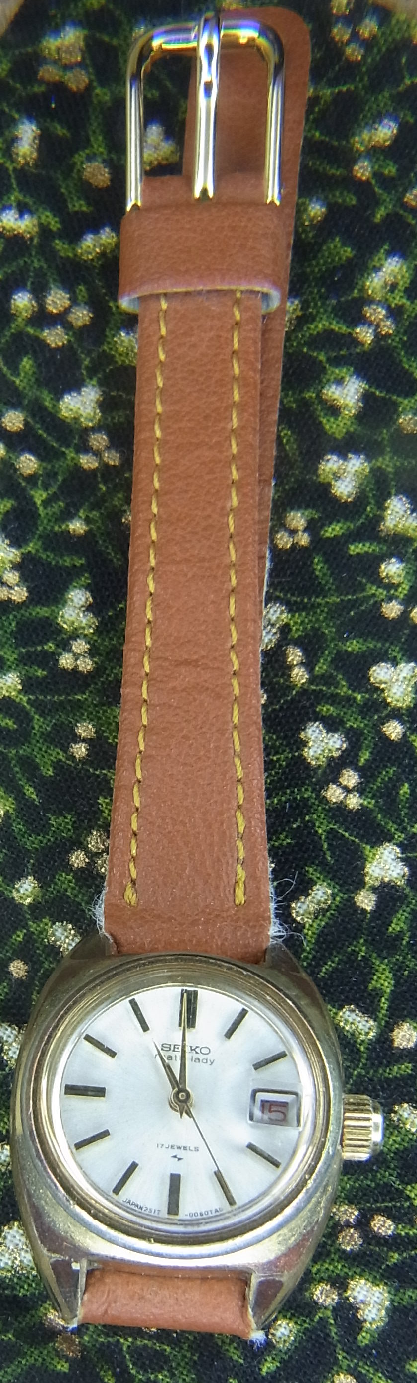

Another 404 for the healing bench. Although I'm not a huge fan of quartz, unless there is something different about them (Kinetics, Eco drives, solar etc), I must admit there was something about the titanium, blue and gold that made me put a bid on this one.
Its is in desperate need of a clean, and the bracelet is slightly damaged, but I think it should look good once it has had some treatment. .
From the serial number it looks to have been manufactured in July 1990 but 28 years of use haven't dulled the dial too badly.
For a few pennies more than a "Caramel Grande" at your local coffee shop, what's not to like. The 7n42 movement alone is worth a lot more than it cost.

Around +7 sec/day face up, similar face down. Beat error is pretty good too.
