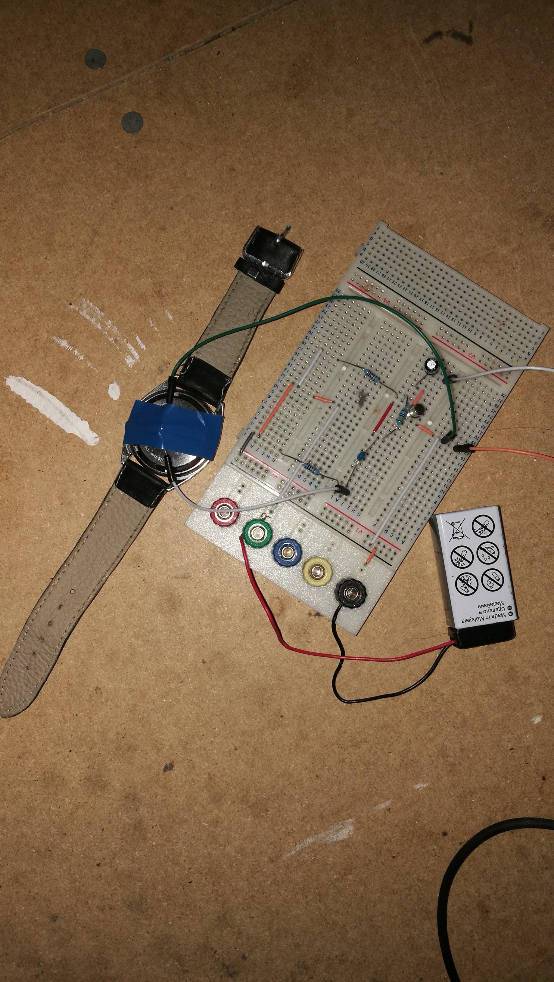

I decided to have a go at using a pre amp with the web cam mic because i'm really interested in getting this working. I used a basic circuit from google search and bread boarded it. output is from a seiko 5. Works but obviously it would be impossible to work on the watch. This setup does not work with the guitar mic pic up i bought so i'm going to try and build the watch o scope amp next and make a clamp.

The reason your circuit does not work with the guitar mic pic up Is it's been designed for a capacitive microphone which has a built in amplifier. I have a image below of what capacitive microphone circuit looks like internally. Then the reality is you don't need the circuit because computers have that built as it was designed for capacitive microphone. Guitar pickups are typically piezo it require a different type of preamplifier to work with the computer.
Then regarding the computer they're all different. The last link I have below is a US patents for a different kind a microphone not relevant for this discussion. The relevant part of the patent for this discussion is different input circuitry or specifically the bias voltages. This becomes relevant if you're trying to power your microphone off the biased voltage of the computer. The voltages are all conceivably different. If you start looking at the integrated circuits found in computers circuitry microphones a lot of them will supply different voltages. Then regarding the computers audio processing some computers it's almost an afterthought they weren't designed for audio high fidelity others are better. So if you have everything else works right you may have a crappy computer input. One of the ways around that is to get a USB sound device. Another advantage of USB devices is you can steal 5 V off the power four your circuitry.

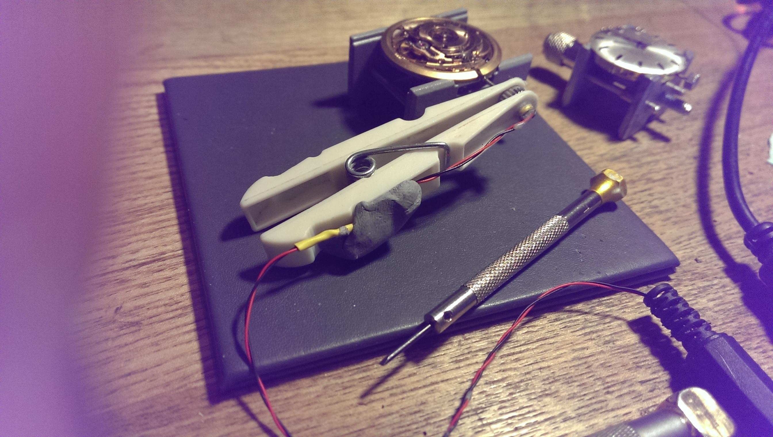

I've been messing around with this for a while now.
This works perfectly with Watch O Scope and TG.
 It's a 4mm electret mic capsule glued onto a modified clothes peg.
I hope this helps. :thumbsu:
Hi I made mine as per the instructions. Like a movement holder with the disc mounted at the rear, the front was screwed in and held the watch crown against the disc but it did need the amplifier.  Where did you get the capsule , salvaged from the head phones I am Interested.  What sort of volume do you get through the PC speakers.      a novel and practical soloution . Brill
 This capsule came from an old laptop.
You can salvage from an old phone or MP3 player also.
Headphones are recommended for listening, speakers tend to produce feedback.
