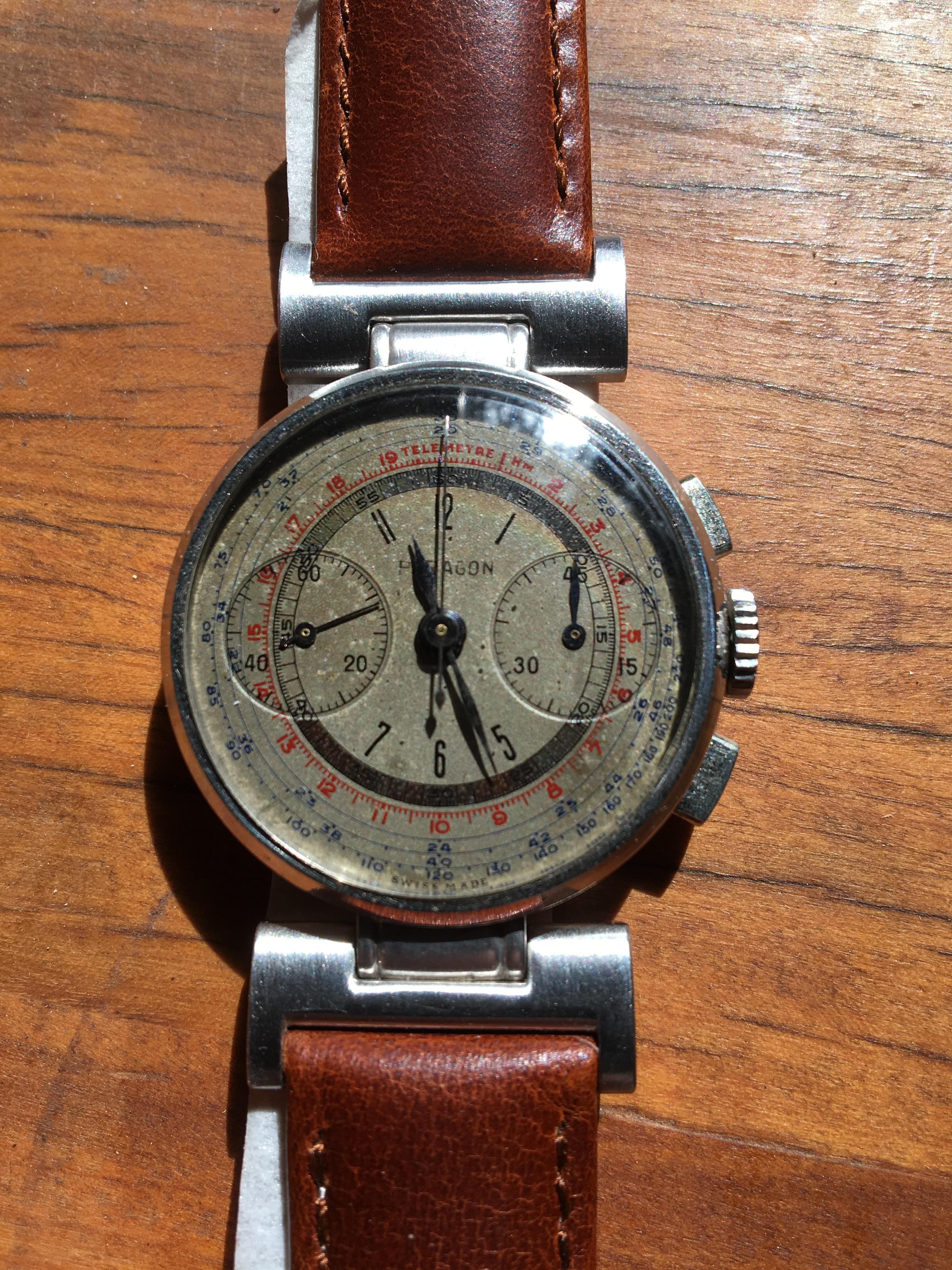

I intend to practise on those until I get some skills to take care of my first watch. A venus 175 which I find beautiful and would like to keep forever. 40c1b484f20ae044a8f1f9faeb0a4e5d.jpg84e78e6470057489d09566584a4b4c79.jpg

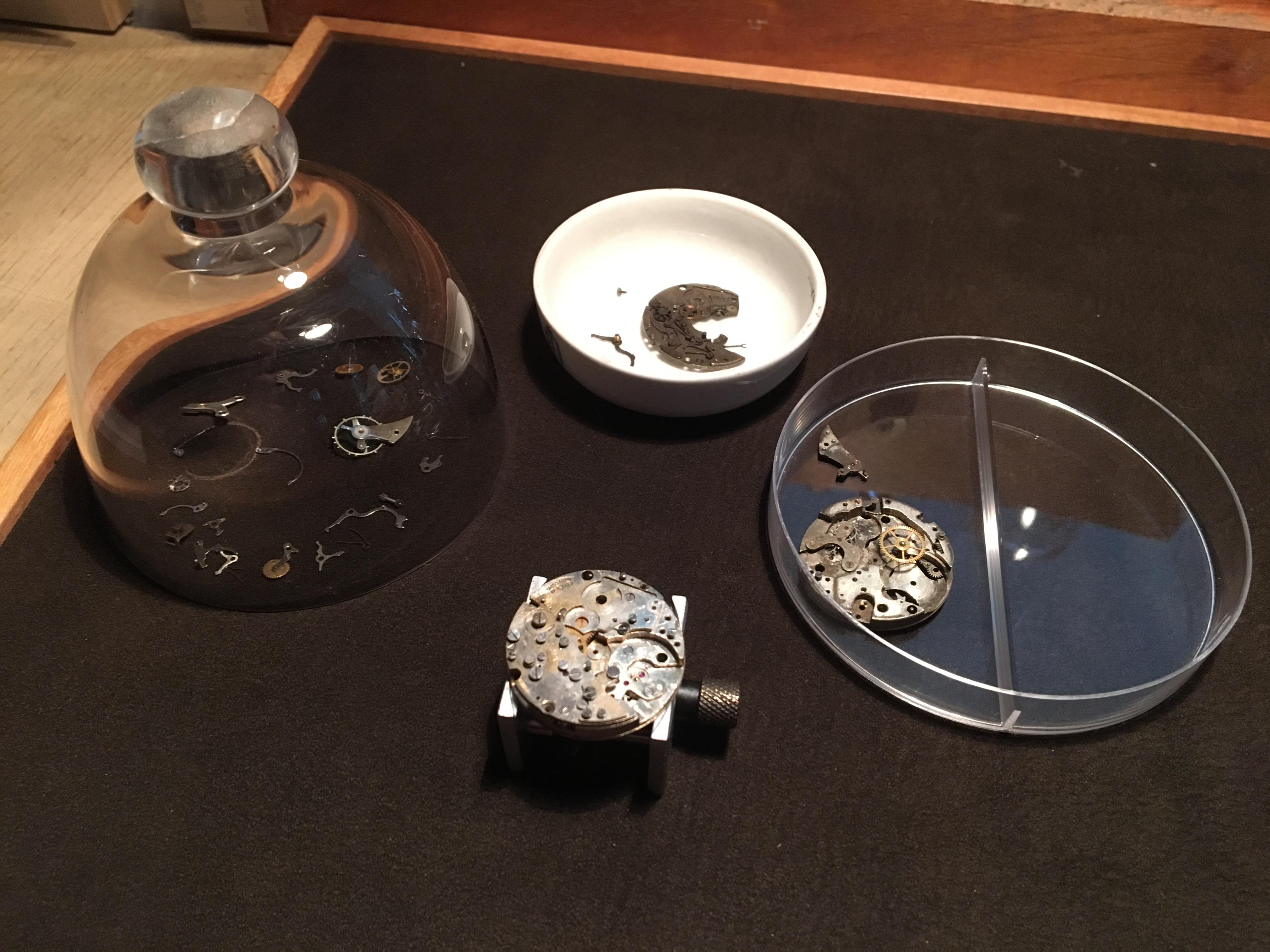

Here are pictures of my junk pieces, one rusted, the other already dismantled. And the untouched 175.

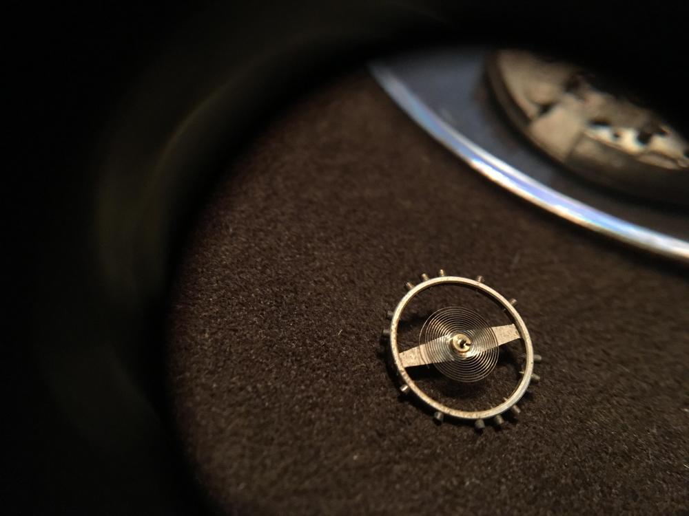

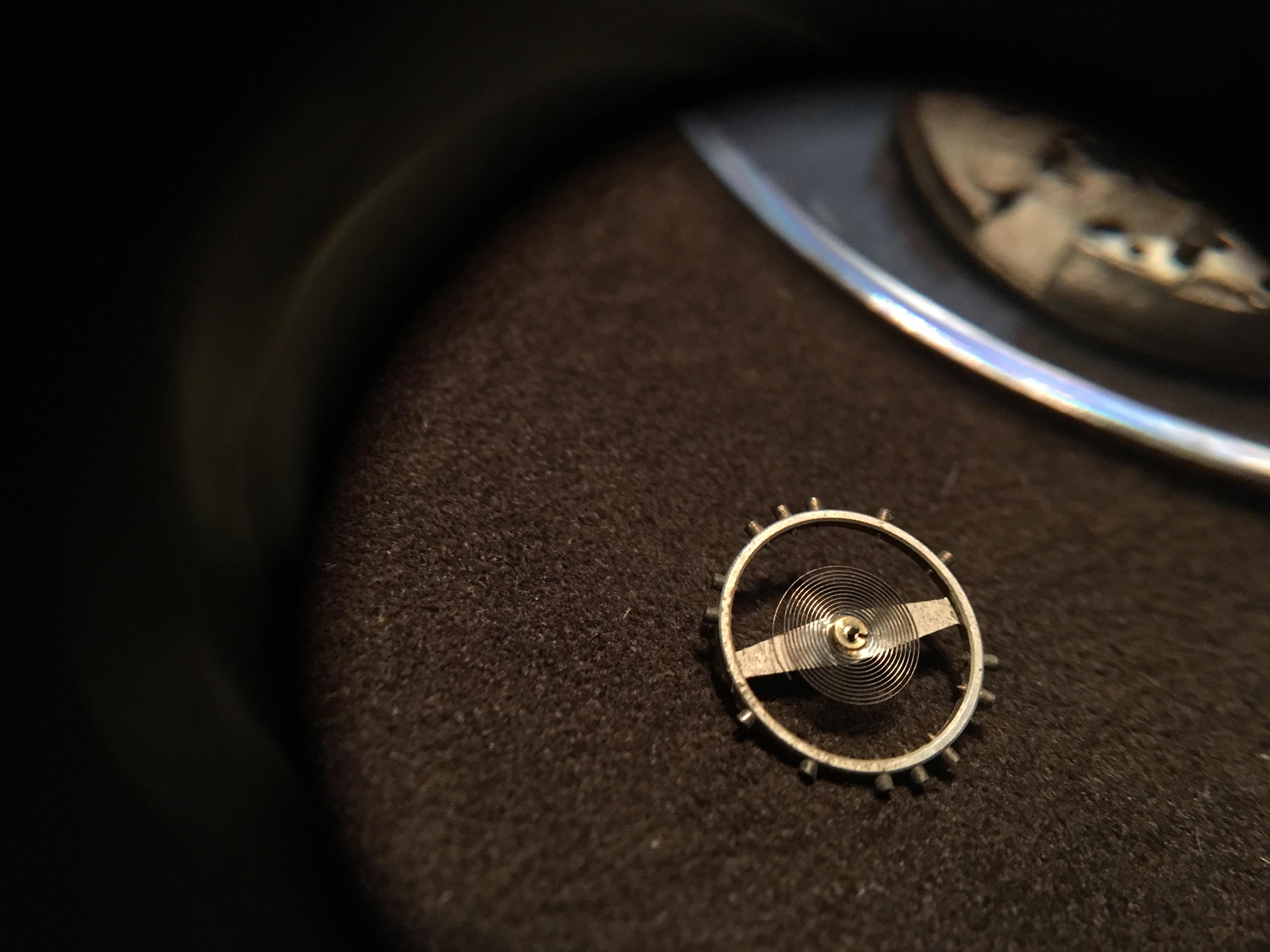

Do you think the Hairspring in the last picture can be reused?

Here are my pictures: two venus 170, one just for parts, if I get rid of the rust.  The other maybe fixable, already in pieces. Screws were kept at their places, as advised.
My 175, gaining a few minutes per day, despite demagnetization. Surely needs servicing, but I refrain to touch it.

What would you use to clean the rust in such an extreme case? Emery paper? Fiberglass?
Second hairspring does not have stud. Is it usable still?
Assuming the hairspring is the right strength for the balance it should work just fine once studded.  You'll have to adjust the length to get the timing just right though and that can be a fiddly job.
Beautiful Venus 175- it looks like it's from the 30's or 40's. :)
When it comes rust remediation I keep a few strips of 600 to 1000 grit paper in the workbench; for flat surfaces (most of the chronograph levers) one or two glides against the paper is enough.  A fiberglass pen sometimes works for those hard to get places.  A bit of vinegar will remove rust too but you've got to be really careful- soak too long and it will eat into the steel as well.  I believe there's a thread around here where someone used Sodium Carbonate for electrolytic rust removal.  I haven't tried that yet.
Thanks RyMoeller, I will then sand the pieces, preserving all the surfaces that touch other pieces. (these I will burnish with something) I ordered D5 and 8000 oil and grease, should be fine for the level of work I do.

It would be a good idea to get a caliper for measurement if you don't have one already.  When I hear the verb "sand" I immediately think of the material being removed.  It doesn't take much work to change the dimensions of a part enough for it to become non-functional.  ;o)
