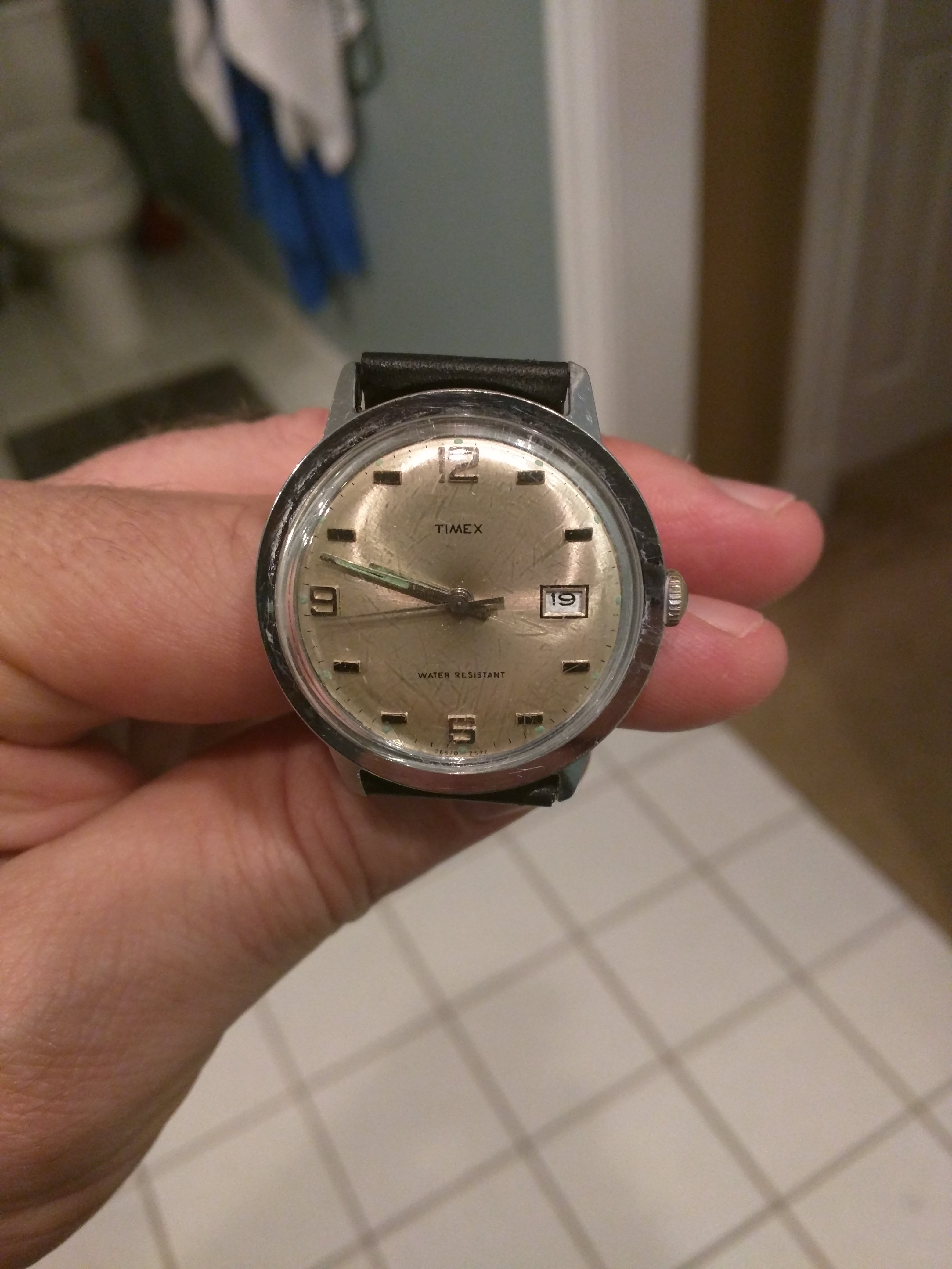

Just got this watch in today and was polishing the crystal when it popped out! Have looked everywhere and cannot find out how to get it back on! Is it a snap-in? Glue-on? Need help!!! It is an acrylic crystal, btw. Please and thank you!

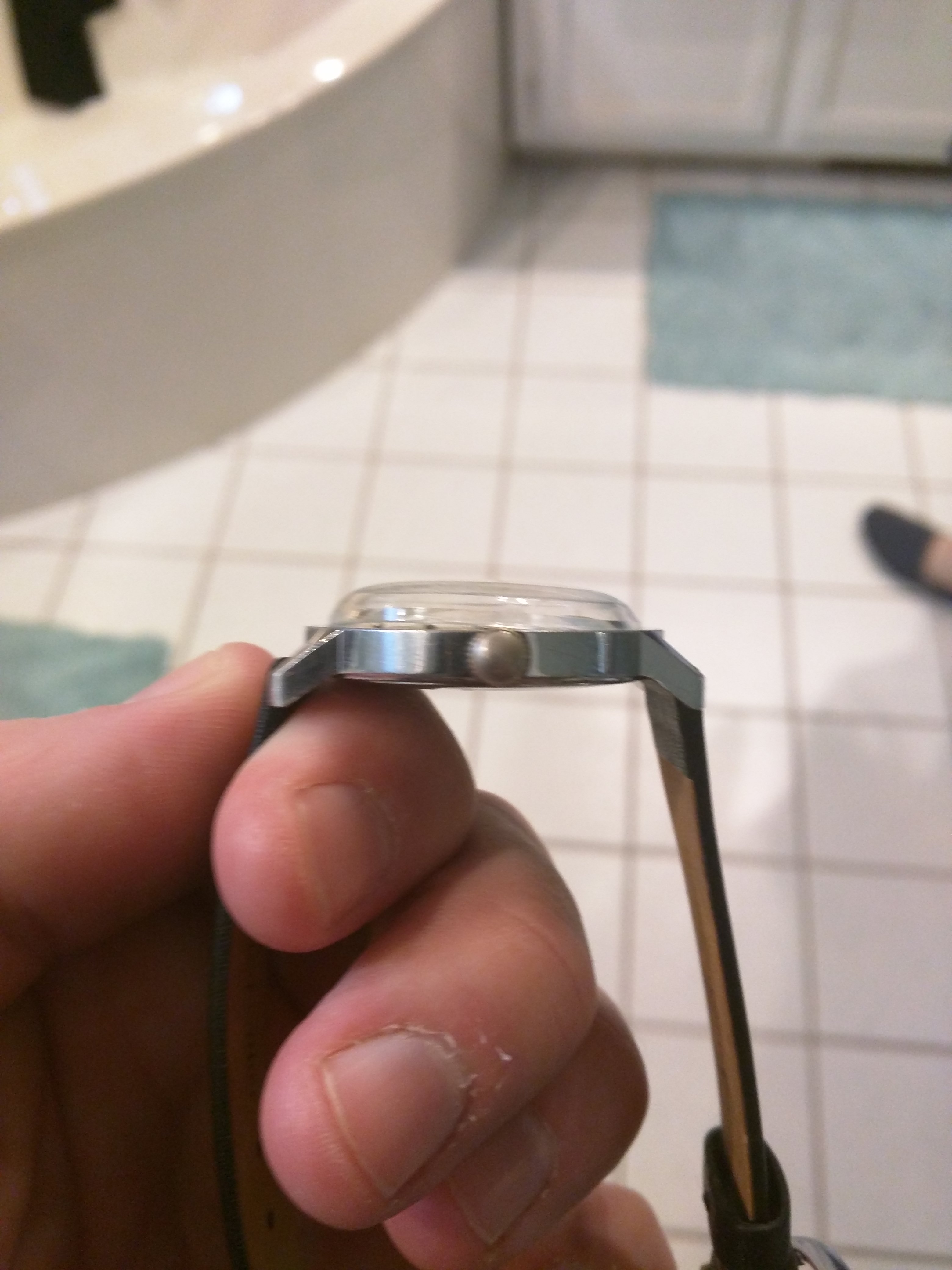

Okay. . .so quick update. I have figured out that it snaps on, however, try as I may, I can only get it to snap in on 3 "sides". . .meaning a "corner" of the crystal just refuses to go in. Thoughts as to what to do?

You will need the correct tool to re-install the crystal. Post a pic

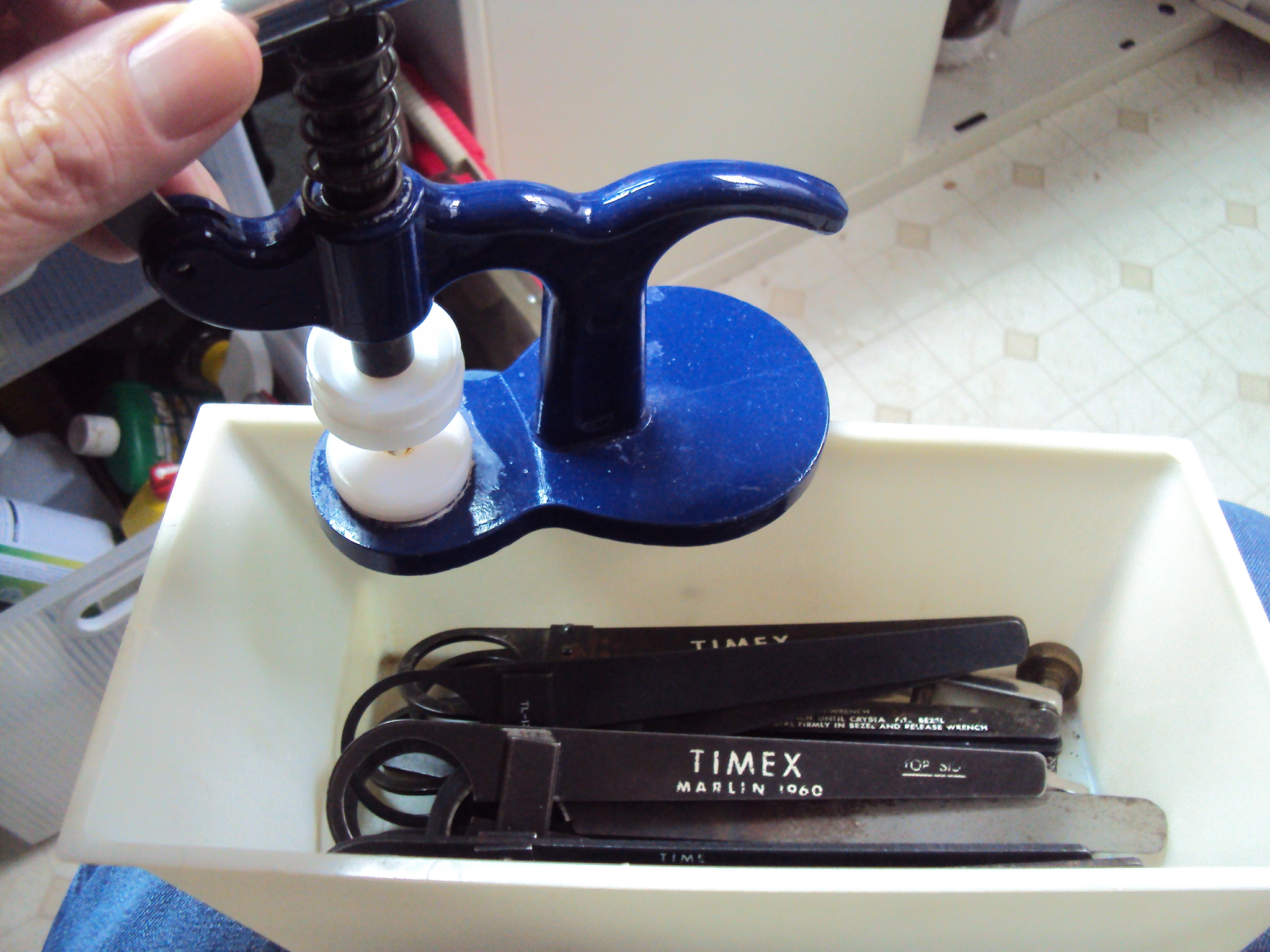

Most vintage Timex with round shape can be snapped back in as you are trying. But, there are those that will not.
For those you will need to use a crystal wrench or a press like these.-

You don't need any "Timex wrench". You need a blue crystal press like JerseyMo showed you above. These are easily and economically found on all the websites mentioned above.
