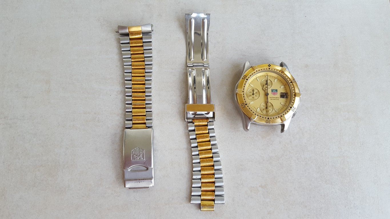

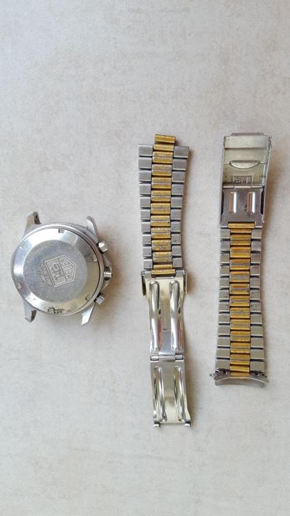

Hi Everyone. Quite new to all this so please bear with me!
Here I have a broken Tag Heuer 2000 Series Automatic Chronograph. 865.406
I opened up the back of the watch and it has the Lemania LWO 283 auto module coupled with an ETA 2892-2 movement.
It's been in a draw for a more than a decade after it fell off the bedside cabinet onto the ceramic tile floor.
As a result of the fall, it would not wind up automatically and  the crown and stem would not pull out to allow the date / hands to be adjusted. I foolishly applied excessive force pulling it and the crown and stem came away from the watch.
As this point I put it away in the draw and forgot about it. It caught my eye the other day and decided it was time to try and get it working again, at which point I found and studied Marks 4 part vid on the eta 2892 movement.
Here she is:
20180615_171227.thumb.jpg.47b346b1e2451b6374fba09d450a7472.jpg20180615_171313.thumb.jpg.23b5bc0b281a04333e5c03d54c5f09f1.jpg
The inner side of the strap has corroded. Tag do a very nice brown leather strap for these, I will probably buy one.
Also the back cover and the body need a good polish, I wonder if that is something I can do myself?

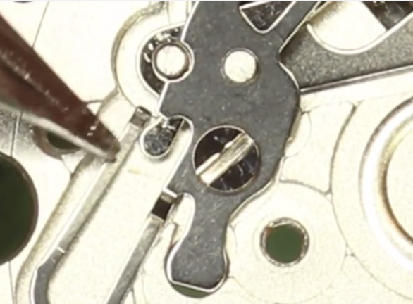

I've then flipped it over to try and get at the setting lever mechanism which is where I suspect problems are. I was able to remove the "minute train bridge" but the screw shown in the pic below will not budge.
Can I ask is this screw a regular right hand thread? I have ordered some smaller screw drivers as I think the 1mm I was using was not getting much purchase.
Is this your first watch you have serviced?
If it is you may be over reaching a bit.
I would suggest keeping it safe and buy a few 'ebay specials' and try your hand at them first, this is quiet a complicated watch and I still wouldnt touch it even though I have been studying watch repair for the last 2 1/2 years
Since it appears that you never worked on watches before, I absolutely recommend that you will not try to repair your valuable watch by yourself. There are really too many chances to do even more serious damage than what it has already.
Hi Ricardo, I wish that you had taken the advice of jdm. Well, it is your watch so go carefully with plenty of mechanical sympathy. Best fix some cheap watches at first to get the practice and know how. good wishes, Mike.
