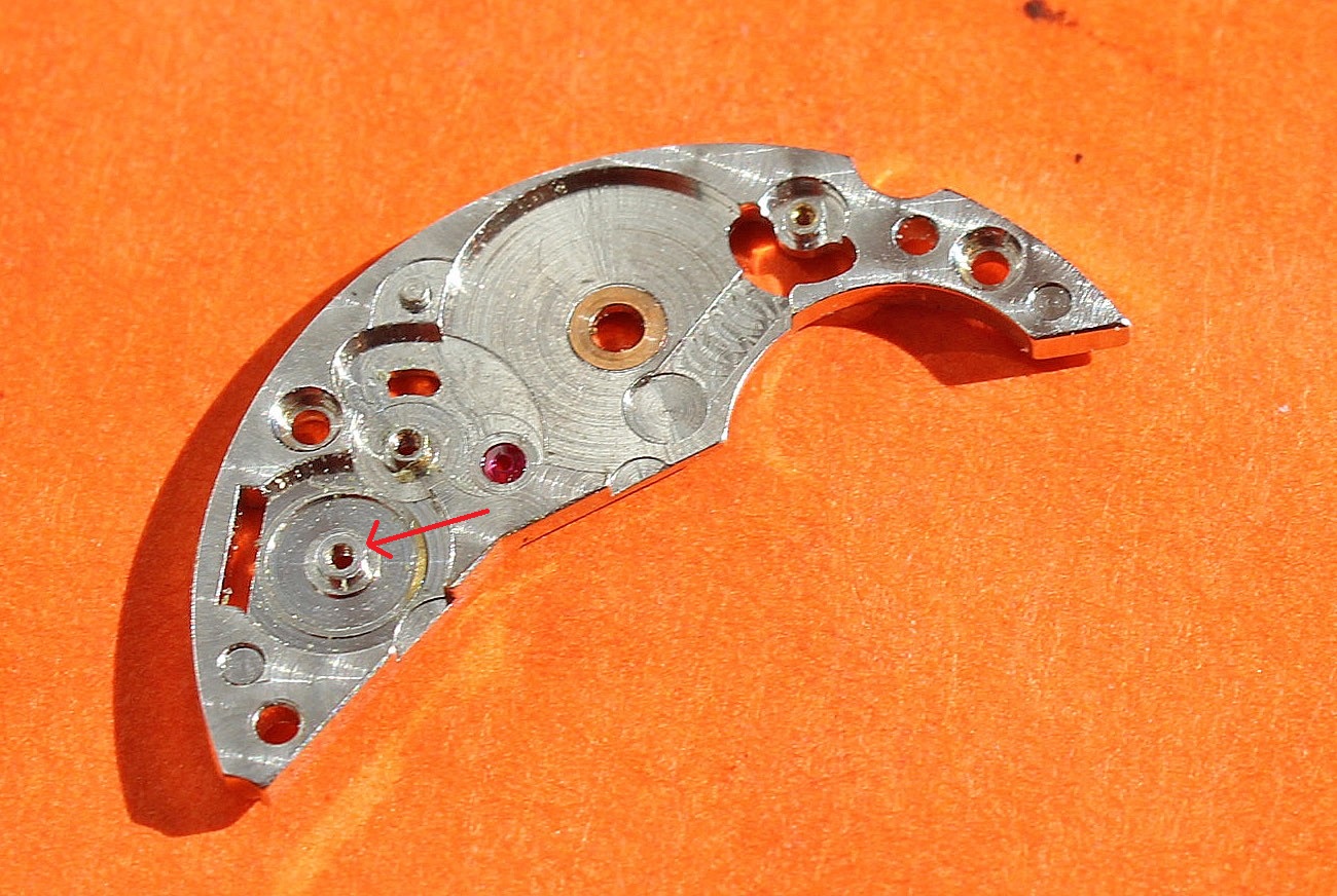

Are you sure you have the little coller in some watchers that goes here.
I learned about the existence of this part after cleaning a Wittnauer automatic and having it appear, like magic, at the bottom of the parts container. I now know where it goes, as I have seen it on a few AS movements over the past couple of months. If you're not aware of it, it's easily missed, as it appears to be part of the bridge. At least it did to me. Good luck.
