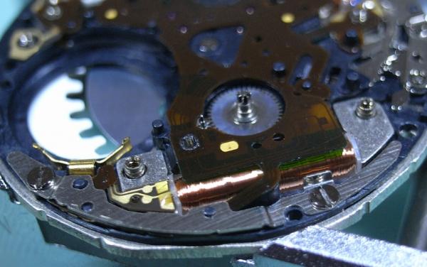

Remove Circuit Block
NOTE: The pin with the yellow arrow pointing to it holds onto the Circuit Block very firmly.  Be CAREFULLY and GENTLE, as the Circuit Block can be easily damaged.
This is the angle of attack that I recommend. Coming in on an angle just in front of the Crystal Unit, and gently push upwards ... and I mean GENTLY.  Patience wins the day!

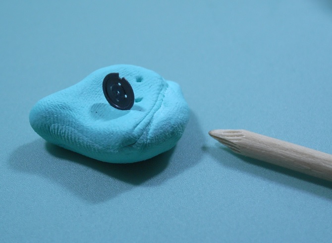

TIP: Next is this first of three sets of Stators and Rotors that make up this Quartz Movement.
Be sure to place all the Stators and Rotors into a piece of Rodico for safe keeping.
As shown below:
THESE PARTS ARE MAGNETIC AND WILL ATTRACT PARTICLES, SO DO NOT PUT INTO THE BASKET FOR CLEANING

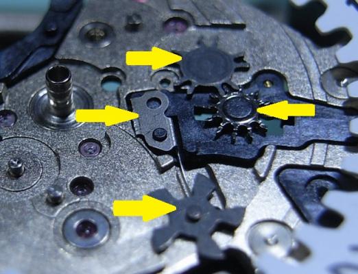

Remove the Minute Wheel and Pinion, Intermediate Minute Wheel, and Setting Wheel
Remove the Center Wheel and Pinion
Remove the Generating Stator and Generating Rotor

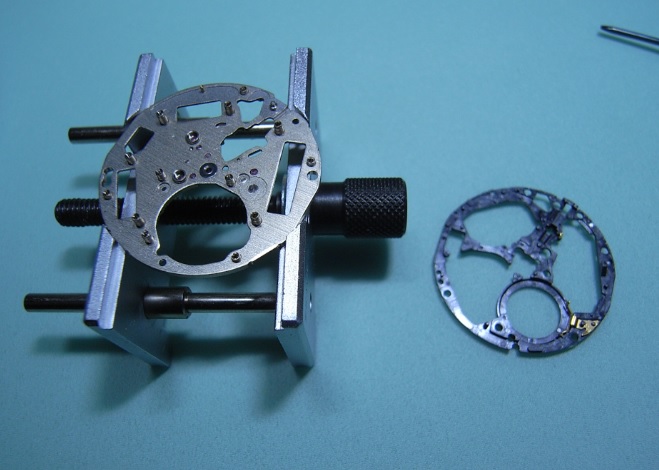

This side of the Main Plate is now finished ... time to flip it over and start on the Calendar Works
Remove the two screws indicated and remove the Hour Wheel Guard Spring, and the Date Dial Guard

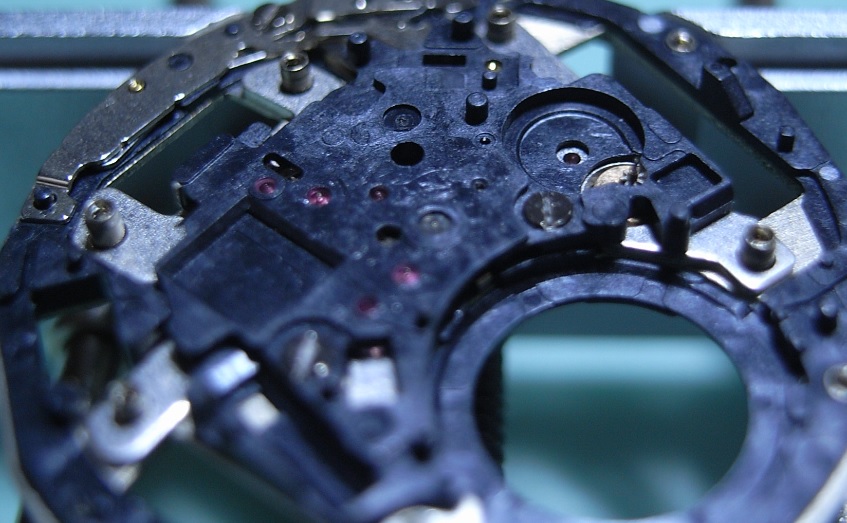

Remove the Circuit Block Spacer

Place the Circuit Block Spacer onto the Main Plate

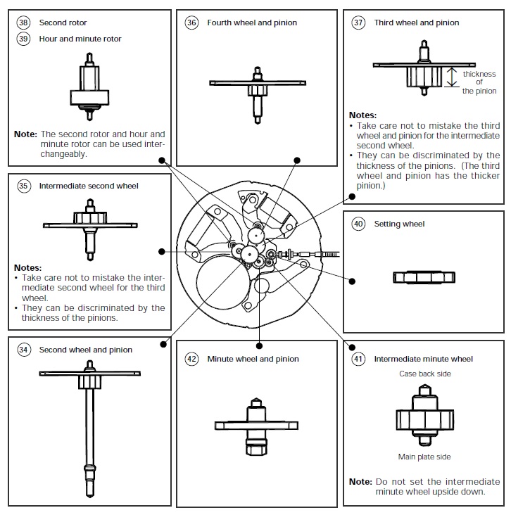

Next is the Train and Motion Work, it is by far the hardest part of the assembly.  It is all housed under one plastic bridge, so to make it easier here is a location chart.
First the Motion Work - Setting Wheel, Intermediate Minute Wheel, Minute Wheel and Pinion
Slide the Center Wheel and Pinion in the affix the Spacer
Then add the Train - Third Wheel and Pinion, Intermediate Second Wheel, Fourth Wheel and Pinion, Second Wheel and Pinion
Place the Train Bridge on and locate all the gears into their jewel holes.

I have one question, any particular reason why the magnetized parts can't go in the cleaner? Thank you in advance.
They will attract any of fine metallic particles in your washing liquid, much like the old magnetized sump plugs in cars.
I see, thank you Lawson that makes sense. Therefore in a mechanical watch it should be demagnetized first before cleaning/servicing just for the same reasons! Excellent!
