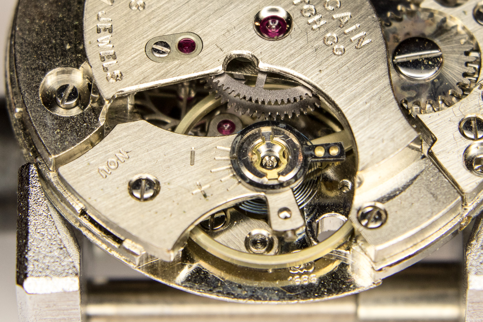

Here we go. First of all I removed the coverstone from the balance cock and removed the balance assembly.
Then I removed the anchor bridge and anchor.
Next the bridge for the fourth wheel that carries the second hand in the center. In this design the fourth wheel is directly driven my the escape wheel.

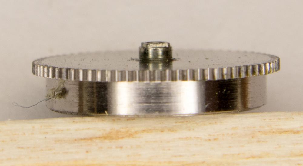

I noticed that the balance worked less well after the movement was fully wound. When I looked at the mainspring barrel I first noticed considerable dirt. After a closer look I also noticed that the cover was not fully pressed in the barrel. I am not sure if this is by design but I doubt that.
I decided to disassemble the barrel for cleaning and inspection:
It is pretty evident, that cleaning and lubricating is mandatory.

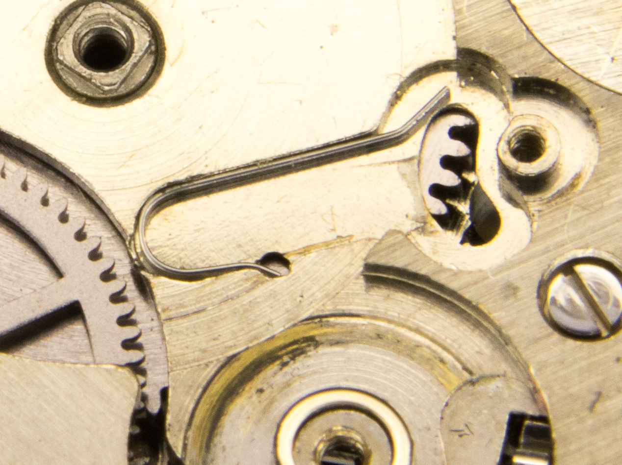

The first thing I usually to is reinstalling the setting lever with the setting lever screw. I place the setting lever on the plate and fix both parts with Rodico. Inserting the screw is pretty easy.

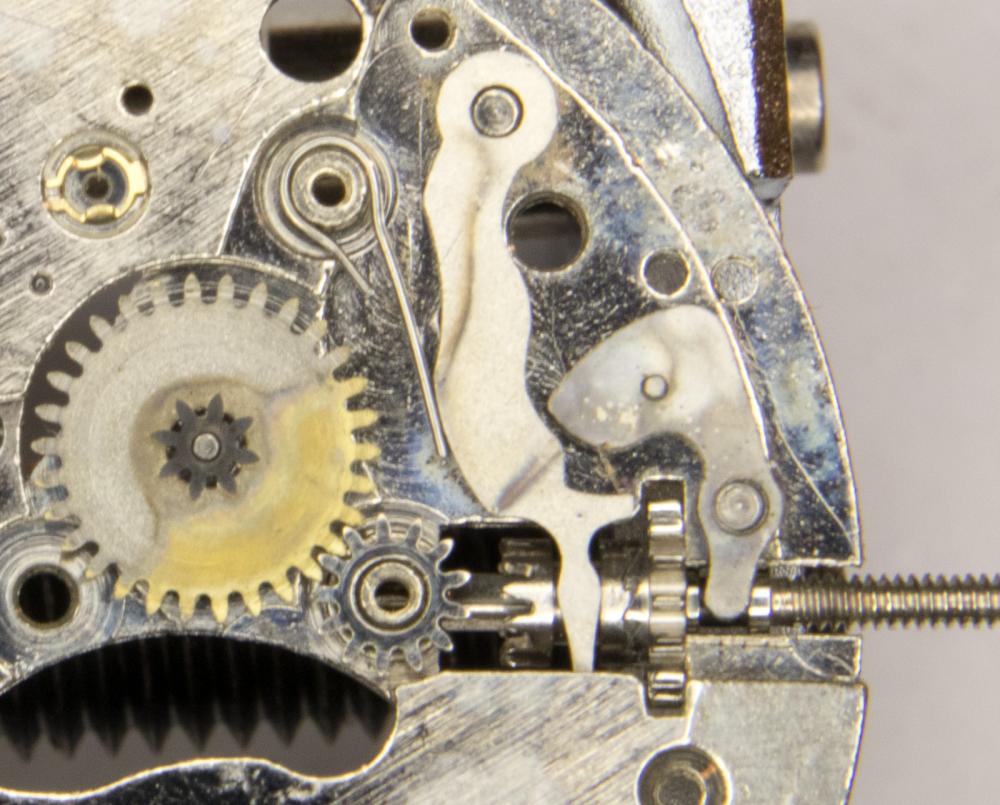

Next: Keyless work. Pretty straight forward. Nothing special. Besides the fact that I misplaced the yoke first. It has to fit in the groove in the plate.
This was the wrong way:
Had to take it apart again and redo it. The next pictures show the final result.

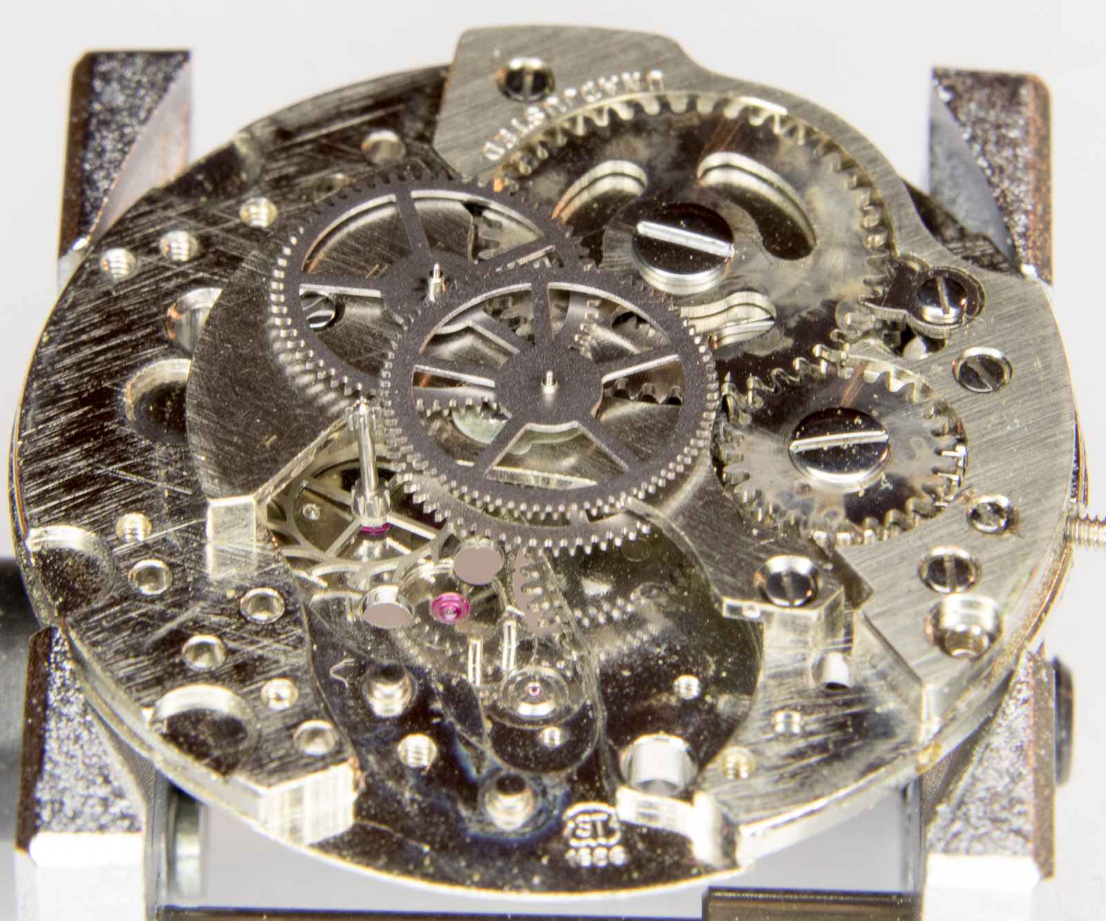

The rest went pretty fast and well. I didn't take a picture of each assembly step, since I documented the disassembly well.
The result was a success! When I got the watch, the movement stopped from time to time. At one point prior to service she did not run at all. This was what the seller described.
After cleaning and proper lubrication (I use Moebius D5, 9010, 941 (pallets), 8212 (mainspring), and 9501) the movement behaves quite well for it's age between 40 and 50 years, maybe even older.

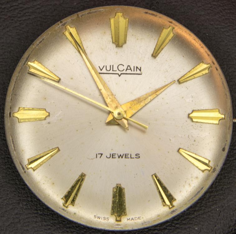

Next steps will be cleaning the watch as good as possible. I will clean the dial only very carefully, using no solvents whatsoever. I will just remove the dirt carefully with a pegwood.

I now cleaned the dial very carefully. I became soon evident, that I would not be able to do too much. I carefully used a pegwood to remove the worst dirt.
Before:
After:
If the laquer on the dial allows, you can try some demineraluzed water on a q-tip. Cousins also sell finer sticks. Unless it's corrosion from under the paint, in which case I don't think anything can be done.
Also, hands can be polished, there is some video on YouTube.
Thank you @jdm.
I will try demineralized water, however it seems to me that corrosion comes from under the paint. I won't mess around with it too much, since I will keep it. It she already looks much better, compared to the state I got it.
I'll look for the cousins Q-Tips.
