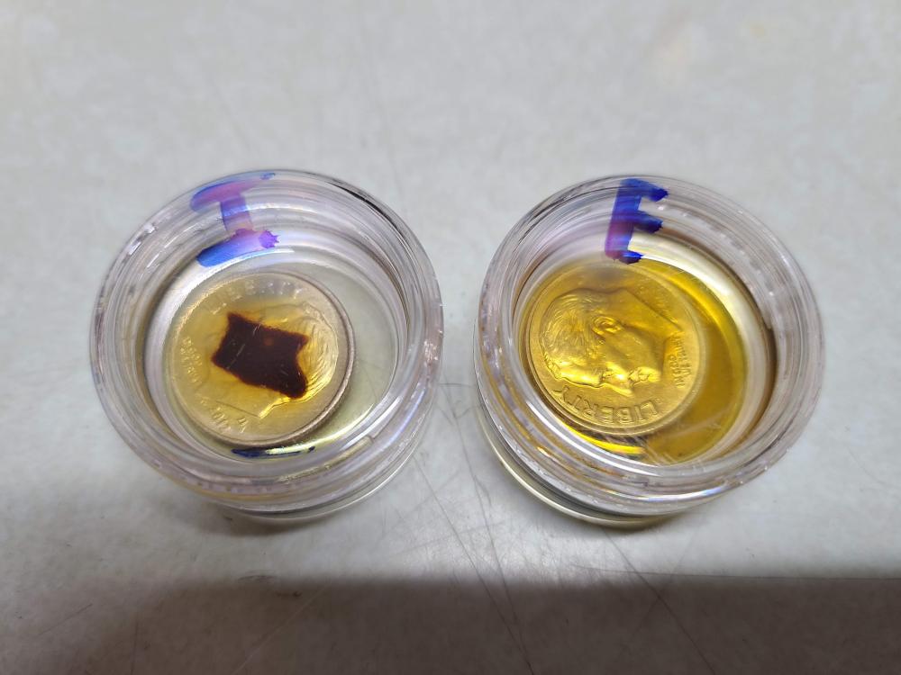

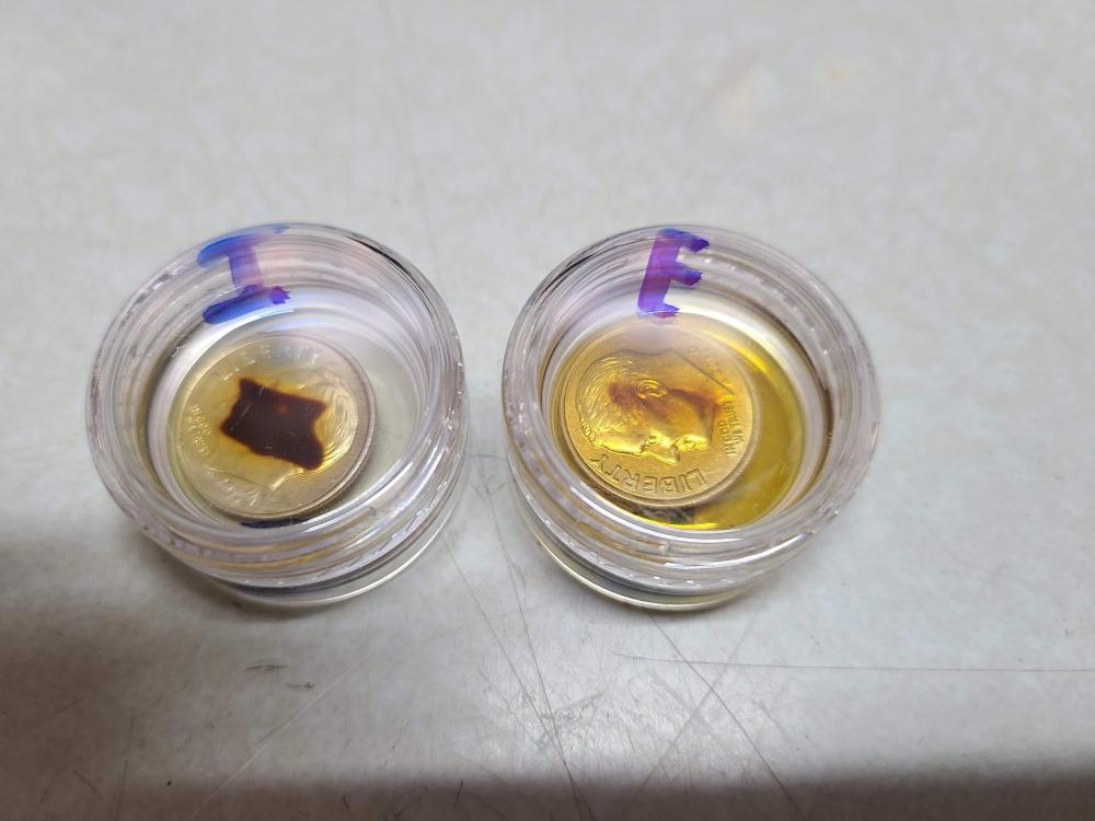

The experiment begins. Both dimes were heated to about 300c and then had a flake of garnet shellac laid on top. And then heated some more.
99% isopropyl on the left, denatured ethanol (containing up to 50% methanol) on the right.
The ethanol may have some percent of water because i have had the gallon can of it for i think a couple years now. I use it to fuel alcohol lamps because it burns clean, unlike iso.
The quantities of alcohol may be a little different but they are both immersed. These are 10g polystyrene lip balm containers i bought on ebay to hold small parts. They are reasonably air-tight when tightly closed but can then become hard to open. For acetone or limonene i would need to use some other container but i could do naphtha and odorless mineral spirits in these. I think we're all agreed that odorless mineral spirit aka stoddard solvent doesn't do anything to shellac, though.
These photos seem to show up in reverse order, but as expected inside a half hour the ethanol side is completely dissolved.
The isopropyl side is partially dissolved but largely intact.
i'd say isopropyl is probably not going to harm an impulse jewel setting or pallet stone in a brief rinse.
An extended, agitated rinse, is probably not a great idea.
Maybe next I'll see what happens in isopropyl in ultrasonic?
20220503_183216.thumb.jpg.0d6e4602dd0087bb93f84199467af735.jpg20220503_182657.thumb.jpg.ae20ffb7073b39a055863a035ff010ff.jpg20220503_181536.thumb.jpg.8b6594f7ab65b13c1c412989a137747f.jpg
1 hour ago, TimpanogosSlim said:
After 3 hours and 20-some minutes, the shellac in isopropyl is almost completely dissolved.
So yeah, absolutely it does dissolve shellac, just not near as fast.
