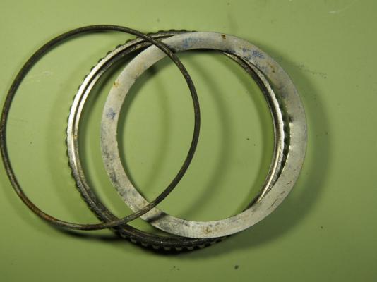

The bezel on this one is free so it will come off no problem. I have freed stuck bezels by simply dropping out the movement and dumping the whole case in some releasing oil for a day or so. Then I dry it a bit and lay it bezel side down onto a nice piece of “grippy rubber that I have, lay some weight on it through the heel of your hand and twist it in jerking movements to and fro. The lugs are quite sharp so protect your hand with a glove or something Really stubborn ones can be a pain but you just have to be a bit more brutal in your method. There is a notch in the case to allow you to prise the bezel off.
With the bezel off you can remove the bezel insert, shim and o ring.

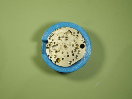

Well worth getting is a holder like this. I had difficulty securing the movement in my holder. I was recommended to use these as made by Halo8. He is on the bay and made one specially to fit the 4205 when I asked him about it. I bought a few more of the most popular sizes while I was at it and they are great.
  • Like 5

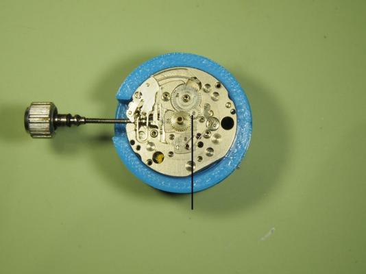

Here it is in the holder, it does make a big difference. I like to leave the stem in place to check things as it comes apart. The first thing I take out of harms way is the balance, just one of the lessons I learned the hard way.
It is worth checking that the autowind works ok before taking off the rotor, I just spin it around a few times with a cocktail stick and make sure the ratchet wheel is turning.
Do take the balance out first, as if you do slip while turning the rotor you can bet the first thing that get’s it is the balance. So better safe than sorry.

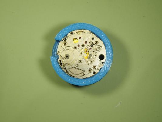

In order to let the mainspring down you need to remove the three small screws that secure the rotor bearing assembly, keep an eye on the pawl lever as you lift things away as they can spring off. The pawl lever grips the transmission wheel and you can’t let the spring down until it is removed. The screw that hold the transmission wheel is left hand thread. The mainspring can now be let down. I gently ease the ratchet wheel back slightly with my finger and then carefully hold the click out with my trusty needle and slowly allow the spring to unwind.
I am pointing out the date wheel finger. If you find that the date will not change as you wind the hands through past midnight this finger can be the culprit.
If you see the date wheel trying to move but not quite making it, you might find that this is worn. The little finger on the right wears and is then not quite long enough to flick the date ring around. It’s a poor idea if you ask me, there is not much of it to start with.
What I decided to do was just to try and nip the end with a pair of strongish tweezers and tease a bit more length out of the plastic. It did work, but obviously it will fail again sometime. But unless you have the luxury of a spare movement there is little else you can do.

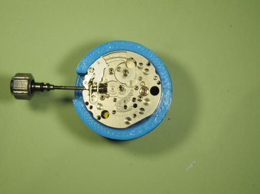

At the beginning I mentioned that sometimes the winding mechanism might not feel right, you might get a few turns of the crown and then it goes loose then winds again.
Given the age of these things by now there must be considerable wear and some of the gears in the winding mechanism are well worn
I found that the winding pinion on the stem was not contacting the sliding crown on the winding bridge very well, it was tending to lie to one side and flop about. So what I did was to bend the spring that you can see inside the black box so that it puts more tension on the sliding crown and it seemed to keep things engaged a bit more positively. It’s easier to do this once spring has been removed.
Take off the winding bridge and it’s almost there.

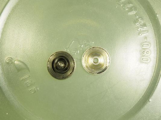

The barrel and spring.
And the spring is removed.

Could you measure mainspring and barrel? Cousins had the barrel complete but the spring alone could help old movements anyway.
Yes I can do that, but I am gasping for a cuppa right now :)
I imagine you need the height and thickness of the spring. What other dimensions do you need?
MS go by height, thickness (strength), and length - for which you use best approximation. Plus barrel I.D. - I don't know why.
I have measured the barrel and spring.
The barrel ID is 7.0mm
Spring. H=1.08 / Thickness=0.07 / Length=245mm give or take a few mm.
