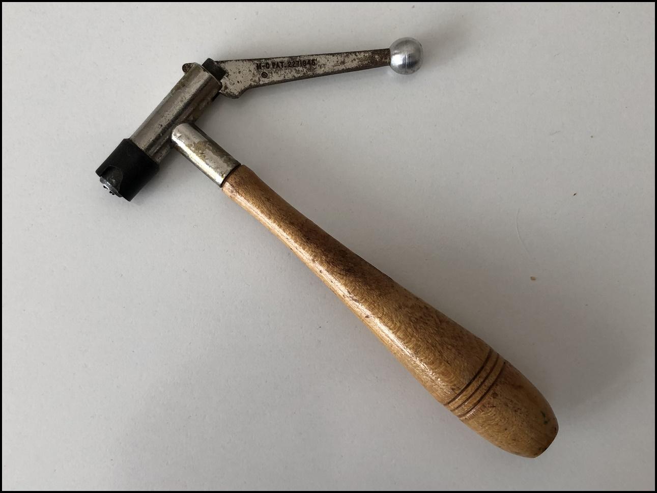

Yes, my "antique" tool (if it qualifies as such!?) really can't compare to the other examples in this thread, but I always feel happy when I get to bring it out and use it. I picture how its previous owner (or owners) lifted off hundreds—perhaps even thousands—of cannon pinions, and I hope it will continue to live on long after I've left this world.
25 minutes ago, VWatchie said:
cannon pinions
I keep holding out hope that the hype will die down (thanks, Very Popular Youtube Guy) and the typical prices of these will fall from $120 USD down below $50, and then I will try to buy one. Or maybe I'll spot one in a random unlabeled tool lot at auction that is well hidden enough that no one else notices it and I can get the lot at a low price.
(P.S. I blame Very Popular Youtube Guy because it's common on reddit to find hobbyists unveiling their brand new lot of essential starter screwdrivers, tweezers, and Bergeon case cushion, and including a vintage cannon pinion remover)
I'm the only one with one of these that I know of here. I use it on every watch (that doesn't have the pin through the center wheel)- and it gets borrowed aaaalll the time. It's a shame the new ones are essentially worthless.
The first one I got was a brand new Bergeon, and to make a long story short, it was, essentially, a piece of cr-p! The vintage shown in the picture removes every (tiny or large) cannon pinion with ease and precision. I'll never get rid of it (unless my children are starving).
