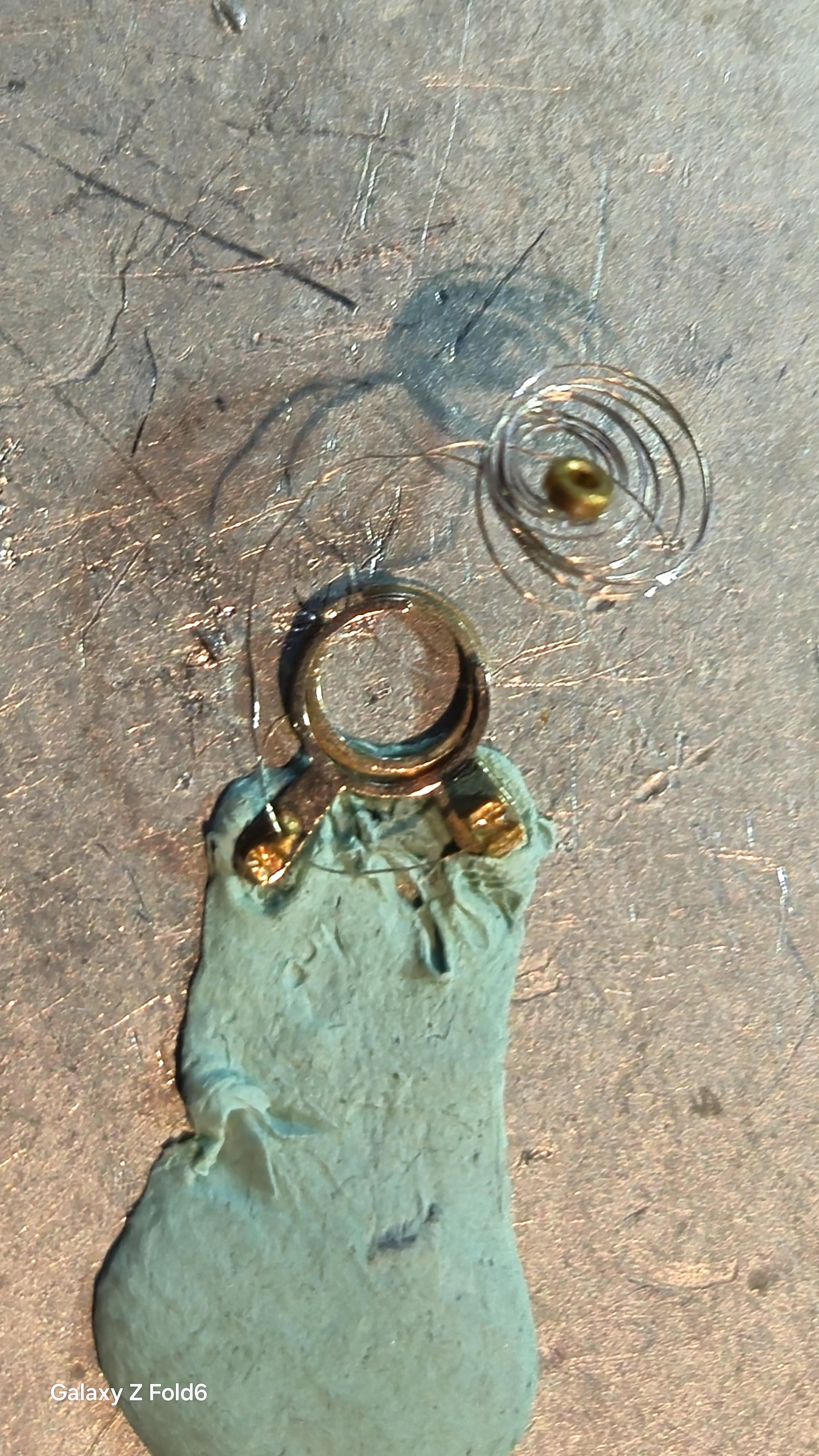

Thanks for the interest! Here's the position after phase 1: the HS seems to be shellacted into the stud & I didn't want to get into removing & re-attaching it; also I couldn't move the boot on the regulator to release the HS. Hence the arrangement at the outer end of the HS shown in the photo which gets these parts out of the way.
After trying to undo the tangle around the collet for an hour or so I decided the only option would be undo the whole HS from the outer end & I'm now at the last stage of that having worked back to the final few coils around the collet.....
Update: having this HS to practice on has taught me:
1. that after working for about an hour, I suffer from the equivalent of the golfer's 'Yips', those involuntary twitches which cause one to miss the 'target': in the present case that being a smooth 'bend' in the HS. Taking breaks is therefore important & doing so is also a reminder/opportunity to re-dress the tweezers which is, this practice has reminded me, time well spent
2. that I lack the degree of wrist articulation required to make vertical adjustments effectively.
What I intend to do now is to spend a little time in each session at the bench doing a little tweaking of this sacrificial HS in the hope of improving my technique as well as 'keeping my hand in' for when I have to work on a salvageable HS.
I've often wondered about making some die-jawed tweezers to facilitate HS work & I now think such a tool could ameliorate the problems caused by the 'Yips' so I hope to find time to explore that possibility.

Thank you for sharing your tips, Hector. I'll certainly try the slab of glass. Re wrist & finger support, my problem is not so much tremors as involuntary jerks - hence the putting analogy! I also tend to use one pair of tweezers but with an old, very fine oiler. But as I inrimated it's getting the HS to lie in one plane that I find most difficult......

Yes: I'd actually realised that the contact angle could have such a complicating effect & am careful to check the angle of the tweezers before gripping the spring. In particular, I rotate the work surface so that the tangent at the point of the spring I intend to hold is pointing along my line of sight: this has helped me to correct/avoid introducing vertical divergence which I find the most annoying issue!
This is going to be my little “things to do when I’ve nothing else to do” projects. And yes, that’s a 5 pence piece!!
