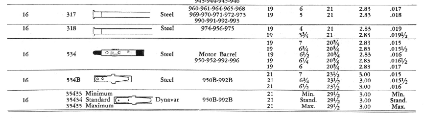

So let's assume that the 999B is based on the Hamilton 992B which also brings up an interesting problem of which mainspring? Oh I suppose I should elaborate there are actually two separate mainsprings for the 992B the standard one that everybody uses or the modern alloy that is slightly longer in addition to being slightly better. They end up with almost a 50 hour run time versus a shorter run time and much much better timekeeping as well as peculiar places where to mainsprings exist that the length is different which normally wouldn't occur but does and no indication as to whether there was actually a different barrel to accommodated because doesn't appear to be. But we can assume that the 999B which is supposed been improvement of the 992B That ideally the longer spring would be preferred.
I snipped out an image notice that the 992 uses either the number 317 which is a T end spring at 2.83 mm width or the 534 with its interesting end but still the same width of 2.83 versus the same end for the 992B which is some form of brace type end at 3 mm. Which is why the description of the tool for mainspring is interesting because it doesn't seem to take into account that there is a difference of with some of the various 992's.
Then looking at another reference it looks like the tool for is the correct spring if you're replacing the steel spring and you're not concerned about the extra running time and that is providing of the whole of the barrel will accommodate this as we didn't get see the end of the spring but I'm just guessing. Oh and I'm also guessing that whoever put the spring In previously had no idea what they were doing which is why it's the wrong spring.

@JohnR725 that's very helpful.  The one I pulled out is a T end.  I was able to find a MS on ebay that matches the measurements of the 317 from your chart (except for 1/4 inch longer), although that 60 hour spring from ebay you mentioned would have been cool.  Just before hitting the "buy now" button I tried tweaking my MS end again and voila I got it to catch and hold onto the arbor and actually got the watch running--which goes to show that even I can't screw up the quality of a good Ball RR grade PW.  So before I order the MS I'm going to test it out with the current one.  I'm taking it apart again to get off some more of the rust and corrosion I found.  I didn't want to spend too much time doing that unless and until I knew I could get it running.  The watch was surely abused.  If it turns out alright I'll definitely keep it in my collection.  Thanks again to everyone that chimed in.

Of course the question is the one that you pulled out was a T end and we agreed it was wrong slid question is is that actually what goes in the barrel or is it the DB end as there is a difference let me get images.
The DB end is preferred over the T as it's a nice  the T part goes into a slot rather than a round hole In the brace Part holds it in place so it's unlikely to ever come out in other words is a much more secure.
This does bring up the interesting problem of the 999B which I thought was based on the 992B appears to have variations which is one of the problems of things based on things like the T end barrel seems a bit strange? Although the actual quote above was the original spring that was found in there was a T end and we never did see the barrel so maybe the barrel does have a slot.

It's amazing how many questions can be answered with one picture or may be two. Yes that is the correct barrel for Hamilton 992B Which your watch is based on unfortunately that is not the right mainspring.
