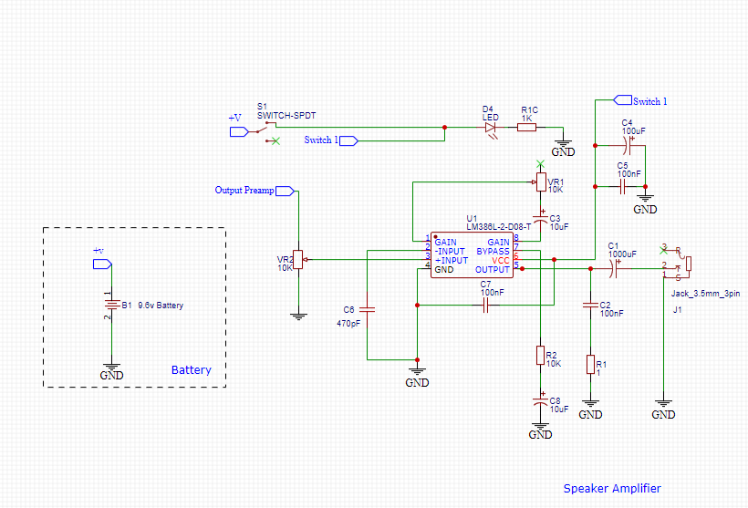

5 minutes ago, CWRNH said:
For fun here is an amp that can be used to drive a regular speaker from the WOS amp....
I need to check the values, after posting this I realized this may have a couple resistors wrong.  If anyone wants to build it message me and I will get you the correct values.
C7,C3: 47nF (maybe you meant to use 47nF and not 47pF in all instances)
R4: 10 ohm
C1 is not necessary
C8 is not necessary--short pin 2 to ground
C9: 10uF recommended on datasheet
R5  is not necessary, short it
The layout does not look correct w/r to C7-R4 but it is hard to tell for sure from picture.
TTFN...will look at it again in the morning.

Actually, I accidentally posted the wrong schematic.  The whole thing is wrong, I need to post the correct one, I will check over everything and repost.  SORRY!

Here is the correct schematic, I will update the PCB too.image.png.6d570b5ddf38f14f3becd38c08f8b61a.png

The original circuit I actually used to create this schematic was one I found on the web, I just modified it to use with the WOS.  The wrong schematic I posted earlier was one I was working on and never finished.  Somehow I must have deleted the good one so I had to make a new one (which is posted in the reply just above).  Now I will redraw the PCB to match the Schematic.  Then I will post the whole thing again for review..  The schematic in the post right above this one matches the working circuit I am using on a board at this time. I have too many files going, I need to delete or archive all the old ones so these types of mistakes are less likely.....
7 minutes ago, LittleWatchShop said:
Much better!  C6 is still unnecessary. C2 and R1 should follow data sheet recommendation.
Updated routing to match the schematic.  Not the greatest layout but should work...
So... Here are the updated speaker amp screen shots.  This should work fine but as LittleWatchShop pointed out, it is easier to just buy one from amazon...
The circuit below does work, probably should be updated as LittleWatchShop pointed out, but I am using the circuit on a board now and it preforms fine so far.  Mine is just not surface mount so obviously the layout is different on my working board but the schematic matches....
image.png.d1ef4c5f2f77c46e3496f1e7887c8545.pngimage.png.65fc276481a8159241c1fd5a45f67e9a.png
There is some coupling from pin 3 to pin 2. Pin 2 is connected to ground with an internal 50k and the external 470pF.  If it is not causing an issue for you then leave it.  I would guess the coupling is on the order of 10pF, so it is greatly attenuated by the 470pF, and it is a HP filter with a pole way beyond frequencies of interest...so...yeah...probably OK as is.
