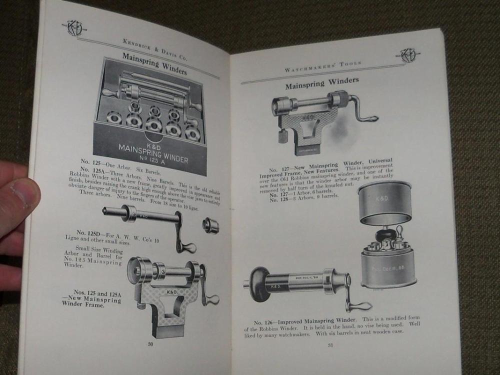

Then as I suspected I did track down A catalog page
You'll notice not a lot of information other than 18 size and down
You can find the catalog page here Along with a whole bunch of other catalog pages and the whole website covers mainly staking cents but it looks like the price lists covered everything
https://kanddinverto.weebly.com/k-and-d-catalog-of-watchmakers-tools-no-7.html

Initially, I was eyeing the K&D Robbins 126 on eBay. However, the high shipping costs and VAT made it less feasible for me. I also considered purchasing only the Bergeon sizes I needed from Cousins, that would be over £200 but then I realized I would be limited to just those sizes. That being said, I'll definitely keep Bergeon in mind and explore the possibility of acquiring a set similar to the one you mentioned in your description, perhaps like the K&D center one.
I think this is the way forward for me I am looking on EBAY daily.

My mission now will be to purchase a K&D set more than likely a 126,and take it from there.
Regards Dave.
