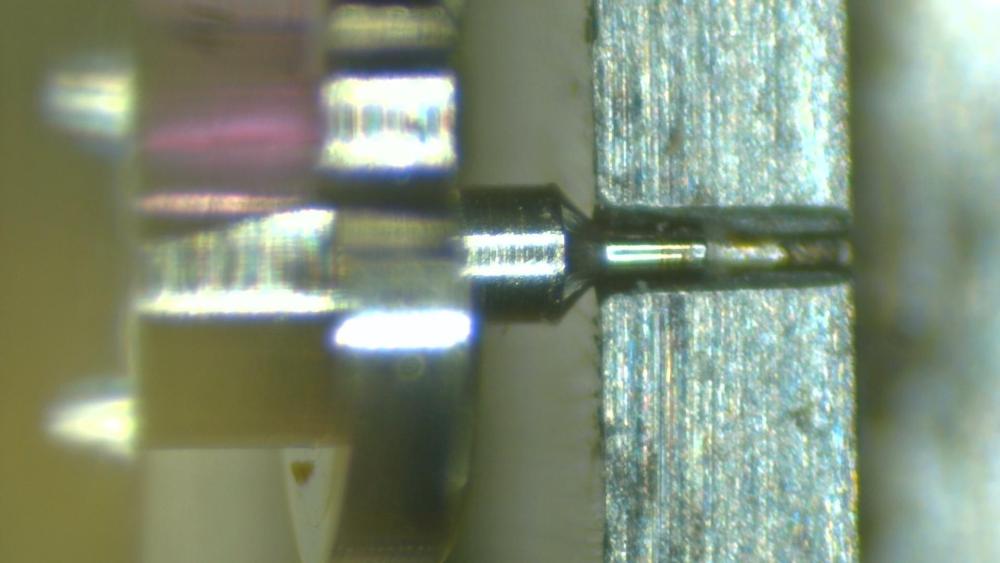

Reassembling my Longines 30L, I was expecting a nice high, and steady amplitude. My other Longines all behaved perfectly!
All the checks were passed, barrel+arbor, gear train, pallets, balance etc - all look good, yet it's barely running 😟
I thought I'd put a bigger lens on the microscope and have a look at the balance pivots. The top looks like it could do with a clean.
I know that pivots are sometimes flatter to reduce the difference between horizontal and vertical running,  but do these pivots look too flat?
TOP :
BOTTOM :
How did the jewels look when you got it apart? The upper pivot looks a little worn, and almost like it has formed a bit of a burr around the tip. This could happen if they were super dry and it ran for quite some time in that condition. If it were mine I would give them a lick in the Jacot tool and round the ends slightly.
It is possible though that they were made flat. Some watches have flat pivots to help have closer amplitudes between flat and vertical, but rare to see on mid 20th century Swiss stuff.

It looks like it hasn't been apart much. It does look like it's run a long time dry.  There's small dimples in the cap jewels. I think I'll replace them as they are not coloured - They are clear and not easy to find in a cleaning fluid.

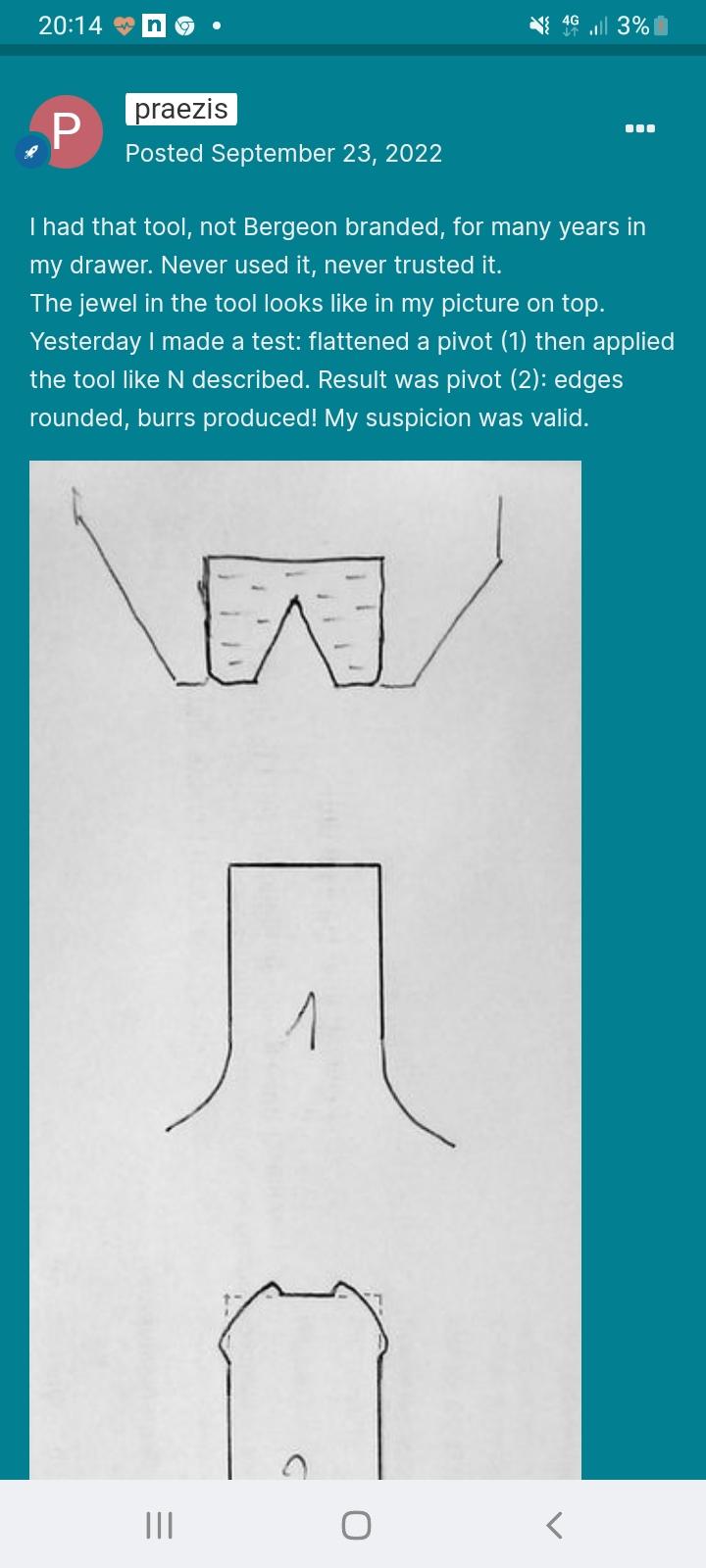

But there is a tool for rounding them
Exactly how round do the pivots get ?

Yes it looks nice and flat. But it be nice if you had a slightly different picture Like at an angle at the end of the pivots so we could see how it looks. Specifically not straight down a slight angle so we can see and look for why it is flat perhaps.
Just for you @JohnR725, I broke out the 2x Barlow lens - wow it's hard to get a steady picture with the microscope head on a long arm, attached to my desk, on a wooden floor.
The ends are very slightly rounded, but you can also see grooves where the pivots have worn away against the jewel holes (look at the reflected light lines). The pic is the bottom pivot, the top was more worn. I was thinking that a new staff would be best, when it was decided - adding a bit more pressure on the burnisher, the balance jumped out of the Jacot and broke the top pivot 🥴.  (Not the first time I've screwed up on the Jacot tool). Idiot.
I want this watch to run well, so it's probably a good thing to get a new balance staff. I'll change the jewels too. I don't know if jewel holes actually wear? But if it's worn away the pivots, then a paste of hardened steel has been rubbing on the jewel for a long time, so probably.
The cap jewels have slight dimples in from wear, and they are clear, not red. They're a nightmare to find in a liquid.

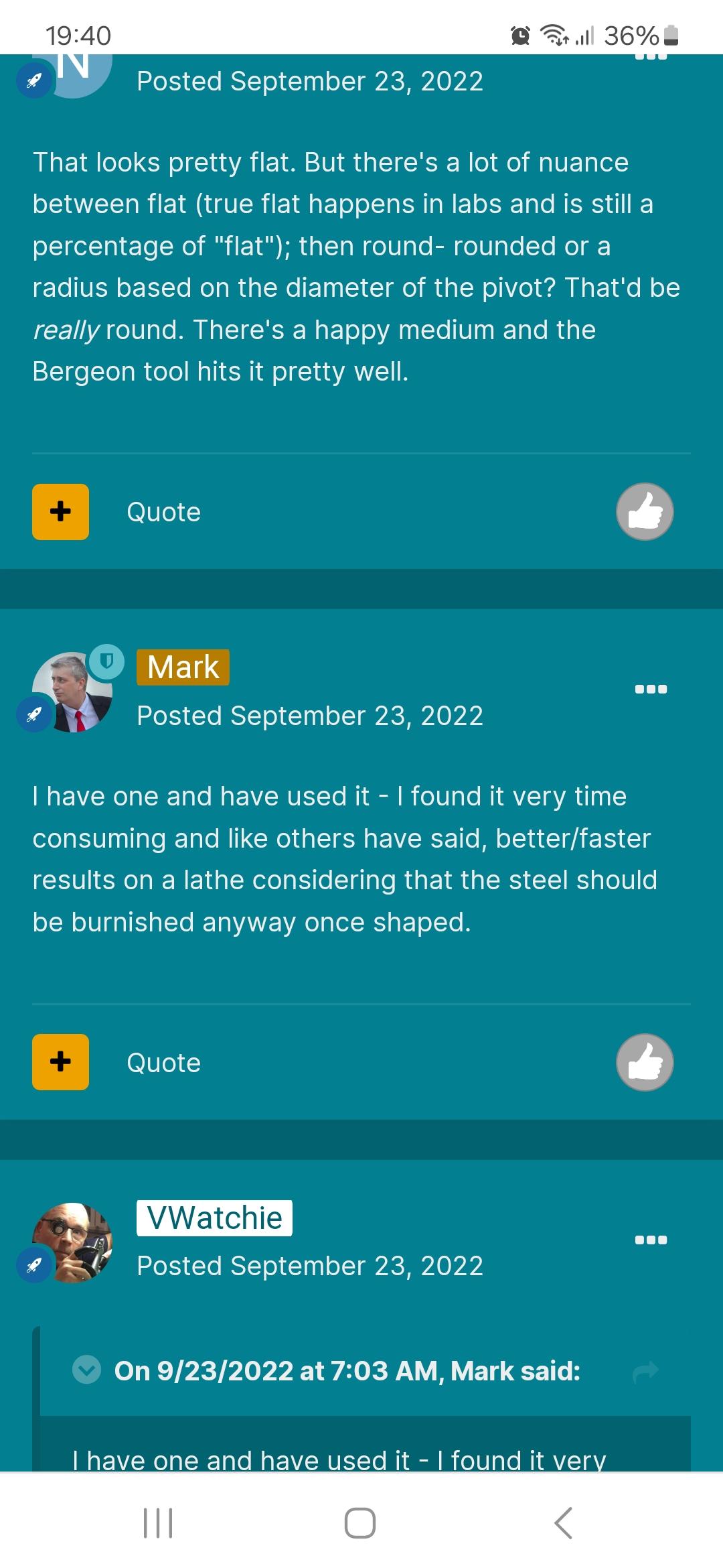

I have that Bergeon pivot rounding tool but I haven't had great results with it. In a recent video Kalle Slaap told he uses that exact tool for rounding so maybe I could have another try. Then again I have a jacot tool and I just made a rounding burnisher myself. Is it just my imagination or have the prices of jacots gone up a lot in ebay recently? I mean something that used to be 250 is now 400+ eur.
