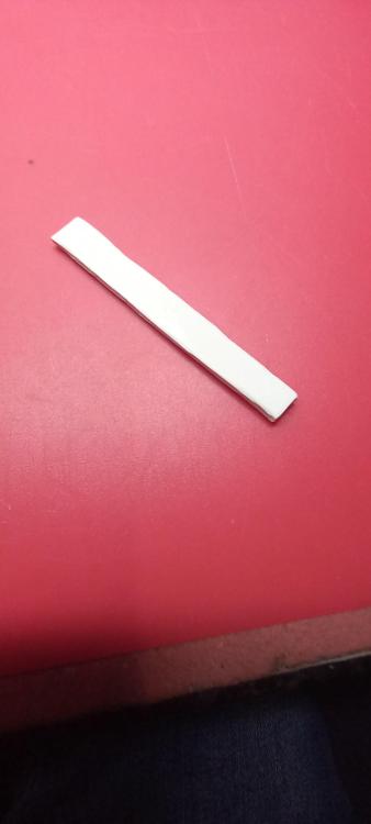

Hey Hector , i made some dough strips for dry cleaning . Thanks the tip it works amazingly 👍
