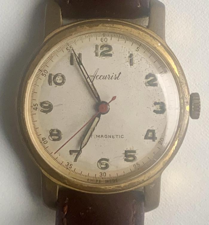

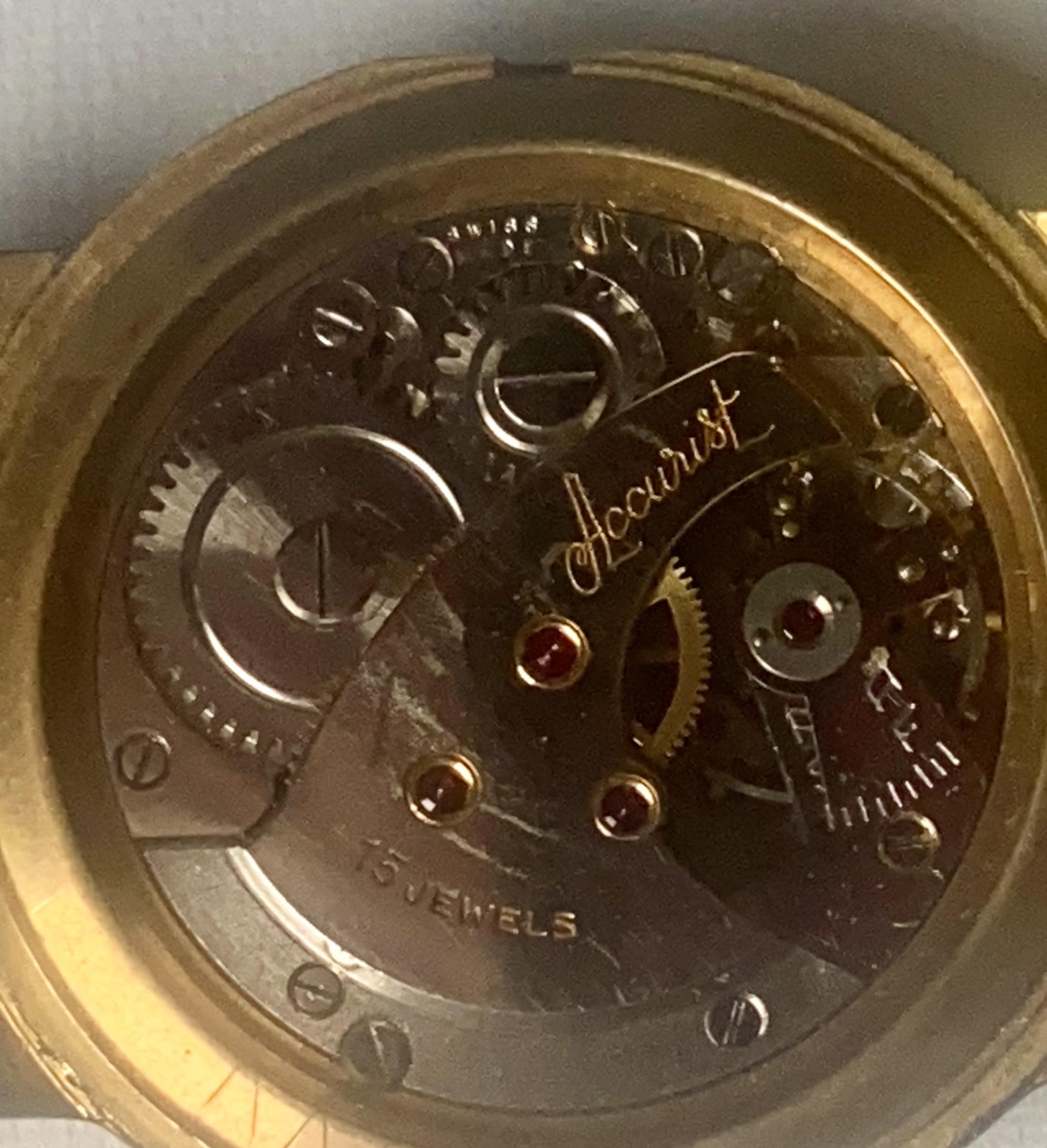

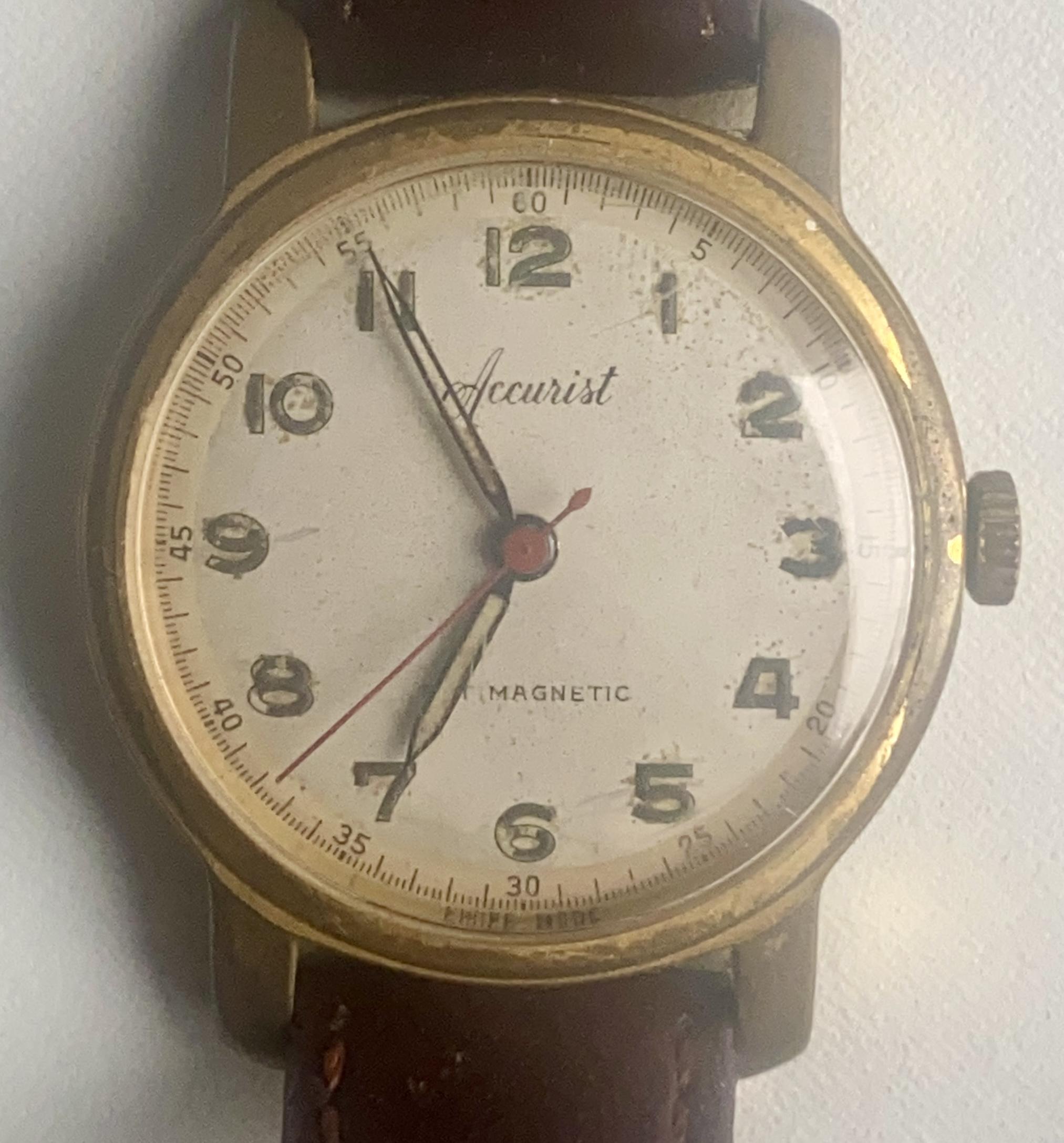

Fingers crossed you good folks will help me ID my father's Accurist watch.
It's history, long story short is ...
During WW2 my parents (both of whom were already married) had an affair and my mother gave Dad this watch that she bought second hand.
After the war they were both divorced and then remarried in 1952 (they took their time).
The watch was never very reliable despite being serviced at at some time the winder has come detatched.
I'm going to put this watch aside until my skills level is higher, so happy just to look at it and relish what it represents.
Thanks in advance.
Ian
IMG_6968.thumb.JPG.429d0005e60e713a248af337b20dfae7.JPGIMG_6979.thumb.JPG.ba820ee9e4fa32f30ca9918b4ca8b70e.JPG

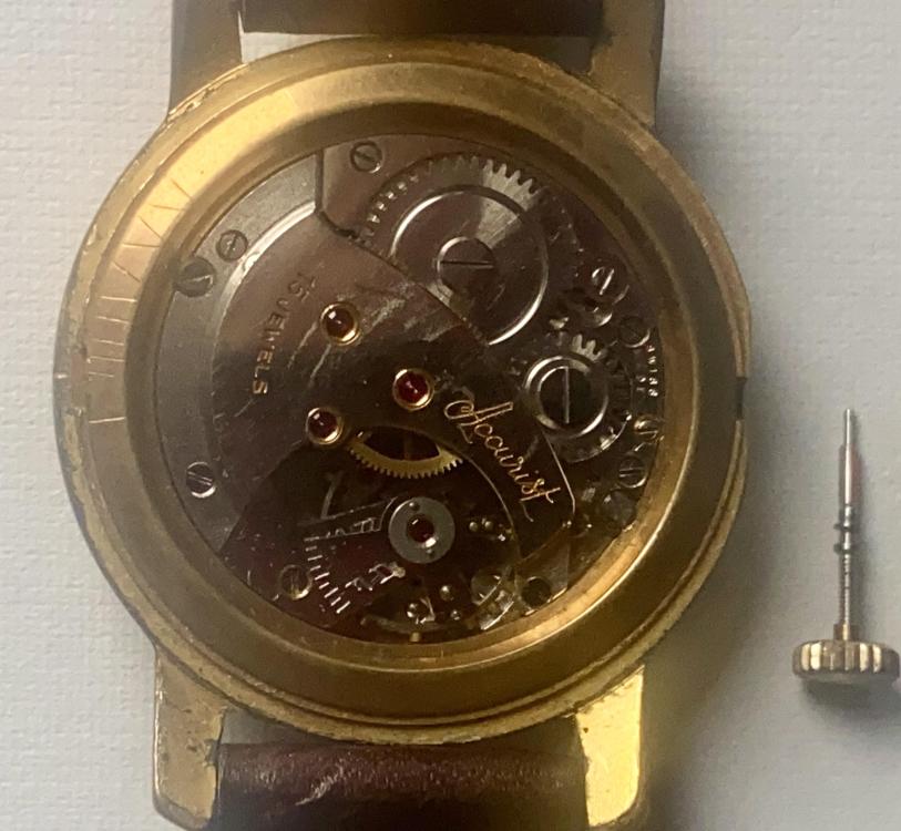

Can you see any lettering under the balance?
(BTW There looks to be a lot of flaking radium  from the dial and hands. So read the postings about the precautions you need to take before removing the movement)
Expand
Thanks for that.
All I can see is: 15
  On 12/4/2023 at 1:37 PM, Nucejoe said:
Check AS1194 and its variants on Dr ranffts site.
AS 1194 ranfft
We need a clear photo.
Rgds
Expand
Thanks, I've just had a quick look.
I'm afraid that is as clear a photo as I can take with my phone camera 😉

Check just under the balance wheel for a calibre number. Just had an Accurist As984 come through the post for parts for another watch's restoration.
Expand

You should be able to see the cal. no. without removing the balance, i will pop you a picture up later, of course there is no guarantee your watch is marked up jn the same way. Of course there is no guarantee with much in watch repair. Securing the stem ? That all depends on why it is not secure Ian, released with undue stress from its position or wrenched using excess force causing untold damage ?  Did i just say that for real 🙂

Mmmmm !
I seem to remember my father getting the stem mended and it being replaced with one that didn't quite fit.
I think it was always a case of carefully does it.
The stem looks complete and undamaged, I need to learn how it is retained.
Part of the problem is that it doesn't normally secure when reengaging after adjusting the time. The stem seems too short as the crown pushes against the casing.

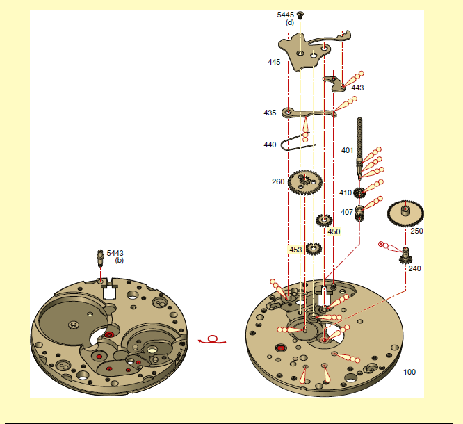

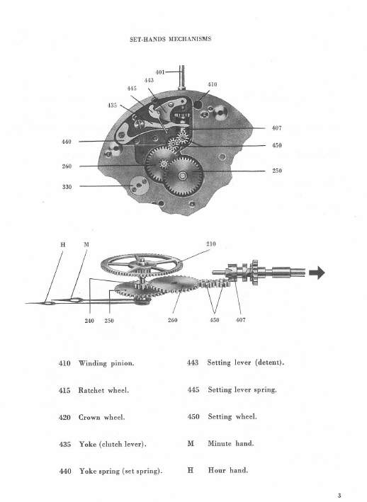

The stem is held in by what is known as a pull out piece, stem release bar and probably a few other names. In turn this bar is held in by a screw on the dial side. It could be that the previous repairer cut the stem short so it is not fully engaging the winding mechanism. Either way you will need to at least partly disassemble to fix it,  it will almost certainly need servicing, might be best waiting until you are more confident.  In the meantime lets identify what you have then you can get searching for a couple of donors to harvest spare parts from that you will need at some point, you then are at least prepared .
Expand
Excellent advice, much appreciated.

Thanks for the line drawing of the stem mechanism. I am now studying the pdf file by Wal Odets’ Glossary of watch parts and it’s starting to make sense. I love a challenge. I normally fettle steam engines so this is going to be somewhat “interesting” !
  On 12/4/2023 at 5:40 PM, Nucejoe said:
Resolution is good, insufficient light is the problem.
Its either a AS or FHF.
Expand
how do curiosity where did you get that picture from? I don't think I've ever seen the definition of pullout piece.
let's go with a different picture a Swiss picture with bonus numbers? What are those bonus numbers under the old Swiss parts numbering system all the parts had numbers it's a lot easier to put a number on a tiny package than it is to write several dozen words in various languages to describe apart so everything went by a part numbering system. so you're looking at part 443 which like everything else in watch repair is multiple names but the Swiss typically like setting lever.
as you're learning terminology and how watches work how about a tech sheet they typically tell people to start with this watch and will snip out a image from the tech sheets show it shows how the key listen supposed all come together including the setting lever screw. What's interesting with the unified whatever it's called part numbering system screws are almost an afterthought notice the number is much much bigger than the rest of the numbers.

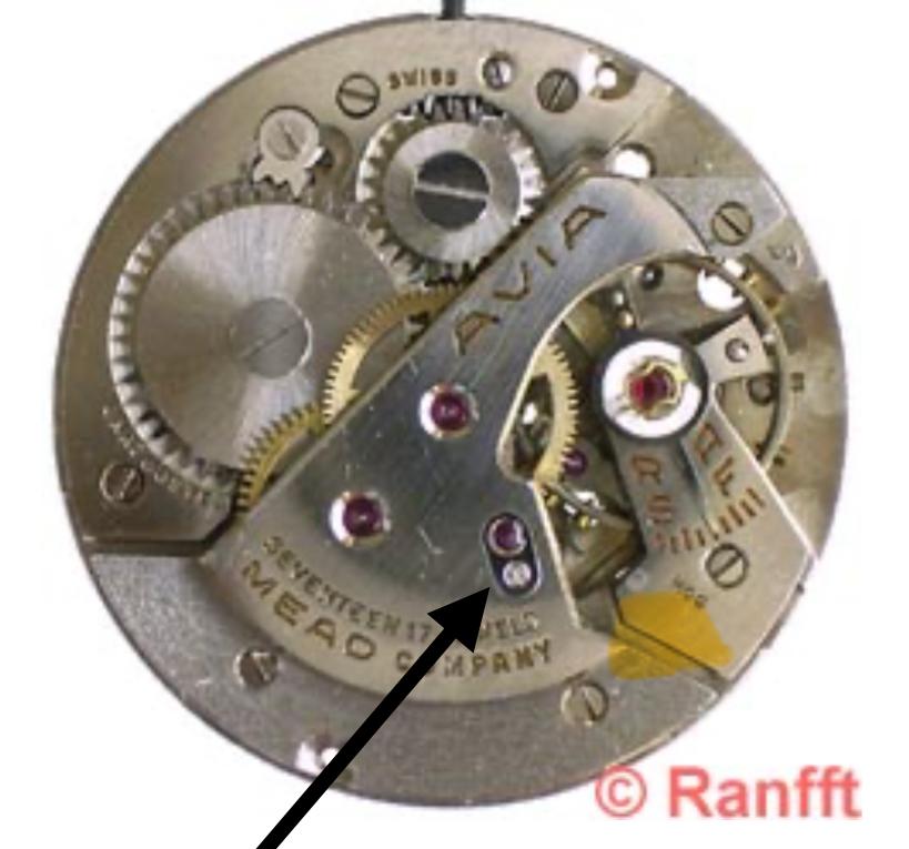

AS 1194 ranfft
Expand
out of curiosity why did we rule out 1194?
then from the images on the website at the link below it also shows why taken the dial off is good because often times as it shows in the picture they mark the movement number on the dial side plus the amusement with this watch it actually exists in two different sizes and away
http://www.ranfft.de/cgi-bin/bidfun-db.cgi?10&ranfft&0&2uswk&AS_1194

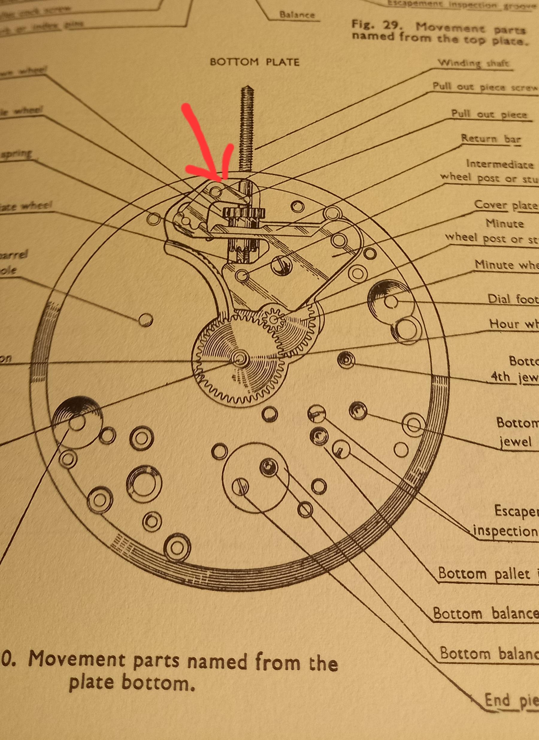

Well, bearing in mind that I know nothing, I’ve put an arrow on what I’ve noticed is different. Is this relevant ?

The keyless is idenitification card of movements.
Aparently your watch needs a full disassembly, good clean and lube, so you will eventually get to the keyless.
Then we'll have to see why set lever doesn't lock onto the stem as the stem sometimes comes out.
