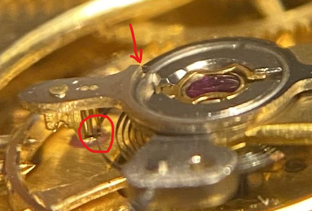

I am fairly new to watchrepair, having successfully ”repaired” 5-6 watches. I am currently working on a faulty Girard Perregaux Gyromatic and ran into a broken balance for the first time. I ordered a new one (complete balance) but probably didn’t install it perfectly.
Does any one know just by the chaos of the timegrapher what the problem could be?

I attached a picture of the movement.

I agree with the above. Close up pics of the balance at rest, from the top and side would be useful.
1 hour ago, Nucejoe said:
Regulator arm seems not fully snapped in place.
Well spotted @Nucejoe
You can see it not seated properly at the arrow.
As a result the hairspring does not sit between the regulator pins correctly. In the bottom pic you can see the hairspring going all the way through the pins, where it should be hidden by the boot for a portion
What effect will that have?
Wouldn't make regulating more precise, makes a mess of pin-boot slot.

Regulator arm is made of spring and snapps back in place.
Rgds
Update: I fixed the regulator arm and the readings looks somewhat better.
