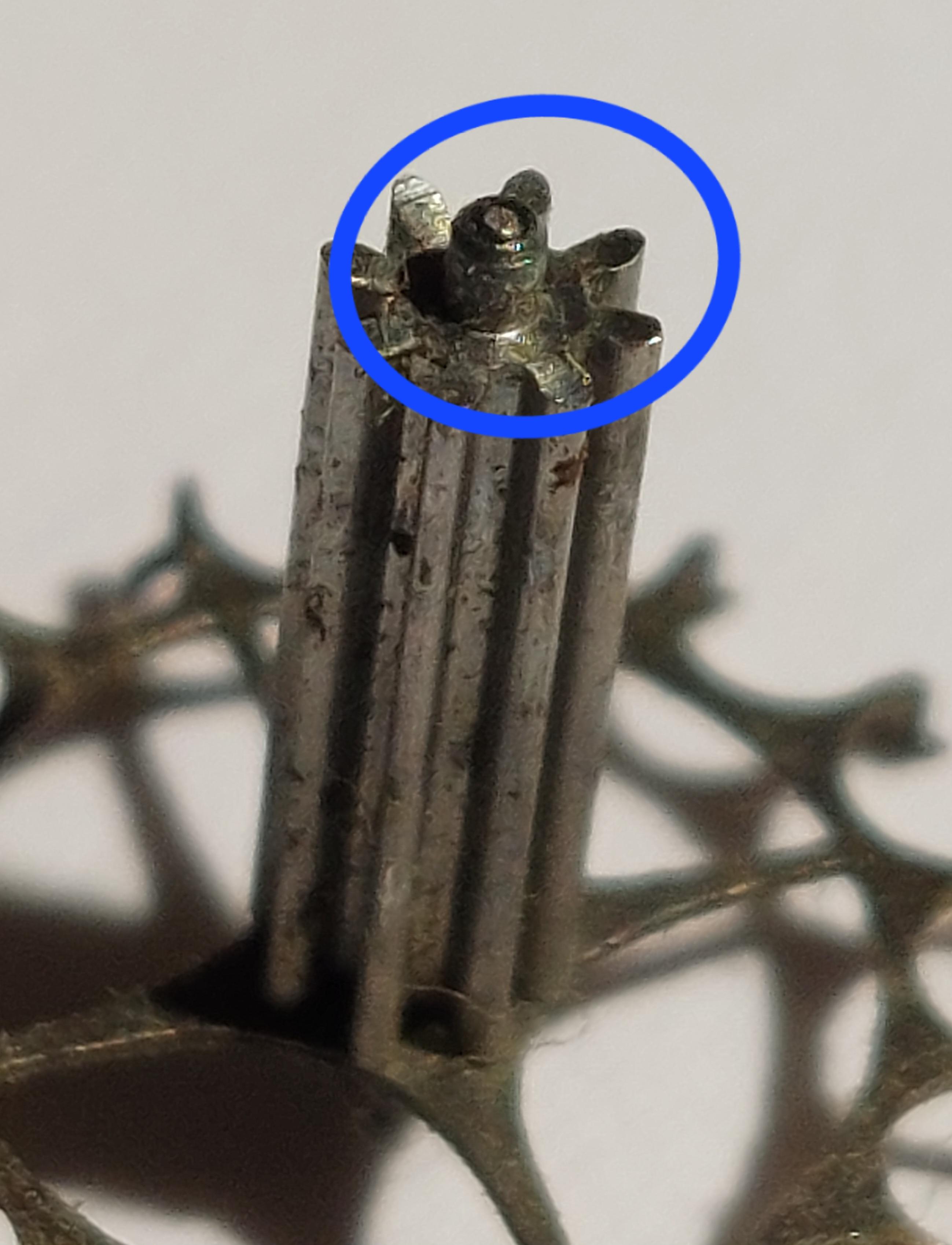

I want to ask your opinion about this piece, whose name I don't know in English. It seems to me that the terminal part is worn or broken. Does anyone know where you can find one?
23 minutes ago, RichardHarris123 said:
Is it from a clock, since you said carriage?  It's a cylinder escape wheel and the broken part is the pivot. We would need to know the caliber to find a replacement.
Thanks,  it's from an old carriage clock, but I don't see any number that can identify the caliber. Should I measure it, in mm?
Hi it’s as said by Richard broken pivot, getting a replacement might be difficult as the escape wheels can be of different lengths, the alternatives are re pivoting the one you have or replacing the platform complete which may require you to re drill the plates to accommodate the new one.  Can you supply pictures of the clock and also the platform. Also are the balance pivots ok, if not a whole new ball game.

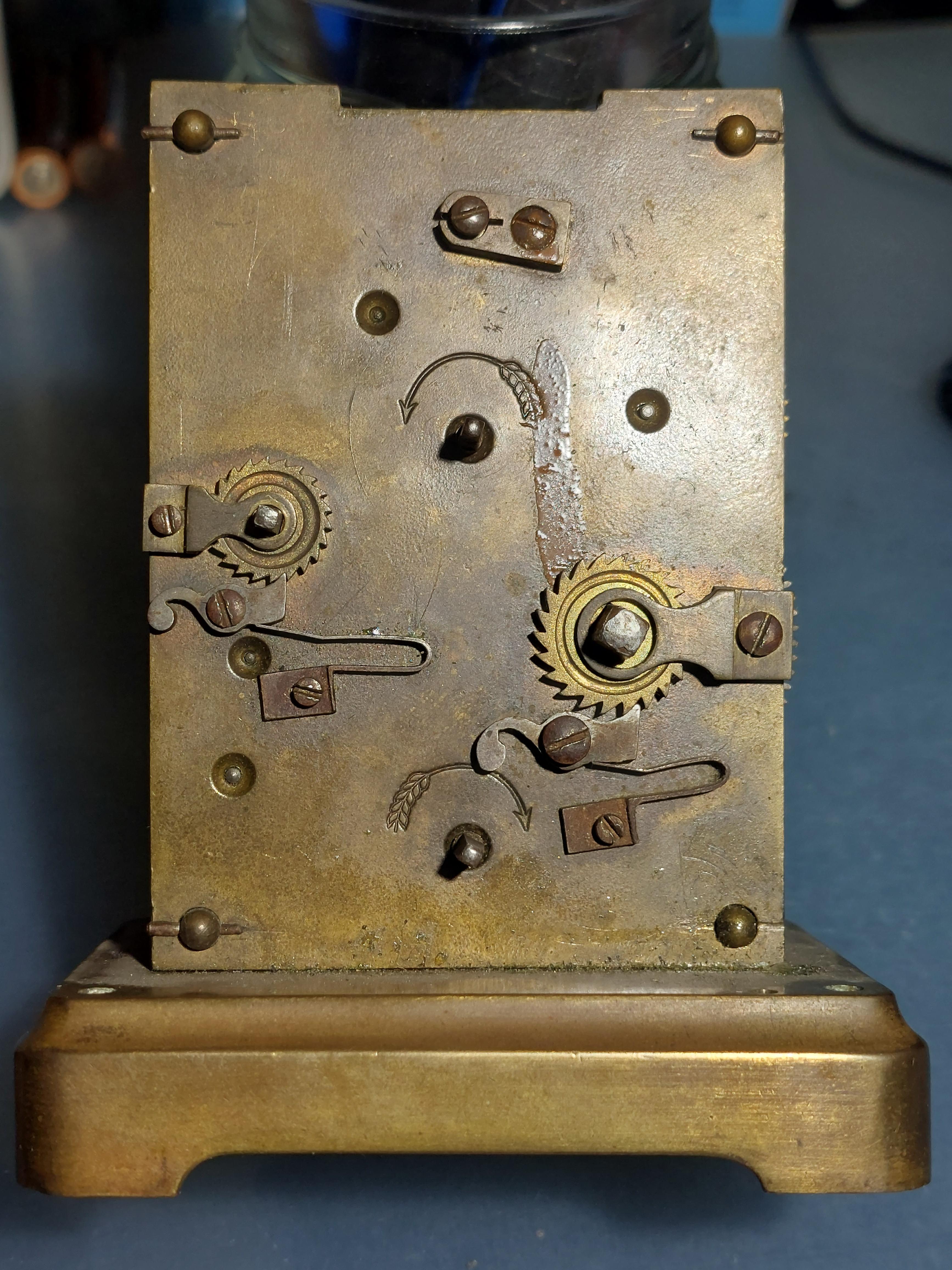

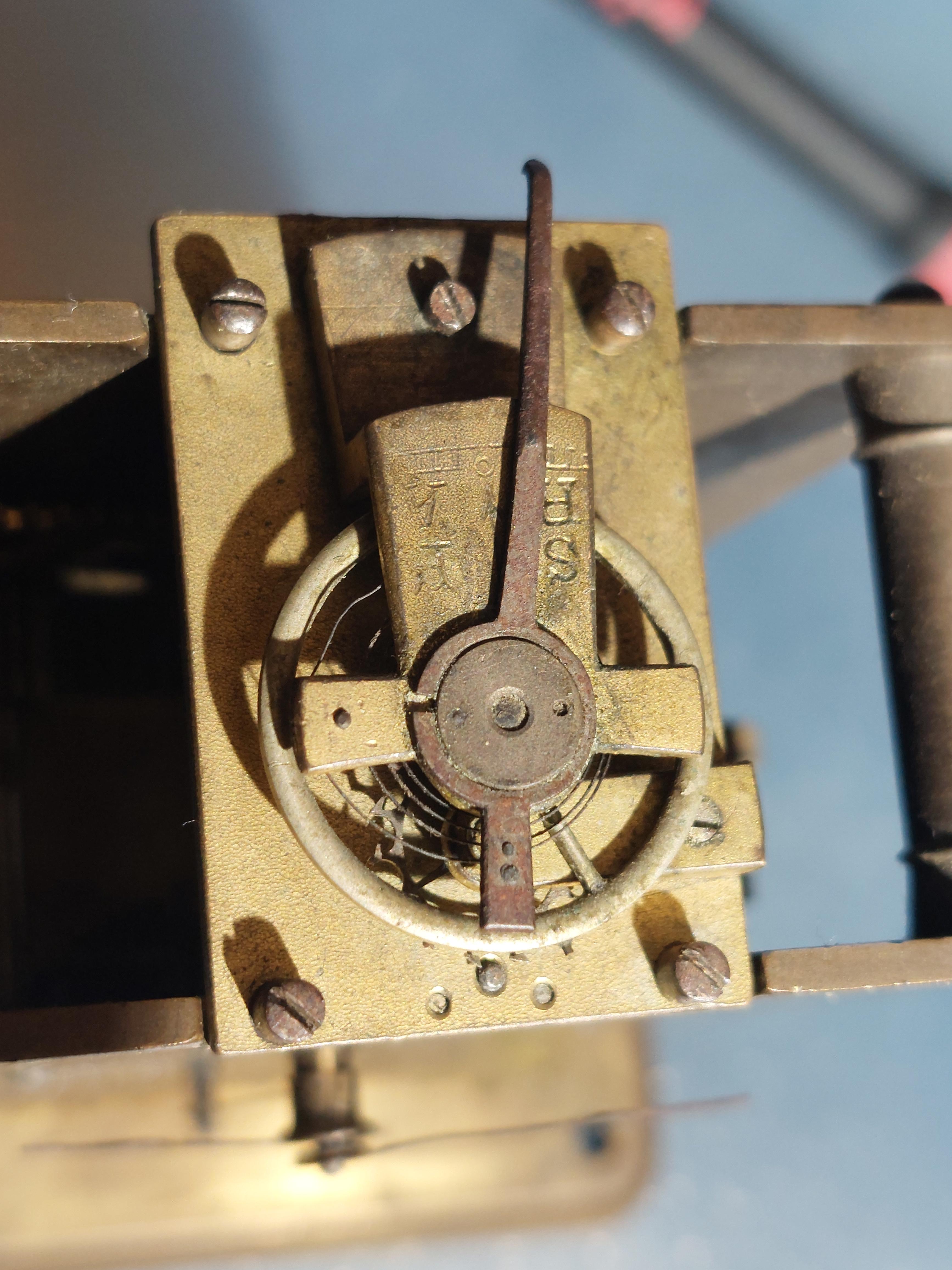

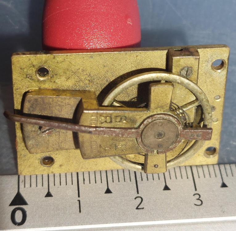

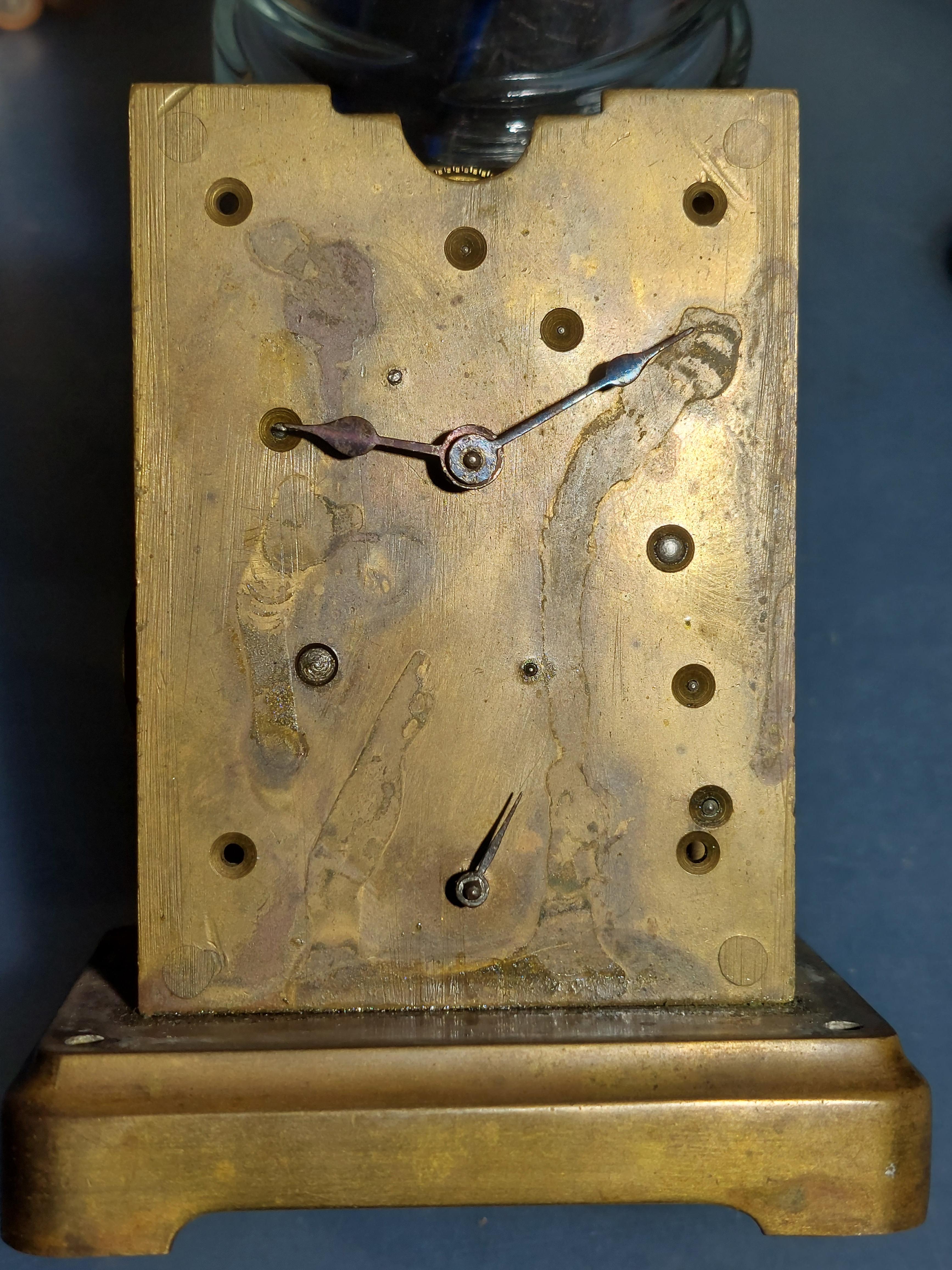

Some images...
35 minutes ago, RichardHarris123 said:
Post pictures of the movement, someone on here may be able help with identification.
Done!
Done!
Edited by AF10
Hi. Judging from the pictures it’s in filthy condition but nothing that can’t be rectified by cleaning etc.  the balance needs checking as the condition of the spring does not look good. These were steel springs and suffered rust spots. If a compatible cylinder platform can’t be found the alternative is a relatively modern lever escapement, they are not a cheap option.   With no markings difficult to date probably late 30s. Early 40s  . No point repivoting if the balance is no good.
You won't find a cal number on those types of clocks with a cylinder escapement. Your best bet is to find a replacement complete platform, you will need the wheel count and the length of the escape wheel, the width and length of the platform. As already been pointed out it is in a terrible condition, having an alarm is a bonus, have you got the dial and what condition is that in? Also the bell which fits under the base. I only see the alarm hand what about the minute and hour hands. How is the case is it complete with the glass panels if not they are very expensive to replace. One last thing the replacement platform look on ebay there are normally quite  few about. Make sure that the cylinder and hairspring are in good condition a worn cylinder and the clock will not work well if at all.
