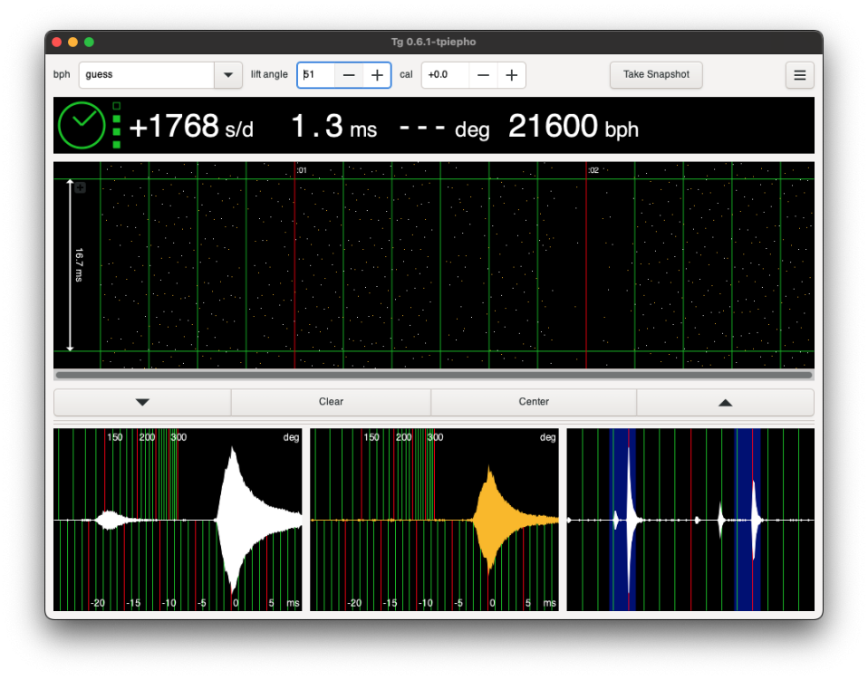

That's.... not amazing. While I'm no expert at reading this stuff, I think that gaining 30m a day, and having no detectable degrees of rotation on the balance wheel seems bad. I should note that I did try throwing in different bph and lift angles. This was the best it got.

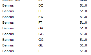

I googled "Benrus Automatic Lift Angle, and the most recent thing I came across seemed to list all Benrus' as having 50º of lift.
the problem with that searches to generic. Lift angle applies to specific watches.families typically of watches. Then lift angle is only needed if you have one of those newfangled timing machines and/or software they can measure amplitude. So basically they don't go back that far which means if we had the original technical documentation for your watch it with a list of lift angle because timing machines did not exist at that time that measure amplitude. More than likely at the time this watch came into existence the timing machine did not have a display and spit out a piece of paper tape with the printout on it.
But as newfangled timing machines came into existence so did lists and websites like this one.
https://watchguy.co.uk/cgi-bin/lift_angles
oh other minor problem exactly which what you looking for? if it's one of those 51°.
