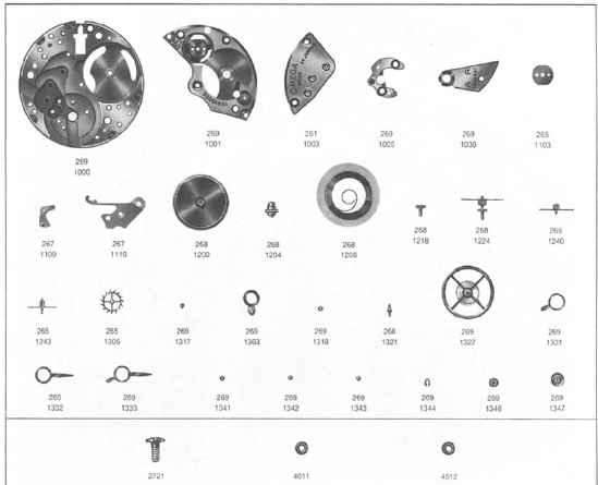

Did anyone notice that I attached the PDF of the parts list for the watch up above? If you look at the Ranfft Watches Website you'll see this watch the 269 is part of the family. Sometimes what happens is people get confused over what exactly that means like my quoted statement above does that mean we can mix and match from all the parts of the family because they're all related?
Perhaps we should look at the parts list I think that might be helpful so I'll just snip out images.
Reading the top part of the parts list tells us that the list has the parts unique or different than the base caliber and the base caliber is 260.
One of the minor problems with the Ranfft Watches site Is it Gives us a lot of information but doesn't give us everything which is what's presenting a problem for this discussion. So for instance did you notice something that's titled family/generations:. In other words an evolution in this particular case improvements or changes made over time.
So if we go down the list we get to 268: ring- instead screw balance This tells us that the balance wheel no longer has screws. It doesn't tell us anything else it just tells us the balance wheel has changed with probably still having the over coil hairspring.
Then the next entry 269: flat- instead Breguet-hairspring Another evolution this would be the screwless balance wheel of 268 now has a flat hairspring.
Now let's look at the parts unique to the caliber 269and how does it relate to this discussion?
As you can see a lot of things have changed not just the final change the hairspring. Look at all the new parts we get is that a balance bridge I see in the parts list? Definitely looks like a balance bridge and to go with your shiny new balance bridge we have a stud holder and the regulator pins. In a course to go with that the balance wheel without screws in a flat hairspring.

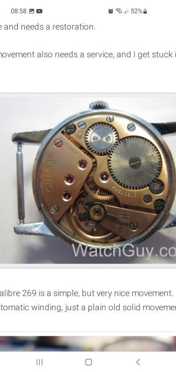

For better pictures I found a link. Now I can swipe some pictures and yes they came from the link
As you can see in the fuzzy picture I swiped it's a movable stockholder it's not fixed
I see he has another picture you can see the hairspring much better it's a flat hairspring with the balance wheel that has no screws plus notice the terminal curve?
A little searching online and I found a picture of the balance complete

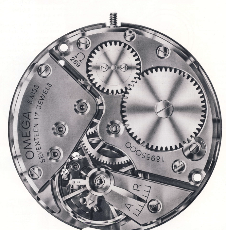

Let's see if I can help with another pictureWe know that this is part of a family so let's drop back to something that does not have a movable stud older like the 266 how does it compare
Casually they look the same but they're not the non-movable stud holder is usually part of the upper balance bridge it's all one piece Ewers is shaped a little differently and I suspect if you give it a little push it should move although it does look like rust on your hairspring studs screw it could be an issue.
We still have on answered questions though incoming watch from eBay what was its condition like and did you document by taking pictures of it? Because very clearly it's not supposed to have a balance wheel with screws. It now has a flat hairspring and if you flattened and over coil congratulations you did an outstanding job of it because well yes you did a really good job of that now I like to see you put the over coil back I find doing that kind of thing is a real pain in the ass but you still have the wrong balance wheel
one of the unfortunate problems with eBay is and not just eBay which is back to the original condition of Howell was described and sold is if somebody had done some mixing and matching to give you a complete watch so they can sell their complete watch.
I found a better picture of the 266 balance bridge as you can see the stud is mounted on the bridge not movable
Then a better picture of the 269 movable Stud holder which as we will note has been moved.

Thinking about that I guess it might help if we had the technical guide. And typically don't find technical guides because most of technical documentation was scanned for the purposes of the parts list.
So for instance if we had the technical guide like the one that's attached what can we learn? There's a reference to these are improved versions of prior watches as in the first paragraph. Then we get a list of the modifications and because typically people don't like to read PDFs I will snip out the important stuff
I've highlighted the interesting modifications and the technical guide talks a little more about those highlighted items like the adjustable stud holder
I do find sometimes with Omega because of how well they manufacture things that may be the adjustable stutter holder goes unnoticed. But it is definitely adjustable
then we have the balance wheel and hairspring
A rather nice image of 269 and I suppose you could squeeze the balance wheel in there with screws of course it would defeat the whole purpose of the improvements to the watch but I think you'd have a challenge doing it and I don't think on watches when improvements are made I don't think you can Downgrade to a earlier non-improved version and mixing and matching parts. That usually doesn't happen
