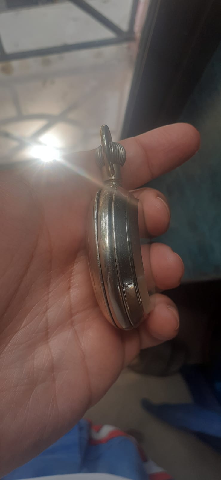

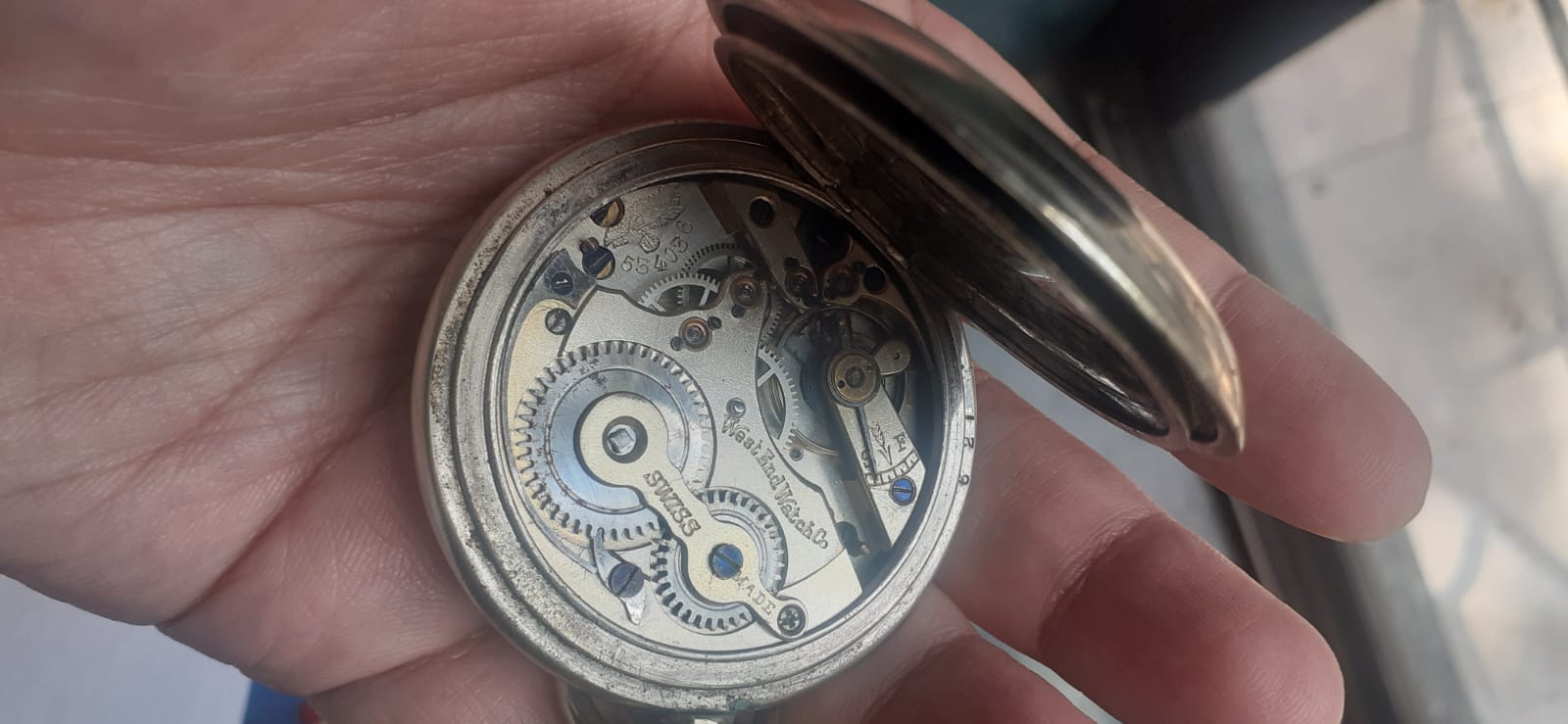

Its a west end watch .Want to know how genuine are these pocket watches ..Claims to be from 1800s and the other one (on the red background) 1920s..Any idea how much should I pay for it.
They are genuine with the exception that neither are remotely "railroad" anything.  These are almost bottom of the barrel quality, just a hair above Roskopf. Many cheap watches from the early 20th century incorporated railroad themes to promote a view of quality; a dead giveaway is usually the mention of railroad and/or images of trains. I doubt either is late 1800s, both look 1st 2 decades-ish of 20th century (maybe up to 30s or so).
These are worth very little. But might be fun to fix up and carry around.
Sorry you cannot compare these pocket watches to that bloody Russian crap Roskopf. Both are Swizz made. The first has an average jeweled movement, the second is at the lower end because the train isn't jeweled. The dates are about right.

Both are genuine. The first is the better of the two, the movement is jeweled and the second is not.  The first could be a silver case the second isn't and it has a hair line fracture in the dial.
Thank you so much sir that was such a good insight…

Best place to get an idea of the price is ebay, of sellers from India.
I would buy the Matchless if you love it, providing the hairspring coil is unmolested.
