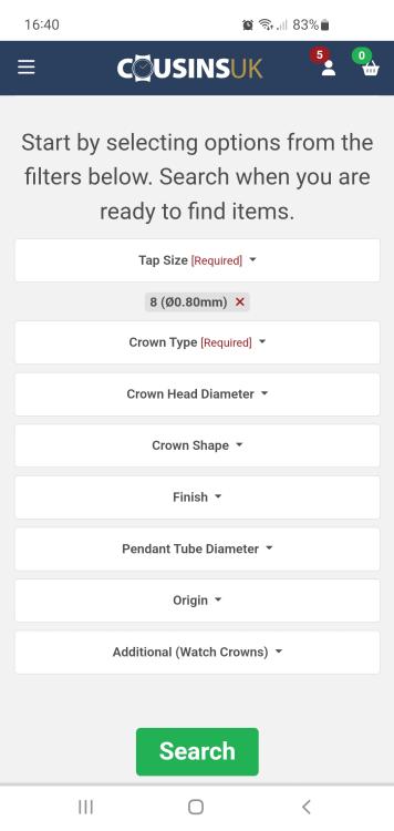

Unfortunately I  can't help but I don't know why a generic crown won't suit.  Is there a reason ?
When you say generic, I'm also not sure what you mean. None of the crowns I have fit the 8m stem. I can't find any crowns that have an internal screw diameter of 8mm. As you can see from the box, the sizes go from 3mm to 5.0 +3 mm. Don't know what the +3 means.
The largest 5.0 +3mm does not come close to screwing onto the stem.
I'm confused. You say that the tap size is 0.8mm, but above you say 8mm stem :
I guess you mean 0.8mm?
Then you say
I think those sizes on the box are the crown diameter. In each selection there's probably a range of stem sizes, 0.8, 0.9, 1.0.  The other number +2, +3 could be the width of the stem tube?
Measure the stem tube and crown diameter and you can get them from Cousins.
That is a Chinese crown set. They are all 0.9mm tap. The +2, +3 refers to the length of crown pipe.
If you need 0 8mm tap, you have to get individual sizes from a supply house.
the problem you're having one fitting a stem and crown it is the thread size of both of them has to be right or they will not screwed together at all or will be to loosen probably strip out.
Then there is the style of the crown oh wait that's a waterproof crown I see that on the box no problem that's the right style oh wait is it?
I swiped a picture off one of the websites notice there is actually about three types of waterproof crowns but we only care about two styles the Japanese-style and basically everything else. What is the difference the Japanese-style has a little tiny gaskets on the center part that goes inside the case to. Everything else is different it has a much larger gasket that's buried inside that actually goes around the outside of the case to. Or basically they're both waterproof but they're different styles of a crown
then the box of waterproof crowns almost all of them look like your standard crown except we really need the lid opened up looks like three of them in the lower right-hand side it may be a Japanese-style crown.
I was avoiding rereading the entire  discussion but I think it's all here.  so like this wrong Size C have to get the right Size or it isn't going to thread. Also the Chinese crown set as I pointed out is the wrong set except possibly the three crowns are three sizes in the bottom that we really can't see properly.
19 hours ago, rossjackson01 said:
Part number of the crown on the Seiko 6119a sheet is 998610, and for the stem 357611. I have looked on Cousins but the crown is not listed.  https://www.cousinsuk.com/product/japanese-style-for-seiko-citizen?code=AF5101
so if we take all the knowledge we've learned were looking for a 3.5 mm tap 8.  So we can either look at the generic ones on the label or does go down the page and see if they have anything. Any case I'm attaching another image there is only one other little concern is the reference to long pipe. I'm not going reread and go look for what the original was I can't read that's a long pipe or a short pipe but it looks promising on the website to me
so basically regarding your question you have to have the right crown style for the type of watch are seeking a crown for as there's lots of different styles is the one image shows. Then of course the right diameter and definitely the thread size has to be right as you've already found out.

Mikpilk, Hectorlooi, Richard & John
Thank you so much for taking the time to assist me. Yes, I do find it difficult when tying to assimilate information from the internet.  When I see numbers lists, I can't tell the difference between items next to each other. Dyslexia rules K.O.
I now know definitely which one I need to order. Saved me trying to find a 6119a movement on ebay, as I now do believe that the case number defines the crown.
