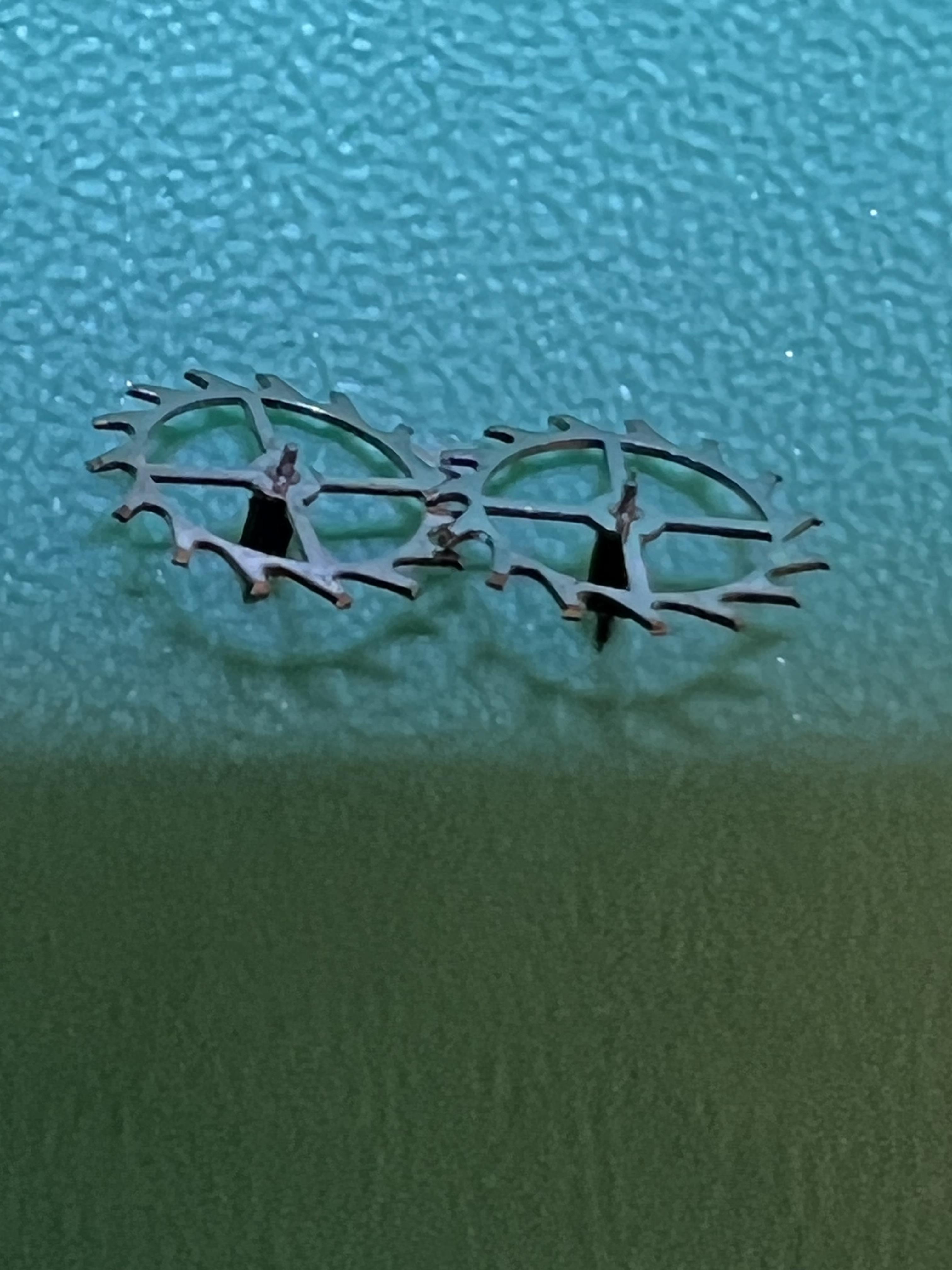

Hello All, first post other than intro. I’m having a problem with the escape wheel staying in place, the pivots look ok to me, but what do I know, I’ve used two escape wheels in the same seagull clone movement, both continue to slip out of place. I checked the pivot holes under magnification and they look ok. I know you guys need pictures, so I’m buying the camera adapter to actually take photos through my  Amscope. Any general idea as to why two different escape wheels in the same plate  won’t spin when all other wheels do? First post so be gentle.😂 Thanks, Mark

What we need is you to check for the most probable fault.
Remove all parts, then  fit the escape lower pivot in the hole its suppose to go in and place its bridge on it, tighten all bridge screws.
Next,  if escape wheel as you say slips out of the place, its either short pivot or  upper & lower jewels are too far apart and need to be adjusted.
Adjustment is to move the jewels so escape wheel engages with third gear( the one before it) and  engages with the fork pallets as well ( pallet and escape wheel both in the same flat plane).
A worn or broken  pivot is usually easy to spot, as it  is shorter than the other.
Rgds

Appreciate all the great advice, I did buy two of the Chinese movements, and you may be right about the pivots. I have a microscope, and have examined them, but not really sure if they’re broken or not. I’ll try and take some pictures. Thanks again

Definitely looks broken to me.
I would agree with that assessment and perhaps use the phrase your pivots are missing which is why you're not noticing that they're not there. As opposed to their broken and their partially they are there totally gone.
Agree, the pivots are missing.

No pivots, in fact looks like they were never there. Thats a bugger maybe one good reason to avoid buying Chinese clones 😔

Also one of the missing pivots look like? I've attached an image it's not a great image but that's what escape wheel pivots look like all your wheels should have pivots. Pallet fork should have pivots but they tend to like the falloff also. I'm not good explain how I know that pallet fork pivots falloff they just do sometimes. Everybody breaks stuff when their learning. This is why the clone is relatively cheap it's running it makes it easy to see if something has mysteriously fallen off versus starting off with broken watches and being frustrated with what the problem is.

Thanks John, you’ve been a great help, so lucky to have found this site. I bought two of those Chinese movements, the second one the pivots look ok, I’ve enclosed the picture of the escape wheels side by side. I’m at the stage where I can take apart a movement and put it back together, fault finding is going to take much longer, like anything else it’s practice, practice, practice, you have to start somewhere I guess, I’m on that learning curve where I just know the absolute basics (how to use tweezers, screwdrivers and the amount of touch required. I’ll learn the theory behind the movement as time allows. Baby steps for now! Thank again for all of you help.
Confusing.  Unless jewels have been pushed apart too.
