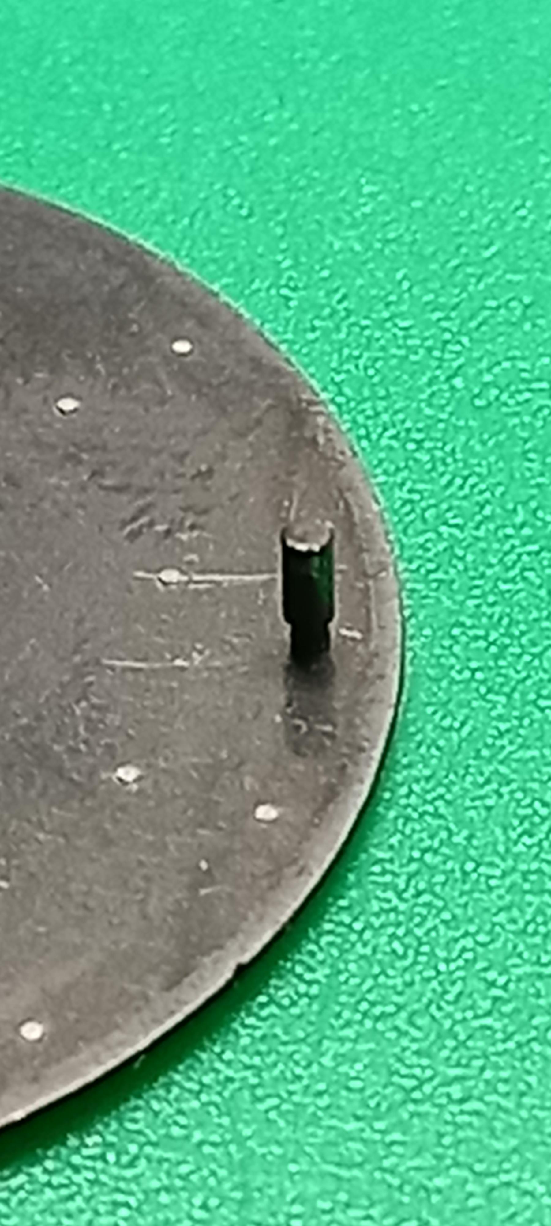

Is that .8mm in length.  If so then its way too small for a dial foot.
Apologies. Placed it on the inch side of my callipers instead of the mm
That's 2.159 mm X .635 mm for those of you in the civilized world.  That's smaller any of the spring pin ends that I have in my scrap jar.

Given that the movement was uncased, possibly a foot from a non Seiko dial.

now that we have very exacting assizes of the mystery item. Plus additional bonus pictures of it could we get a picture of the dial the backside. It is unfortunately surprisingly easy to knock dial feet off modern dials.
It didn't come with a dial John. . It only had one foot so it hopped off.

Thanks to everyone for identifying the mystery object.
I’ve been looking at all the parts both with the naked eye and microscope while referring to the 7s26 technical guide. No post seems dislodged from the plate and all wheels are intact.  That pin/dial foot was jammed tight between the center wheel arm and mainplate, preventing the wheel from rotating.
Will clean and reassemble the movement. Curious to see if it runs. I don’t yet have a timegrapher so will use the watchtuner app for measurements (assuming it starts).
I’ve been practicing on some Incabloc settings from Otto Frei (mounted in Rodico) so should hopefully be able to handle the bridge shock jewels. Will attempt some balance spring manipulation also.
