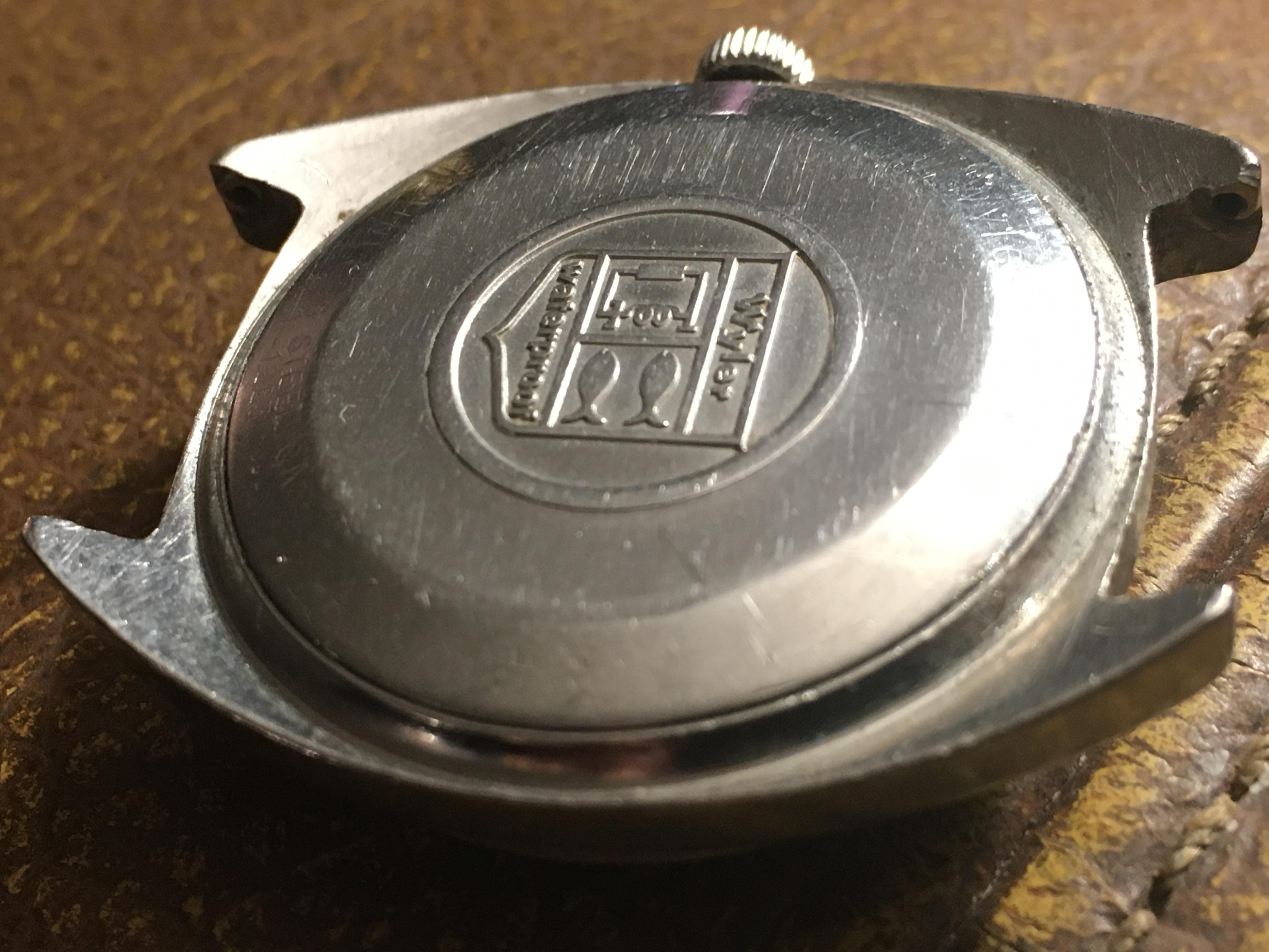

   Recently came across a 1969 Wyler Electronic Mens watch.  It’s NOT a Wyler Vetta.  Just Wyler.  I’m newish to collecting/ repairing.  The case back is pressed really tight down.  There is not a lip on case back or any notched out areas to get any sort of tool, chuck, old school rounded snap back pry opener.  I don’t want to pillage the case back to get in.  The watch as a whole is really really clean.  Did Wyler make a special tool to open these case backs?  I believe it’s the original case back.  It’s pressed with a Wyler waterproof symbol.  Ide like to keep it looking nice as a whole if the movement proves to still work after I get it off.

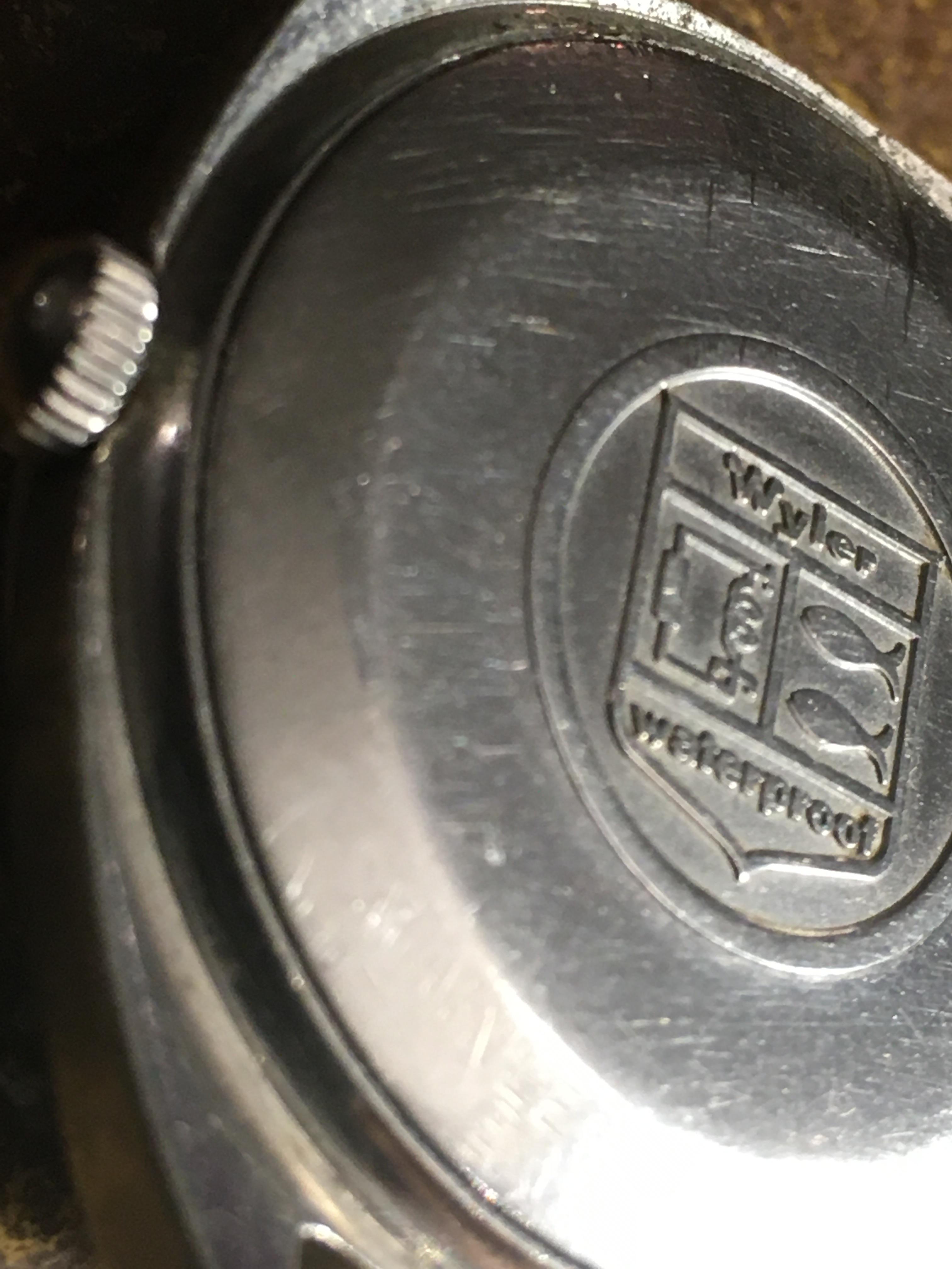

You can see where a past someone has used some sort of “tool” to try to get case back off.  One of my pet peeves is when the wrong tool is used for the job.  Part of my hobby is in the refurbish process.  I don’t care so much about the monetary value.  It’s in my personal cool value.  So…. Ide like to keep new damage to a minimum.  I can find little to nothing about this particular model.  A Wyler add is the most I can locate.  Not sure if I am typing wrong words, etc….  But nothing.  There are no notches or lips or ridges or grooves anywhere on case or case back. I cannot imagine Wyler would ok a design flaw like this without having a specialized tool to avoid damage when removing case back.  Am I wrong?  Help!   My wife and I have spent many hours on the internet searching.  We’ve come up with nothing.  A Wyler Vetta is as close as we come.  It’s NOT.  Just a Wyler.
I notice that the shield seems to align perfectly with the lugs.  This leads me to believe that it is not a screw back (never seen a screw back that seated perfectly to align a logo--but it could happen).  Are you sure that it is not a front-loader?
I would first remove the crystal to see if it is a front-loader (please post a picture of the dial side). It would be obvious if it were because you would see at least some forward movement of the dial side outward from the case. EDIT--on second thought, since it is electronic, I seriously doubt it is a front-loader.
If it is clear that it cannot be a front-loader, I would use a safety razor to slip between the (what appears to be) back...working around the circumference.  Exercise caution and don't cut yourself.

Examples show that @LittleWatchShop is absolutely right. As soon as the back is screwed it doesn‘t line up. Case backs without flats or notches for an opening wrench align perfectly. They are either snap on or solid (frontloader).

We need a picture of the side of the case and a better picture of the front of the case as I don't think the back is coming off well not without a lot of force and then it may never go back on again

oh and then there is a minor problem with the back if the back is not to fit a stem which is sometimes common and that would explain why it's in perfect alignment but usually backs that are meant to come off will have some place for you to pry the back off. Which is why it's still be nice to see a side view with a case to see if maybe it does go out through the front.

Wait!!!!    Holy crap!  Could it actually be a front loader?   This is the first time I’ve seen this seam on the front side!  Ugh.  I don’t want to start gouging if it’s not an actual seam though.  Thoughts? Suggestions?
Roughly measure the diameter of the dial and estimate if it is bigger than the expected opening in the back. If so it‘s a frontloader for sure.

Safety razor blade.  I would not hesitate.  As you insert the blade, you will see some give...then proceed.

As noted already the seam is there and clearly visible. If it was not there, it would be called a monocoque or one piece case. But these are not as nearly common like front loader cases made in two or three pieces.

Ok folks please be patient with me.  It is a front loader.  My next question….  How am I supposed to get to the backside to get at battery?   Is it like doing the same to a pocket watch?   If so I don’t know how.  What’s the best way to get to the battery?
Some front-loaders (but not all--e.g. Stellaris electric) have two-piece stems.  You can generally tell by how "floppy" the crown feels, but take that with a grain of salt.  For two-piece stems the general practice is to just pull the crown off with appropriate force.  HOWEVER!!  I know one case, MIDO, that you do NOT do this.  Mido says to put the crown in a certain position and then drop the movement out.  Does anyone else use this scheme?  Dunno...experts will have to weigh in.

Mido is not the only case. Myself and others always advise to try to remove the mov.t by gently lifting it while slowly rotating the stem, and refit it with the cuts vertical and aligned. That can work for any maker and model, and save any stress to the joint. However, for some reason, you often read about nail clippers and forceful pushing. Not in my book.
Y’all have no idea how helpful these suggestions have been.  New update:  Have the front off.  When the stem is in the normal run position the movement will move a little.  When pulled to the setting position, it doesn’t seem to want to move at all.  I’ve gently but forcibly pulled on the stem and it isn’t budging so I am thinking it isn’t a split stem.  On a positive note….  When I finally got the crystal and bezel off I twisted the crown in set position and the second hand swept forward for 20 seconds or so.  When I reversed and reset back an hour the second hand swept back around 20 seconds.  Honestly….  I madly love watches.  Is it worth my time and effort or by what’s going on with the movement, an I spinning my wheels for nothing?   I m learning which is always cool but….

Excellent tests.  Sure seems like the back has to come off using the same method you used to remove the front.  My concern for you is that both the bezel and the back will be a VERY tight fit and you will not be able to put them back on with the proper tool.
