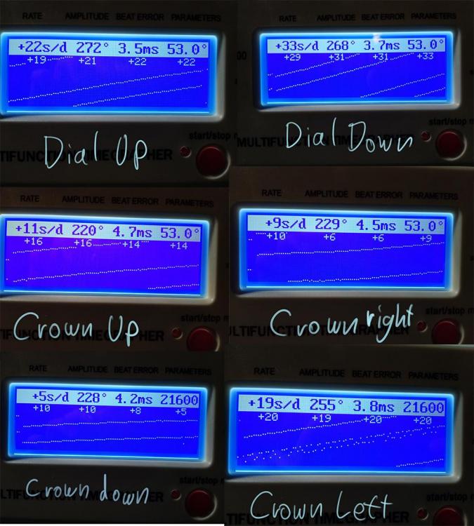

Nah i gotcha. I'll combine them into one image and post em because there is a bit of weird snow/irregularity in some positions and I have no idea if it's normal. It began, or got more noticable the moment i opened the case back and before i ever touched an etachron. It's a bit concerning and i'm wondering what you guys would make of it. I'll post later with the best photo i can take of the hairspring.

Ok, good relief that getting the thing isochronous (pretty sure i'm using that right) cleared up most of the snow i was seeing earlier, full wind, let it spin for an hour and here's the results. No f'ing idea what's going on in crown left. Would love to hear an explanation for that. I also took some shots of the hair spring in motion trying to capture it's compression and expansion positions best i could best i could. if people wanna see i can run it down and take pics of it when it's sitting still tomorrow. Sorry i don't have a decent macro camera.
15 minutes ago, Birbdad said:
…No f'ing idea what's going on in crown left. Would love to hear an explanation for that…
The pallet fork seems not to feel fine in this position.
Interesting....what on earth could have caused that? Is this purely an allignment issue? I haven't touched anything but some careful fine adjustments of the etachron levers. I wish i could say for sure i checked all the positions before i opened up the first time when i got my timegrapher but I don't recall whether i saw noise like that before i opened it up. I did however see an odd amount of noise right after i opened it up but before i touched anything but I now know it was not even close to a proper state of wind...
ALso is there another resource that shows  patterns like that and offers likely explanations for them? i've actually been looking for something like that to save for reference for the future. Thank you.

That was actually really fascinating so thank you for that.  Doesn't really deal with the signal i'm getting but I learned a lot of great terminology from it and what the sounds the thing picking up are actually from specifically.  ALl this is so fascinating to me.
Intuitively I just can't really think of a good reason why one side of the pallet fork would not engage properly with every single tooth on the escape wheel but in only that one position.
Was thinging about this earlier today. One side of the pallet skipping every other tooth to create that reading. Tbh i would have expected the escapement to halt. Maybe just not fully engaging. A worn escape wheel pivot ? How old is the watch ? Has it had much use ? In that position the escape wheel is drawn away from one of the pallet stones. The pallet stones not set correctly from the factory ?

This is actually my newest watch, ive not even had it a year barely. The date code on it however shows it was made in 2018 so it sat god knows where being unused for years. I's not gotten a ton of wrist time so i'd be suprised if anything was worn out in it. I do know the 7s26c movement was infamous for being poorly lubricated from the factory sometimes so maybe that could factor in.
I just wish i could tell you for sure if i had checked that position on the timegrapher before i opened it up to regulate it. Could debris trapped between the case back and the case falling into the movement cause something like this? There was a LOT of it that got released when i loosend it but i was pretty careful to brush/blow it all away before i fully unscrewed the back.
One thing worth noting since you mentioned the escapement halting. Since the day i got this thing it is THE most sensitive watch i've ever owned to backhacking. when you're setting the time on it even THE tiniest inward and downward pressure on the crown can stop that seconds hand on accident and sometimes you have to tap the thing to get it started. I don't consciously do back hacking but on this thing it's really really easy to accidentally do it just in the normal course of setting the time.  Could be a factor?

So unlikely that anything may be worn then. Always a good idea to take readings before starting any work. This can eliminate you as the culprit for issues. Good bit of experience you've just picked up Birb, this now reminds you to perform this procedure as a habit 👍. This and a demagnetise.  If I'm honest i do occasionally forget to do one or the other 🤷‍♂️.  Absolutely debris of any kind in the movement can cause all manner of issues.  A small delicate movement can be brought to a halt by a single fine hair or fibre if strategically placed. 😆

All great advice. I actually didn't own a timegrapher back then, i only received my timegrapher a few days ago. Also I actually washed the case back and cleaned it thoroughly with water before i opened it but that microscopic crack between the case and the back exploded with grime the moment i loosened it and yeah i did use a brush and blower to remove it before fully opening the back but it was so much it is possible that despite how careful i was something got in....somehow. my watch hand removing and setting tools should be here in the next few days, if i haven't resolved this I'll try decasing it and timing it that way.
Yeah it was just the watch i was least concerned with as it was my best timekeeper and newest watch. Hindsight!
I had demagnetized it fairly recently but it's possible it picked something up. What's the verdict on whether a watch has to be non running before demagnetizing? it also seems to be one of those things that nobody agrees on.  If it's fine to demagnetize a running watch i'll do it right now and throw it on and see if anything changes.

Ahh. I have been meaning to ask if it was cased. This could very well make a difference. Oh and Birb this throwing around of your watch onto the timegrapher. Possible that this may not increase your chances of it ever working any better or your timegrapher for that matter . 😉 can i ask how good your aim is and does it ever land in exactly the right place to begin timing it. 🤣
1 hour ago, JohnR725 said:
I bet you get a different signal perhaps it out of the case.
A little better. But not much better. Something is definitely up with that position.
It would still be interesting if you could just adjust the beat a little bit maybe like 1 ms just because it be interesting to see
then how about an experiment you can rotate the microphone in steps but you can also rotated in a linear motion if you like. If you put the watch at Crown left and just start to gently rotate it how far in either direction can you go before the noisy line goes away?
Then regarding timing machines I have an interesting video. The real purpose is to demonstrate how wonderful they are escapement is versus the lever escapement. For which we can care less about because were never going to see this escapement anyway.
At around one minute and seven seconds we get to the interesting part for a lever escapement. If you look at the witschi documentation you understand which parts the waveform the timing machine needs. There is a nice video showing where those sounds come from.

Haha, sounds like a fun experiment.  I'll do that! I'm pretty sure i can get it to a lot lower than 1ms.
Honestly though, i'm like 95% confident that whatever is going on there predates me opening that watch up, I just didn't have a timegrapher to see it in that one position and i didnt' bother to test it in that position when i finally got one. The mere fact that watch behaved strange from the get go with the weird back hacking sensitivity thing but it kept great time makes me think it might not be a big deal. I'm also pretty sure it didn't come in a real seiko box or with a real seiko cushion so who knows the history of that watch. I got it on ebay, it did have stickers, tags and a manual tho.
I'm gonna do your experiment and post pics but i think i'm going to regulate it again properly this time and get it as perfect as possible in one sorta happy medium position and then close it up and get it back on the wrist. but i'll post pics and data from the range before the weird singal starts in that position.
