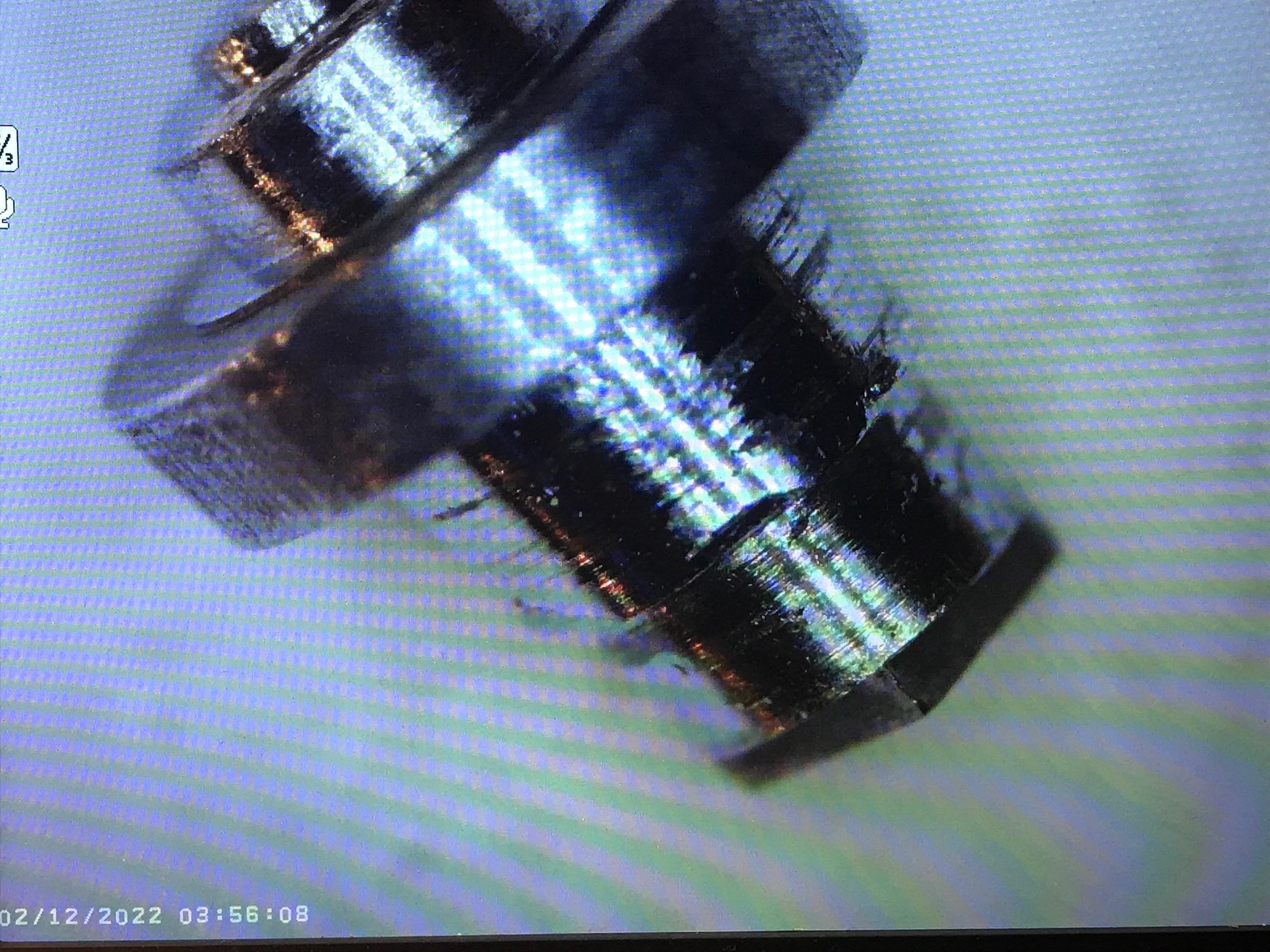

Oh dear. The lid falls out of the Barrel  when its in the movement.. it seems to be getting worse. When I dismantled last time it was sitting on the main plate. When the barrel is in place with the barrel bridge fitted, the barrel will move with a rocking motion whilst the arbor has little to no movement in the bridge.
Barrel bridge
Close up of pivot hole
Underside of pivot hole
Main Plate pivot hole
Barrel arbor

The main plate hole looks well worn. The arbor has a lot of scoring as well . How does the arbor on its own look in the main-plate  ?You might want to rethink doing this yourself.

In the absence of more experienced observations, I am coming to the same conclusion re: the main plate hole. Looking at what is happening when the watch is assembled, I believe I am getting movement at the base allowing the arbor to tilt with the pressure of the spring. The movement at the barrel bridge doesn't appear too great but the barrel wheel is tilting a fair bit.
Presumably the solution would be to fit a bushing ... which would also allow adjustment of the end shake which feels excessive.

Just trying the arbor in its main plate seating and observing it's play will tell you what you need to know. Bushings you can buy. Making the hole for it needs to be accurate  and in exactly  the right place. It is something I've been thinking of trying. I've seen a bushing tool on ebay a few times, no idea how it works or how well. John loves to get stuck into this sort of complex job also nickelsilver might help you. I think you will need some parts as well. An arbor a barrel lid, but you may be able to make the lid.

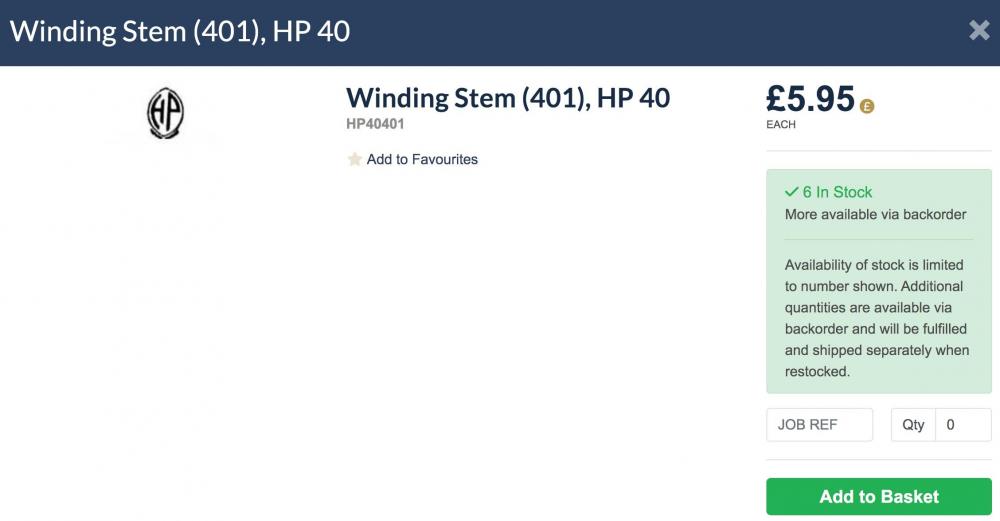

I have found a replacement movement which fits the watch case and matches the dial feet. Have yet to strip it down and clean/service it, but a preliminary inspection suggests its in better nick .
The question I have is .... it is missing the winding stem. Can anyone give any pointers on how I might go about finding a stem that will work?
The movement is a Swiss Parrenin with HP HN42 on the dial side.
16 minutes ago, RichardHarris123 said:
Cousins sell assorted stems.
I have these and unfortunately no joy. The markings on the face are HP (Parrenin?) then H2 then HN42.
Cousins have.....
Would HP 40 be correct? .... or am I completely misreading things?
