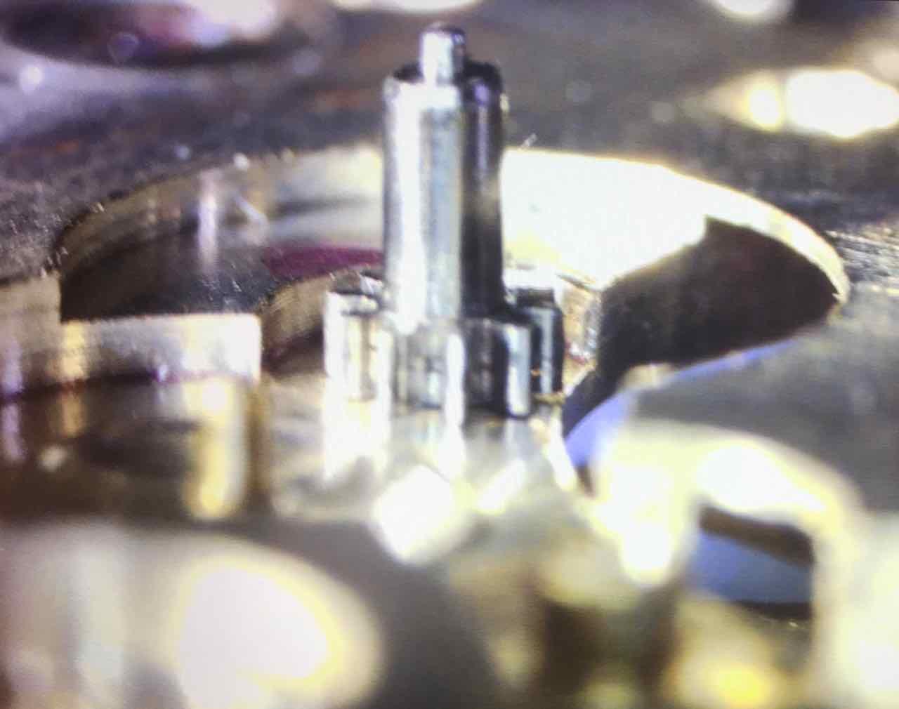

....onto the question about the pinion ... these are pictures which as I say above suggests its a taper pin/arbor arrangement to my novice eye? is there a tutorial/lesson anywhere on removal and refitting?
Also this is a photo of the banking pins ... the one on the right is noticeably splayed?!! is this correct .... and if not how can it have happened?

The banking pins have been bent to overcome a problem the previous repairer had do not straighten them up just leave as is untill the watch is running  then see how it goes, straigtening them now may give you problems later.

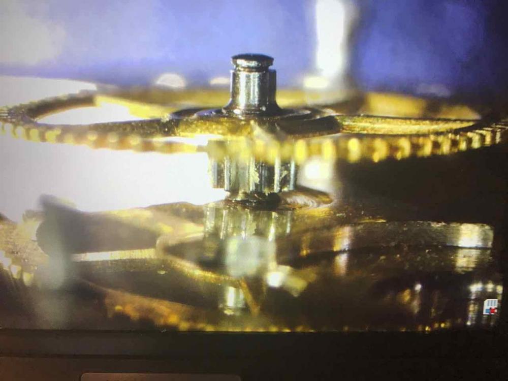

Am I right that this is a pin and arbor arrangement?
What is the process for refitting once disassembled bearing in mind that I do not yet have a staking set.

The bankings pretty certainly didn't leave the factory like that. The escapement would need to be checked to find out why the entry banking is so bent. A guess from afar: the exit stone has been replaced with a stone too long or moved out for some reason, which means the escapement wouldn't fully escape from the exit side as the fork was against the banking on the entry side. Moving the entry banking pin will allow it to escape, but now in addition to the extra lock on the exit side from the jewel being out too far, there is additional drop and total lock on the entry side. The watch probably runs, but amplitude will suffer very much.

no one appears to have noticed my question about the arbor pin arrangement which appears to be how the cannon Pinion is fitted?
I need to remove the centre wheel but only have experience of the standard cannon pinion arrangement.
I have found some threads describing knocking the pin through from the Pinion side releasing the wheel ... but no description so far on how to reassemble? Is the pinion simply pressed back down onto the arbor with tweezers, or is the process more involved?
Thanks for any input. 👍

Yes, knock it out. If the center wheel is jeweled at the bridge you want the bridge off, and support the center wheel in a hole in a bench block, or better, a staking tool when knocking out the pin. If not jeweled you can leave the bridge on, but still support it on a block with a hole to pass the pin. The pin will go down as far as the top of the cannon pinion, which should be plenty to pull off the CP and the pin out the rest of the way from the center wheel.
Going back, push in the pin, (this is with bridge on), support the large end of the pin on a block, and press down the cannon pinion. You may need to press quite hard, or use a staking tool with flat faced punch with hole to pass the pin to get the CP seated all the way.
