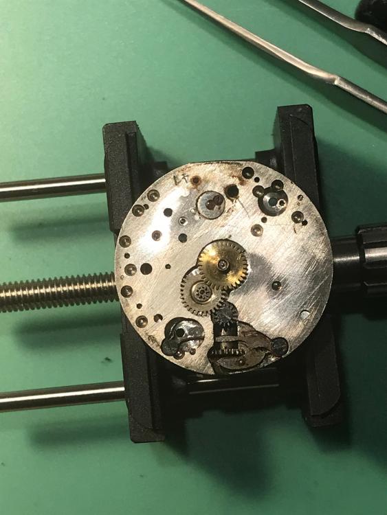

I have lost the click off a pre WWI ladies wrist watch (pocket watch style) and to date have failed to find it (I still live in hope!).
Given the age of the movement and no markings to suggest the model/maker etc, what options do I have if nothin turns up?
Unfortunately the click. It was still under tension from the spring due to the particular config. and so pinged away when lifted off the post - I felt very foolish, but the last three movements I have worked on had no tension on the click at all when at rest - 😪

HI  and also a close up of the keyless work may be able to get an ID from the bestfit Identification guide.   One reason why we advocate removing  replacing  springs , clicks  etc  under or inside a large plastic bag that way the ones that try to escape are confined ti the bag and readily retrieved.

We have all been there and spent time on our knees looking for parts so you are not alone.  Can you get the movement size (Lignes) and I will look in the book and see what we get.
Hi Had a look onthe bestfit book, yours converts to 13.2 lignes and is a simple lever and spring, no flat setting lever spring unfortunatly nothing showed up will have to see if anybody else has any ideas.    cheers

Hiya Lecorb. Sorry about that matey a very frustrating event I know only too well. What size room and work area are we talking about ? Is it not worth carefully clearing everything off your workbench. Emptying out any open containers and the like. Another  really thorough look costs nothing and might be your only course of action if a replacement is not available. A click isn't really that small in comparison to its spring. Diashock springs on small movements are crazy small as are stud screws. Is the room carpeted? Is a big magnet available  for use ? I use a whacking big one that is used for magnet fishing. There is nothing that I've lost that it hasn't  retrieved. It's certainly  worth a try. Good luck.

I believe that it is a pocket watch style movement .... the canon Pinion is a pin fit and the case has a hinged front and back. I don't know if that makes a difference?

Brilliant  How did you find it and where, sounds like a good storey.   Pressure is off now, remember when refitting keep it covered should it try thr Houdini act again        Cheers
I believe the cannon pinion arrangement of this watch is a taper pin/arbor style set up where you have to drive the pin out rather than pull the pinion.

No great story ... just couldn't work out how it could have ended up in that place from where it started out! It was lost on Sunday around 7.00pm and found the following Tuesday morning.
I work in an office with benching and wooden floors. the piece dropped on the floor from the front of the bench and being a click cannot roll. it was under tension from the spring and so should have pinged away from the desk either straight down or away behind me or to the side. The desk is built in so it can't fall off the back - it has a wall to the left and runs around the room to the right for a number of meters. I cleaned off all the work surfaces and searched fully including with a magnet. I cleaned back all the floor including beneath the adjacent desks at right angles .... no luck.
In final desperation I searched beneath the bench and found it right in the back rear corner. Still no idea how it could have got there without either legs or wings ... but there you have it!
