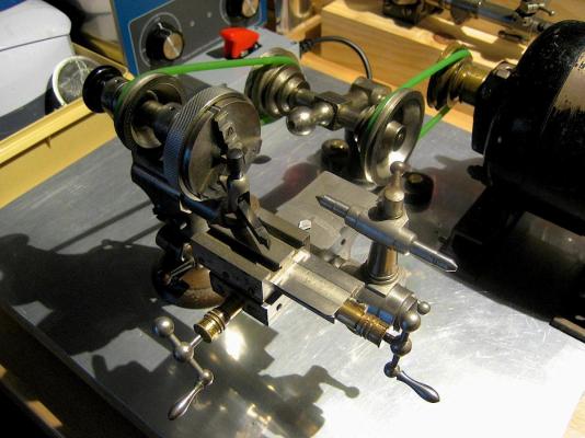

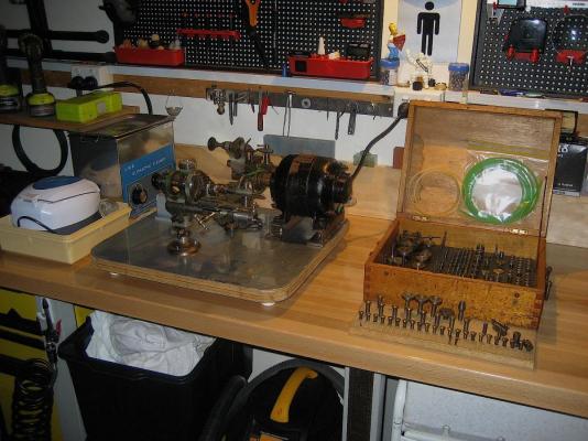

I was in the same boat as you a while ago and couldn't justfiy a new setup purely for a hobby.
I kept my eyes open on eBay and markets etc and saw many watchmaker's lathes in the USA and Britain but couldn't swallow the freight costs. The one day I saw a 6mm Lorch and a vintage cleaning machine local to me. I won the items for AUD$192 and picked them up next day.
The lathe had no motor or belts and was very dirty. All of the collets were just in a cardboard box and there weren't many of them. Anyway, I thought it was a start and got it all cleaned and going with a sewing machine motor.
Then just recently, I saw another "lathe and parts" not far from me (30 Minute drive). I was lucky to get it for $300 as it was a boxed Lorch 8MM lathe, a big box of collets, chucks etc and a also with a huge motor.
After getting home and sorting the mess out, I found that 90% of the parts were 6mm! Woo hoo, now I have a full set of 6mm parts.
I used the 6mm as a basis for a new set up and mounted it all on a lump of aluminium clad marine ply. I keep the 8mm handy and can switch heads in about five minutes if I need to use bigger chucks etc.
So don't give up, just keep looking and I'm sure that something will come your way.
And to keep you interested, here's some snaps of what I ended up with.
Here's an overview
post-1141-0-09996500-1434856540_thumb.jp
And a few more shots for you.
This is my lathe system, the 6mm is mounted, I used a "missile" switch as it's very easy to shut off quickly if needed. The 8mm is on a block of wood and it can also hold components I'm not using on the 6mm.
post-1141-0-69306900-1434856852_thumb.jp
In the box are all of the 6mm bits, and the board in front has some 8mm bits and the left over 6mm stuff, mainly a few collets.
post-1141-0-93874500-1434856994_thumb.jp
And finally, a close up shot showing mainly the cross slide.
post-1141-0-20230700-1434857099_thumb.jp
