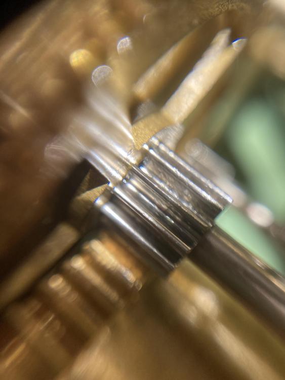

A friend has asked me to have a look at this clock for him. It has been to the clock repairer twice now but still has the same problem. It will run for a short time and then eventually it stops. I haven't done much except take it out of the case and observe what is going on. What I can see is, it will run fine and then the sub dial seconds hand stutters, sometimes it continues to run but often stops. It looks to me as if the movement is soaked in oil.  Watching the balance and escape wheel closely I can see it hesitate sometimes and occasionally looks as if it is going to go backwards, albeit very slightly, before it picks up again and carries on. I am of a mind that it is the oil gumming it up. If it was my own clock I would have no qualms about starting to strip it down. But it is a nice clock and they seem to fetch decent money so I don't want to harm it. Could I get away with removing the balance and escapement, cleaning the rest as best I can and then cleaning the balance etc before putting it back in. Applying lube where necessary of course. Or if it is thought best to strip the whole thing down, I might proceed with some guidance from you knowledgeable chaps. I'll add a couple of pics and a video of it running, the problem is hard to spot on the recording but if you look closely you might catch it.

Hi  loos a nice clock,  does it "stutter " on a regular basis and does it have a cycle (Ie)  every min  every 30 secs or the like. If so look for a bent tooth or teeth or even broken teeth. If its been away for repair that should not be the case. but a bent tooth/teeth maybe. If its covered in oil that will have to be addressed.  Let the movement down and remove the platform escapement. Dismantle the clock and reassemble without the spring reason bring to check the freedom of the train and for any tight spots which may be a bent pivot or faulty wheel. If everything checks out clean the movement and relubricate (Windles oil) and re check the train.  check the barrel and spring for being clean and lubricated. if all ok clean the platform and chesk the escate wheel pivots and teeth then lubricate with watch oil and re fit  paying attention to the depthing of the ecape pinion and the contrate wheel. once assembled put two or three turns on the spring and observe.    all the best.
Hi,  No it's very random, just been watching it again and it was more obvious to see. The escape wheel bouncing back and forwards a couple of times and then carrying on for a beat or two then bouncing again then runs fine for a while, repeat. It looks like the barrel might be the source of the oil. I have no way to strip that down though.
By the looks of the movement it is nothing to do with oil. What you have described sounds to me to be the depth of the teeth of the contrite wheel engaging to the escape wheel, you need to check the teeth. If the depth of engagement is correct you should be able to have the clock working no matter what the angle of the movement, it should even work up side down. You have an adjusting end shake screw, check the end that is contact with the contrite pivot make sure it is smooth and clean and it has a drop of oil on the tip that touches the adjusting screw. You might even need to adjust the position of the complete platform. Look for screw marks on the platform and see if that are in line with the platform screws. The whole platform should be looked at for wear I can't see if the escape wheel is jeweled or not, if not jeweled look at the pivots. The same goes for the pallets. Are the pallet stones tight and not loose.

Not a fully jeweled platform. The bottom escape wheel hole tends to wear more then the top one. Oil the complete platform with pocket watch oil. The hairspring doesn't look right it looks one sided.

The platform is out now. Straight away I could see something clinging to the oil in the teeth of the contrite wheel. You can see it in the photo on the head of the needle. There is a coating of oil on almost everything with fibres stuck in it. It needs a good clean but I'll have to work around the barrel as unfortunately I don't have anyway of stripping it and reassembling. Shall I carefully take the platform apart now?
Some fool has tried to close the hole with a staking punch why those horrid file marks beats me. I would check the pivot for wear making sure it is in good condition it needs to be smooth and should be burnished, re-bush the hole because of what has been done no way is that hole the same size as the pivot right through the hole. I cannot judge the depth of those file marks but be careful if you try to remove them you do not want to remove very much martial as it will cause to much end shake. If the clock is not yours I would take photos of the bad work and show them to the owner and explain it wasn't you.
Hi Dave   Iam at a loss as to why some one has been at it with a file, Has it been Bushed and re drilled and filed or as OH suggested the hole closed  because if so its a bloody mess of a job ? can you post a few more pics of the pallet/escape wheel bridge, side on and a close up from top and bottom.  The only recourse is as OH said cleaning up and re bushing. But before that I would suggest you do as OH mentioned and photograph it and show it to the owner ans seek his judgement on what to do next.  All the best

cHi Dave  Not bushed but punched, the file marks are probably because the metal was raised. Definitley needs re bushing now and the cock cleaning up abit.  I should take OH's advice and take it back to the butcher and get him to do a proper job. I wouldent do that to a cheap alarm clock       cheers
