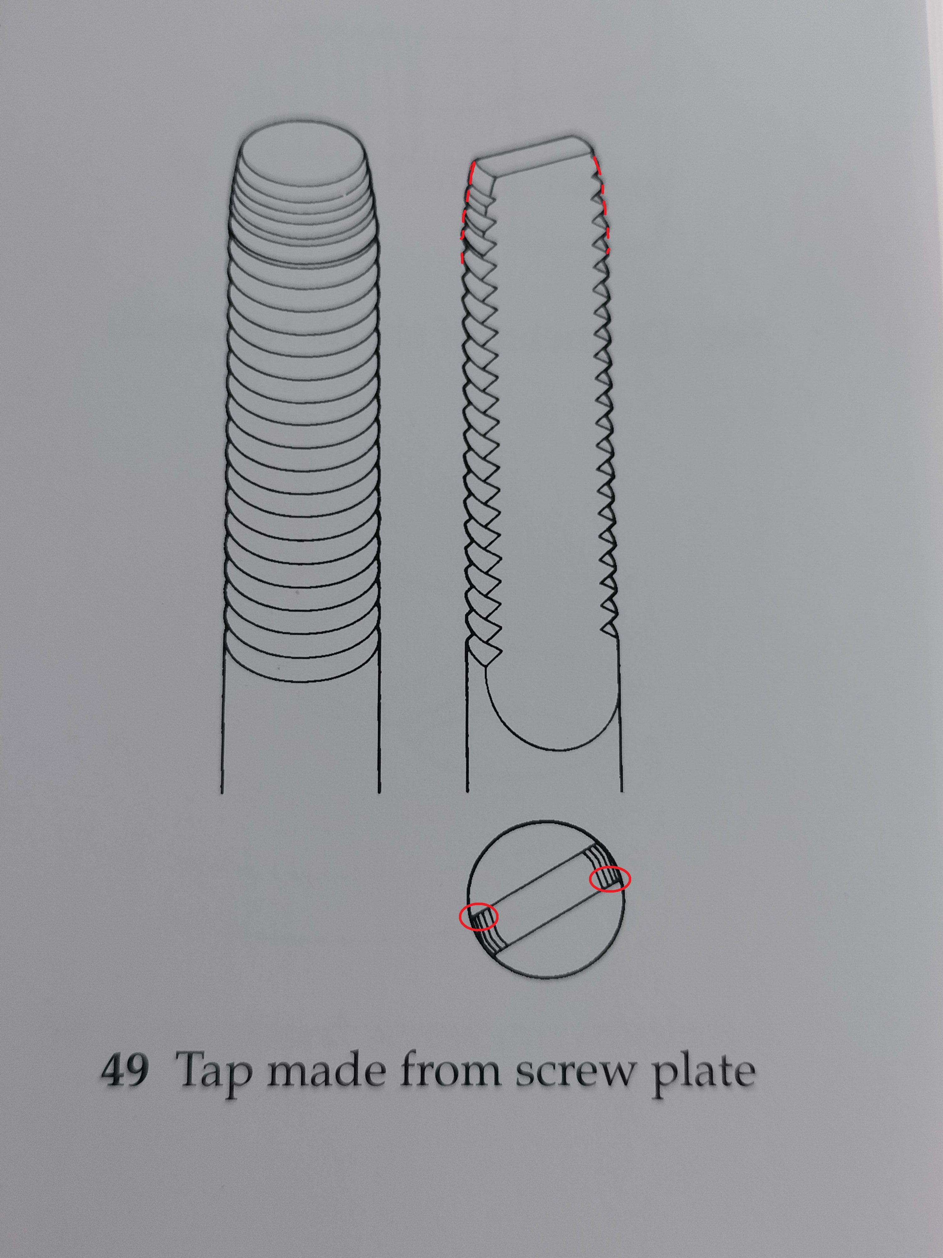

To make the tap turn the shaft to be threaded with a tapered end as described earlier. Start the plate and measure the first full thread as a guide to the correct diameter. The shaft can now be reduced ready for threading, but the extra reduction will need to be increased to allow for the action of the plate which will not cut freely as a modern die. The reduction can be determined by experience with the plate and the material to be threaded. In forming the thread the plate will partly cut and partly force the metal into shape. Use oil-hardening steel. The readily available silver steel is quite unsuited for threading with screw plates because of its resistance to deformation.
Keep the shaft well lubricated and withdraw it each full turn to avoid the tearing of the thread. It will be useful to keep a firm pressure against the back of the plate to help its advancement. Failure to do so will result in poor threads of the form illustrated in Fig 47. Too much pressure will tear the thread, Here again experience is the only guide to success. After the thread is formed with the cutting hole, the duplicate thread in the plate can be used without pressure to complete the final form of the thread.
File two flats to bring the thread to a flat taper leaving the end approximately one-third of the diameter as shown in Fig 49. Now reduce the width at the end for the starting threads, and finally relieve the back edge of the starting threads only. Harden the tap in oil temper to a pale-yellow colour. After hardening dress the two flats with a sharp oilstone slip to remove the burr from the file and ensure a keen edge. The tap is now ready for use but it should be noted that the thread of the tap is the same size as the thread in the screw plate and consequently a screw made with the plate will not freely enter a hole made by the tap. This can be rectified by polishing the screw thread.
These plates are particularly useful for replacing screws in old watches. The pitch of the diameter of the required thread in the plate can be ascertained by screwing a piece of hard wood into the hole."
Could someone please enlighten me what does this mean in the text: "and finally relieve the back edge of the starting threads only." What is the back edge oh the thread and what does relieve mean? Probably it does not help that I am not native English speaker? I want to follow this procedure and make a tap.
Seen in section a thread is an isoscele triangle. The back edge is the one of the two equal sides, the one that faces the head of the screw. The front in the one that meets the female thread first when fitting.
Relieveng is removing material on a face that does not directly cuts, on a cutting tool.
Thank you. I think I get it now. So relieving our tap this way would help us to form the thread with less force at the beginning minimizing the risk to snap it as the length of the cutting edge would be reduced and the removed material could leave more easily? I marked the back edge and the relieved section with red. Could you please confirm? I dont want to mislead somebody.

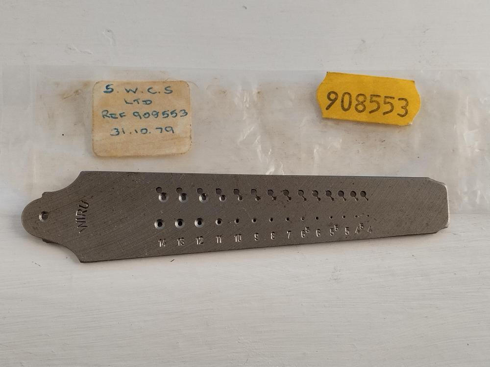

I'd like to make and replace screws, and re-tap holes with this method and this is my screw plat in mint condition:
How do I get oil-hardening steel is another question. I got a bunch of blue pivot steel.
Yes, the first few threads will be tapered but also grind a little from the trailing edge of the thread to the cutting edge, exactly what you've emphasized in the pic above.
The blue steel you have isn't useful for making taps, it will just kill your screwplate. The standard steel in the U.S. would be O1, which is available from multiple suppliers and costs very little. I'm sure you can find it in the U.K. but probably minus the "cheap as chips" aspect. I'm sure there are suppliers to model engineers who carry "silver steel", which is a catch-all term for hardenable steel.
Foreword, sorry I never made a tap, but I think you understood correctly.
Before I didn't even realize that there are edges on tap threads (it's a cutting tap not a forming one) so I wrote face instead, but in fact relieving the whole "back face" even for a single thread be not just difficult but wrong.

What is the end of the starting threads?
The point where threading starts, or ends if you consider that starts from the head.
And what is the width of it?
I think he means diameter. In other words make the tip tapered
The plate won't stay mint for long if you try to thread pivot steel with it. If you bought from Cousins that is actually Indian spring steel, very hard and difficult to machine. I recommend that you use standard tap and dies, even if you want to make your own tap. Start getting the feeling of what is what by experimenting on brass first, then bronze maybe, then leaded steel (which can be hardened to an extent), then O2, tool steel or the like. You're in the UK and can get all these materials easily.

On 1/13/2022 at 11:51 AM, luiazazrambo said:
"reduce the width at the end for the starting threads".
I agree with jdm. All he's talking about here (I think) is putting the taper on the end of the tap. In the diagram you marked in red, you can see the crests of the first four threads have been removed, increasingly towards the tip of the tool. For width he could also have said diameter. It's important, so that the cutting / forming happens in small steps and the tap finds the centre of the hole.
I would say I agree but we start with a tapered shaft already, does he mean that we even have to remove more material (reducing the width / diamater), and removing the back edge of those starting threads is the releaving.
Yes, it has to be the case as the original taper made for the shaft was only made to find the first full thread so to get the correct diameter of the shaft. You have to turn your shaft to the size of the first full thread if I am correct. I think I now understand the full process.
