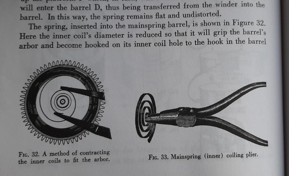

Looking in 'The Watch Repairer's Manual' by Henry B Fried, the way to adjust the inner coil end :
There's no mention of annealing. Though he does say that the outer end of the spring does need heating if it needs folding  over.
I've tried the method shown in Fig 32. It works if the spring is 'soft' and pliable, but not if it is more brittle and 'springy' - you need to bend it tighter than the arbor diameter to get it to keep it's shape.
It's also difficult not to scratch the barrel.
It would be interesting to hear from someone who's been to watchmaking school to hear if this was covered.
