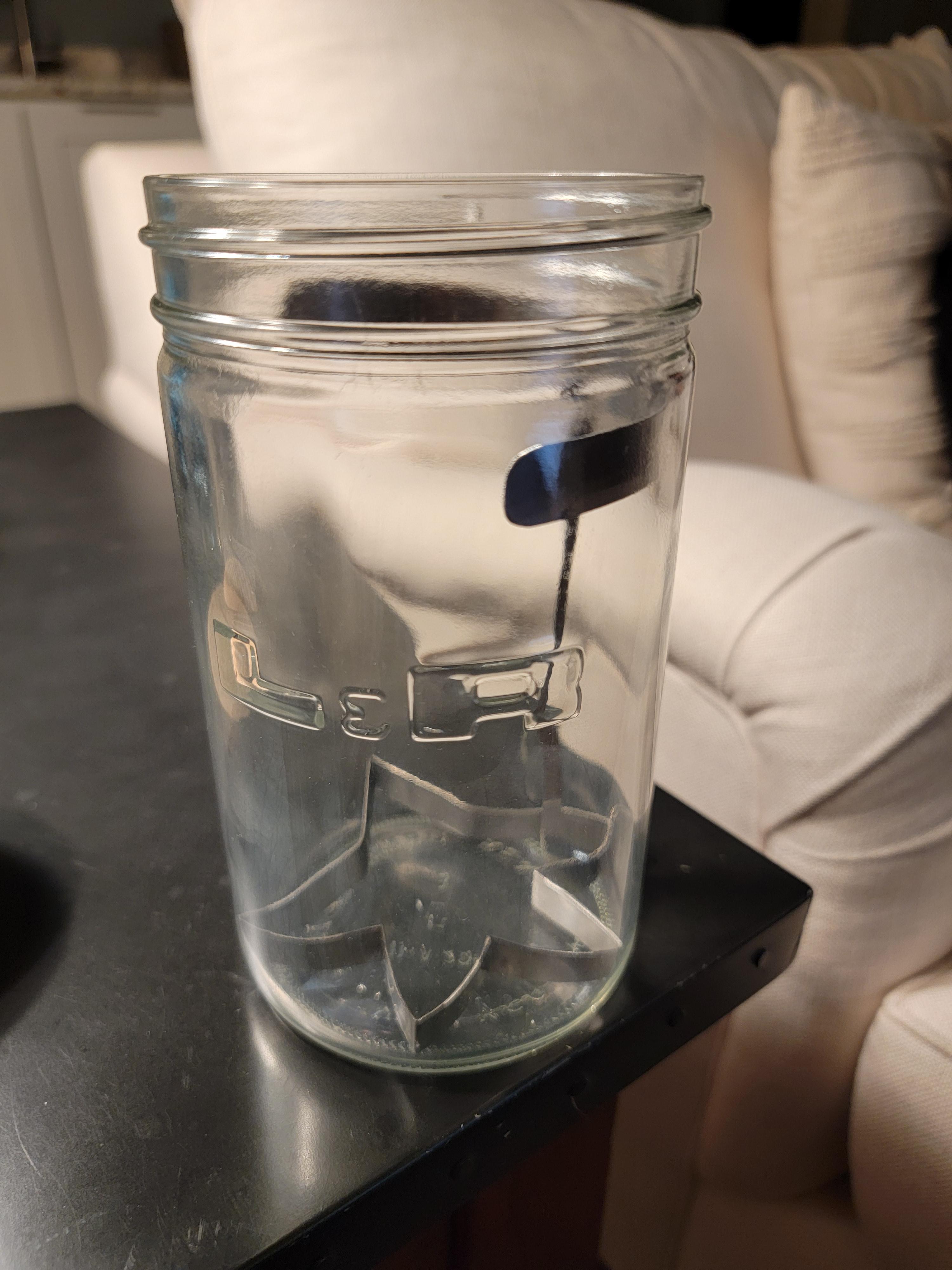

I know this has been discussed a bit but I acquired a mastermatic a while ago on ebay and am ready to clean some parts.  Like others, I'd like to find screw-on lids to minimize fumes and spills that apparently they're hard to find.  I did a road trip to walmart but the ball-type lids don't work.
Has anybody found a source for them?  Somewhere in this thread I believe there was a guy so printed some lids and I may find that post and send him a PM.  Getting into the 3D hobby might be fun but I'm not sure I want to jump into a new rabbit hole.
