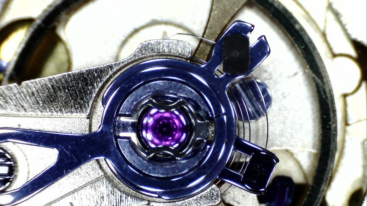

I took these pictures with a cheap USB microscope, which is not much more than a toy really, but there seems to be a definite offset to the hairspring.
I won't be able to do much until the weekend now, but I'd appreciate your continued advice.

The hairspring is definitely off to one side when the balance is fitted, but it is difficult to see and next to impossible to adjust due to the bunching happening under the balance cock. I'll refit it and try to take a photo.
I have made a habbit of putting only the cock and balance assembly back on the mainplate as soon as I take the movement apart, this would give me max access to the coil, I can check if its level, concentric, breaths evenly , check the shakes , etc   and make any adjustment needed right then.  You would have good access from the sides of the balance to observe the coil when oscilating and max space to make adjustment. Thats doesn't mean minor readjustment wont be necessary following reassembly.
I am sure you like this idea once you give it a try and see the results.

I really have no idea, I imagined that it was a proprietary name that ETA gave to this design.
Etachron refers to design of regulator arm and stud. You would easily adjust the width of slot hairspring threads through, which helps with isochronism.
Oops make that regulating pin.

Etachron is actually quite amusing t implies Swiss but the reality is it's Swiss and Japanese the toll the patent on one part of it. Which is why Seiko uses it in all of their watches along with the Swiss.
It's a really a beautiful system as it allows you to make a lot of hairspring adjustments without bending the hairspring. Like you can rotate the stud to move the position of the hairspring you can open up the regulator pins and rotate the stud and make sure they hairspring is absolutely in the center between your pins you don't have to do conventional bending of the hairspring. Then you can close the pins down which as somebody noted above improves isochronism. But if you don't grasp how all of this works you can bend the hairspring or maybe do something else bad.

Thank you, it was my understanding that the HS needs to sit between the pins of the regulator stud (although, not touching) throughout its arc of travel, but it is clear to see that turning the stud could act in a similar way to bending the HS. I'd rather follow best practice, whatever that may be in this circumstance, but don't mind a temporary fix that I can revisit once I am more competent.

Are you  set up to record close up vids of the coil when running at high amplitude, one from side view of the balance to show the coil when its running another from top view looking straigth down.

I can do an overhead view, not so easy in the case, but could perhaps de-case. I'll see what I can do...

From previous posts I believe that your hairspring is 95% or more near to perfect shape. It's normal for an hairspring not to "breath" perfectly even all around. In my experience that is not enough to cause rate fluctuations.

In the meantime, here's the video. The HS looks over to one side to me, how much difference this makes, I don't know.
