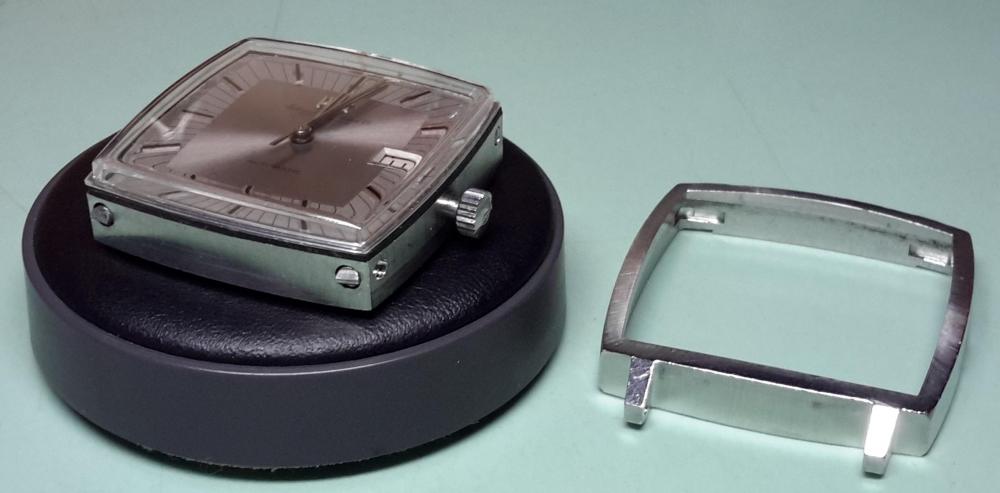

I purchased an IWC Ref. 1871. It seems to be a true project I am looking forward to work on.
But the first and probably major problem for me is to open the case. It is a square case body that has cut outs in the corners of the back. Each corner has a tiny bore, too.

I managed to open the case with tips from IWC specialists.
In short:
You have to push on the crystal to separate the case back containing the movement from the upper case.
In detail:
You do not need to push the pins back with screwdrivers. There is not enough space anyway, you need a lot of force and you end up damaging the case and the screwdriver. Furthermore, you will somehow push the case together instead of apart.
Expecting that everything will stick together since the last service is ages ago, I put a tiny amount of WD40 into the holes of the spring-loaded pins (see photo above), the space between the case parts and the slot between the crystal and the upper case. I let it soak for some time. Do not use too much WD40… this is watch making here.
Place the watch on its lugs on support blocks (e.g. wood blocks) to generate clearance for the case back to come out.
With your thumbs push gently on one side of the crystal at six or twelve o’clock roughly where the pins are located. Push on the stiffer crystal edge and not on the centre to avoid crystal damage. I could not find a potential replacement for the crystal so far.
The pins are chamfered and will be pushed back automatically from the force applied until the case back is separated from the other case part.
The watch has a split stem. To remove the movement from the case back, first remove the split stem with the crown.
I guess this workflow is the same for the case of the Zenith Respirator.
Happy watch opening!
