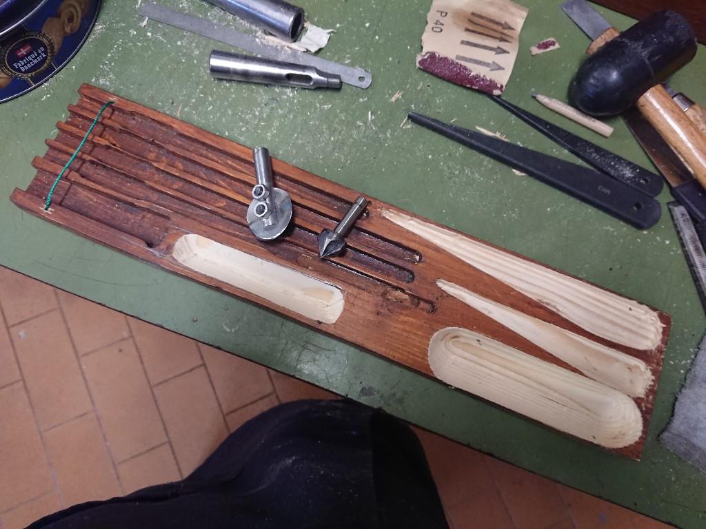

Reamers box and trays
A (relatively) cheap set of stray reamers was crying for shelter.
A suitable box was easy to get and refinish, then I made two trays from iroko wood on the milling column.
Could I have 3D printed these? Sure. Would I have then liked them? No.

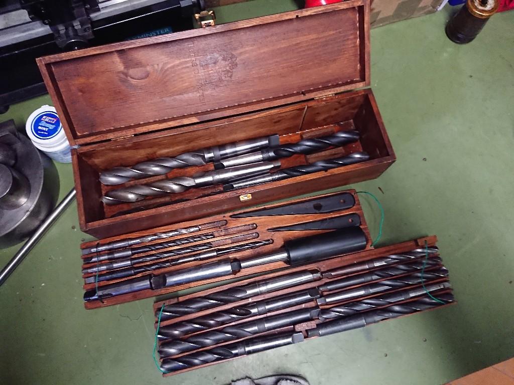

A bit of woodworking
The case (was a 1.5L wine bottle box) for the big drill bits which I got as part of a "lots more stuff" is finished. These have Morse taper shanks, so need to accommodate adapting sleeves, drifts and a chunky MT3 to 2 extension. For the latter I made a sort of round nose cutter to work the top tray, all slotting was done by eye on the milling machine.
Then two hands of wood stain conceal most mistakes and make everything look vintage good.
